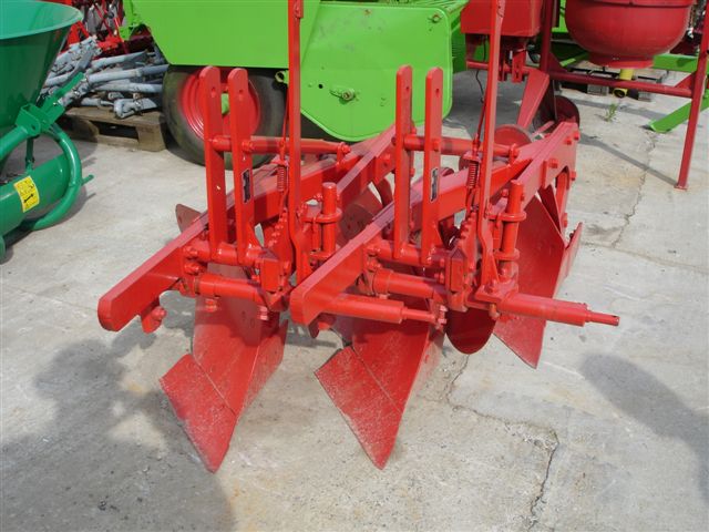

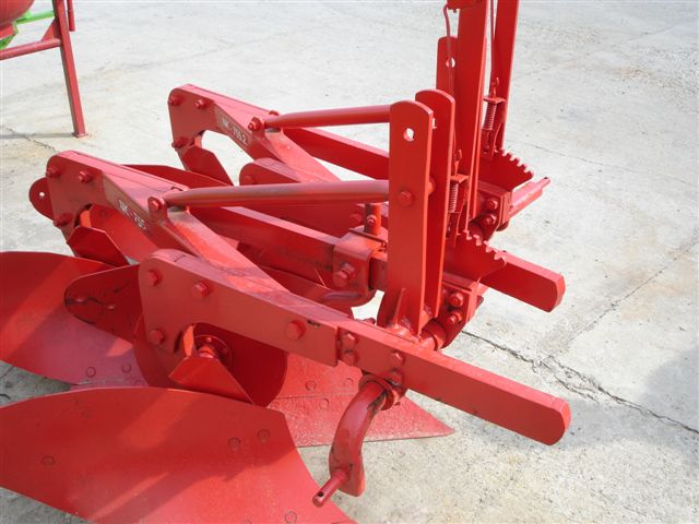

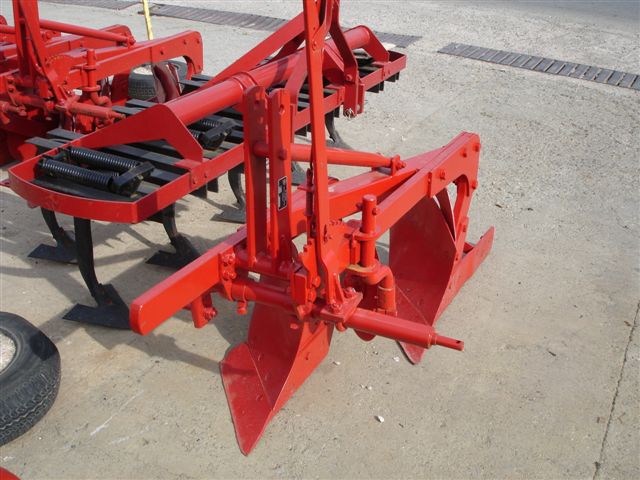

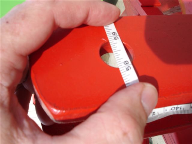

What follows are a series of photos of some 2 bottom plows I found in a little place just south of Pristina in Kosovo. Sorry the photos are a little funky, but I had about 5 minutes.
So, plow experts, what do you think?

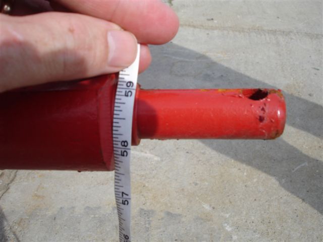

Are the CAT 1 plows? I did the best I could to get an accurate measurement.

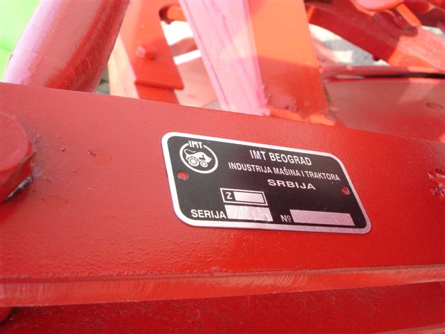

The make is IMT, I see almost all the Orange tractors around here are IMT. I know nothing more. The plows look pretty solid to me.

IMT is a Serbian company building MF licensed tractors. So probably the ploughs as well.
   / Kosovo Plows #5
The cat 1 pins are about 7/8 of an inch where the cat 2 are about 1 1/8 inch. So from what you are showing on your pics and the tape they are cat 1.

Those look like sturdy ploughs.
Maybe a tad over sized for carry on though!:D :D
   / Kosovo Plows #7

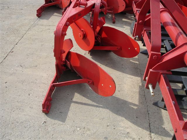

Looks like they're built like that ol' proverbial brick outhouse! (er something to that effect) As was mentioned, IMT builds tractors under license from Massey Ferguson, but those don't look like any Massey plows I've ever seen. They're a little tight with the clearance through the throat. They'd probably tend to plug in heavy sod or corn stalks, but those suckers sure ought not to ever bend or break. Stout doesn't do 'em justice. They may be built for use in rocky ground.
