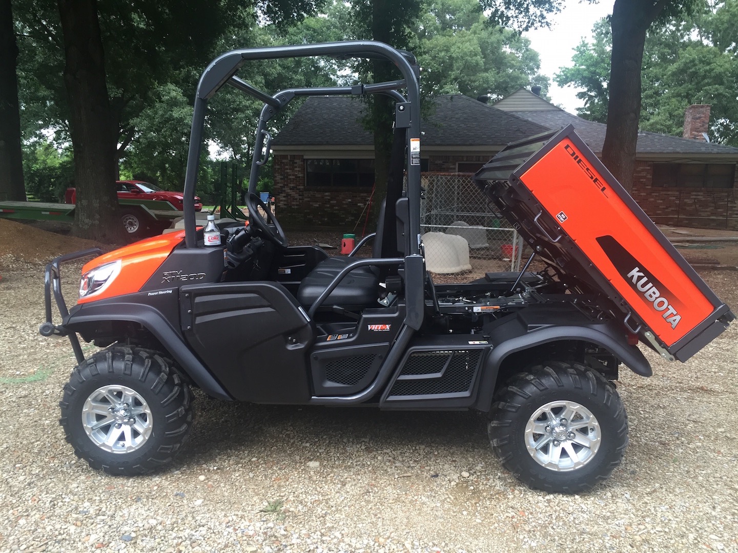

I bought my 1120D in June- I've got about 37 hours on it. I use it for everything and love it! It is the HANDIEST piece equipment on my place! I put a roof, windshield, front and rear worklights and rear view mirrors on mine....wife loves it too! kub31.jpgkub33.jpgkub32.jpg

Nice!!! Congrats!!!
