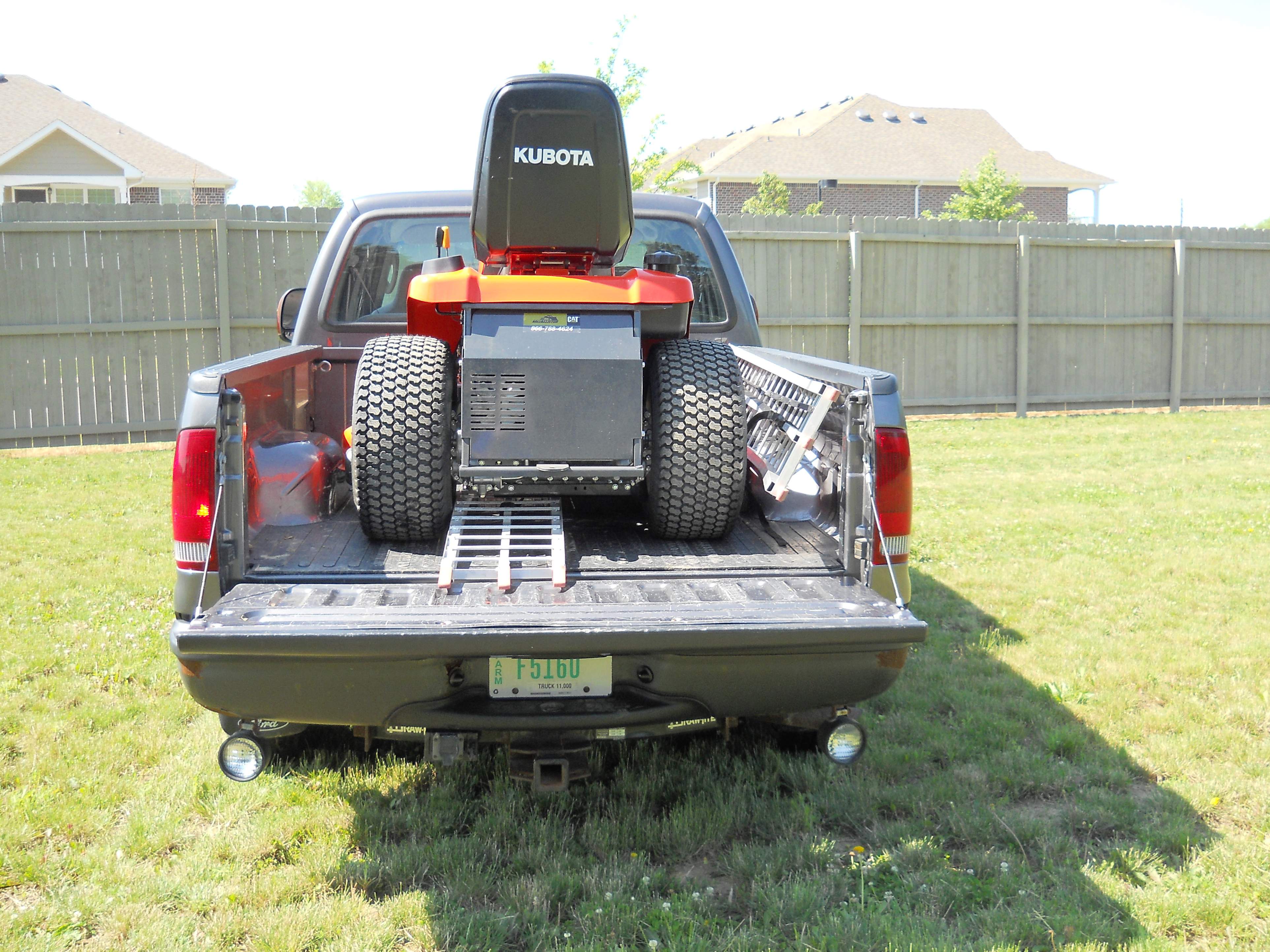

Not same tractor, but just a little smaller in size and weight. I got the 48" deck because; I already had a 72" mower on a larger tractor that does the big areas, have gates to go thru, and the 48" will fit in back of pick-up truck. Philip.
