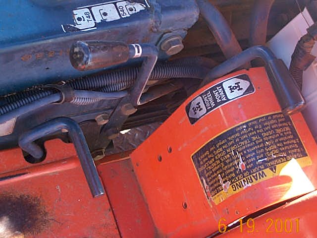

I purchased a bota 2150 from delta that was used to pull luggage carts. It had no control handles for pto, lift or sped (cruise on hydrostat). I've got everything except the pto handle to turn it off and on. Neither the parts gut at dealer or I can find where it goes. The computer shows it on left side near top of horzonal finned block, which puts the handle near your left heel. The problem is that exactly where it shows the pto control is where my 4x4 handle is that controls the 4x4. Any suggestions from any other 2150 owners? Where is your PTO cut on/off leaver? All help VERY much appreciated!!!!

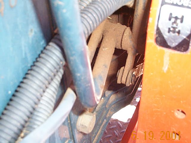

On my B2150 Hydostat, the 4wd lever and the PTO lever are attached at the same pivot point (bolt), with the 4wd lever on the outside (nearer the left wheel) and the PTO lever being closer to the hump. The PTO lever should have an arrow on it that matches up with a decal on hump to indicate the neutral position and the two speeds.
Hope this helps. If you need, I'll take a photo and post it later.

   / kubota 2150 pto #3
I decided to add pictures anyways. Here is picture 1 of 2.

Re: kubota 2150 pto (Picture #2)
And here is picture 2 of 2.

   / kubota 2150 pto
Kelvin
Thanks , boy do I owe you!!! Neither the parts guy or myself had a clue!! The tractor must have been ordered without all the handles as it was going to be used for towing only, so we were lost!! It only had the 4x4 and diferential lock handles. again THANKS A MILLION!!!! the pics were a big help!
