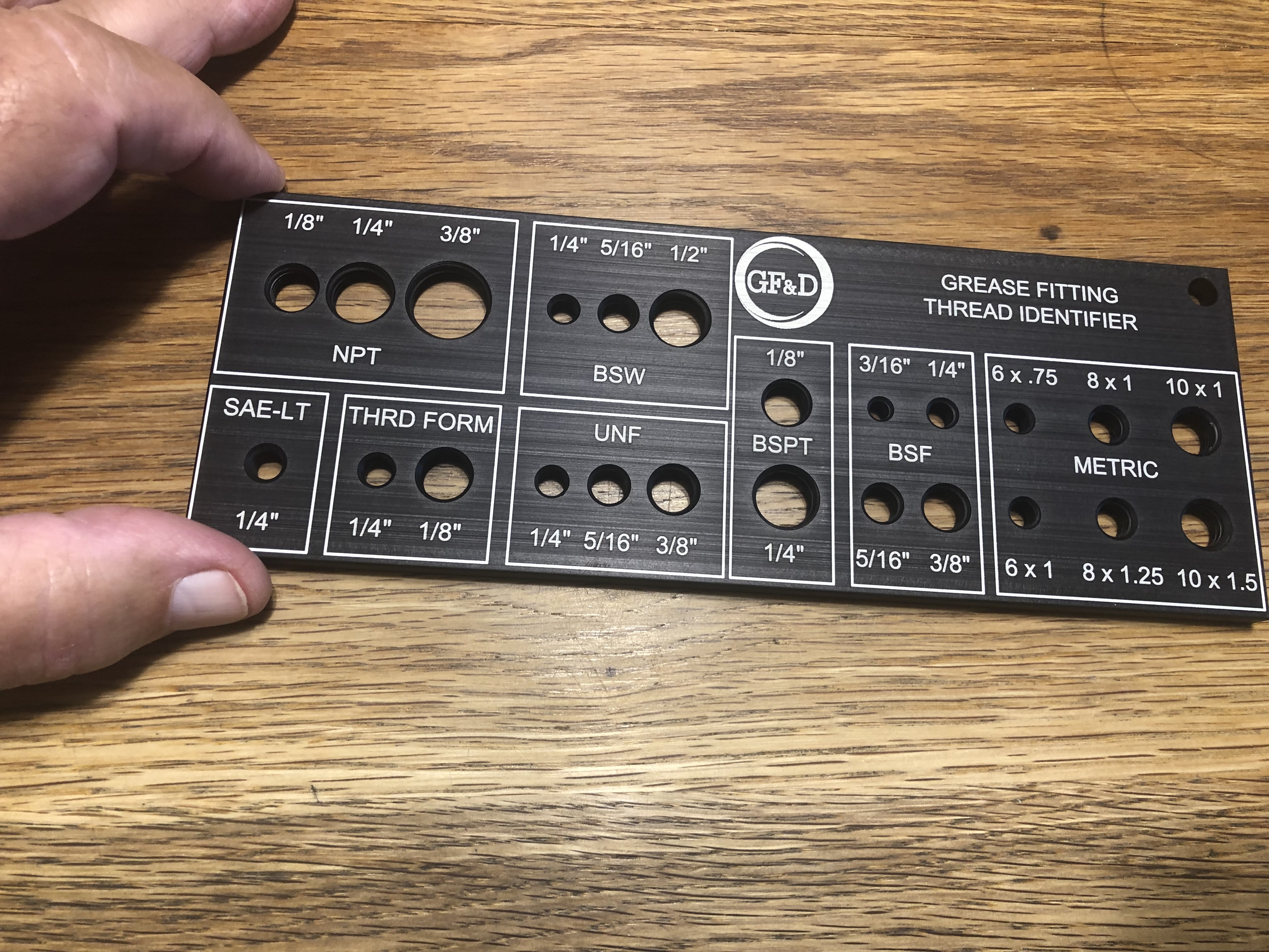

I first got flustered with used M5030 loader that was probably made in Canada. Not SAE so bought a metric assortment. They didn’t work either. They were 1/4” British taper threads. 1/8” SAE and 1/8” BTT are very close and the latter used in my current tractors. Have a nice assortment of metric fittings that I have yet to been able to use on the Kubota tractors. Some attachments are metric.
Bought four new pins for the M59 loader bucket linkage. Bought new zerks from dealer and they were BTT. Dealer doesn’t know what thread pitch they are. They go by part number.
Keeping track of three different thread pitches and multiple different sizes is a headache. Bought a thread pitch guide to help. A tractor with attachment could have three different types of fittings!
For a single tractor probably just better to get few extra fittings from dealer and label a pill bottle.
