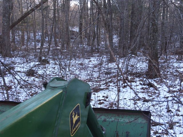

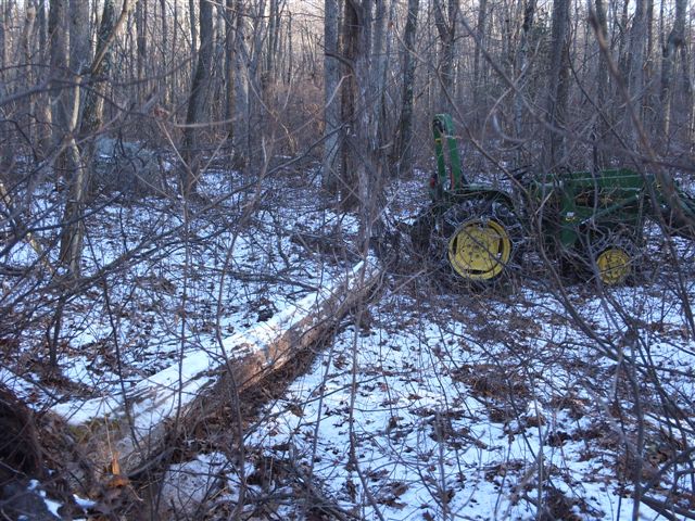

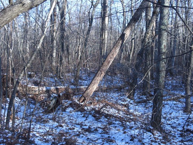

Adiredneck
If your woods are like this, then you've made a believer in me.

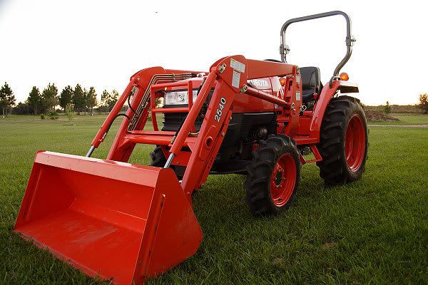

The 3400 I was interested in as it is about the same size as my 750 only has higher lift capabilities (capacitiy). It appears your running 11.2.s out back but their looks to be room for 12.4's. 3400's look to be one sweet tractor and strong for its size which attracted me to them in the first place. Tie rod placement turned me off for how I use my tractor. Nice looking loader Tex.
/ Kubota 3400 #10
Thanks, it's an Ansung loader. The bucket is built way better than a Kubota bucket.:D
