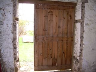

I stopped by my dealer this morning, measured half a dozen Grand L's, the rear R-4 tread width varied between 69 1/2" - 70". Guess I'll be remodeling that barn door. First tractor job will be digging a hole to bury some stone and morter. :D

For what it's worth, here's the possible tread dimensions for the L3540 rear tires:
12.4-24 R1 tire- 47.2", 51.2" 54.5" 58.3"
420/70-24 R4 tire- 52.2", 53.5", 57.7"
On the R4 tire add 18" to the tread dimensions to figure the overall width.
I don't know the width of the R1 tire. Perhaps the R1 would solve your width problem.

70.2" must be the magical number. That barn door is just going to have to give..... nothing a rotary hammer and a pair of goggles can't handle. :)

What about R1's? Seems like less work?

First Grand L I test drove had R1's, it had just rained and the grass was soft.....
I am a fast learner :) (i.e I fear my wifes wrath.....)
