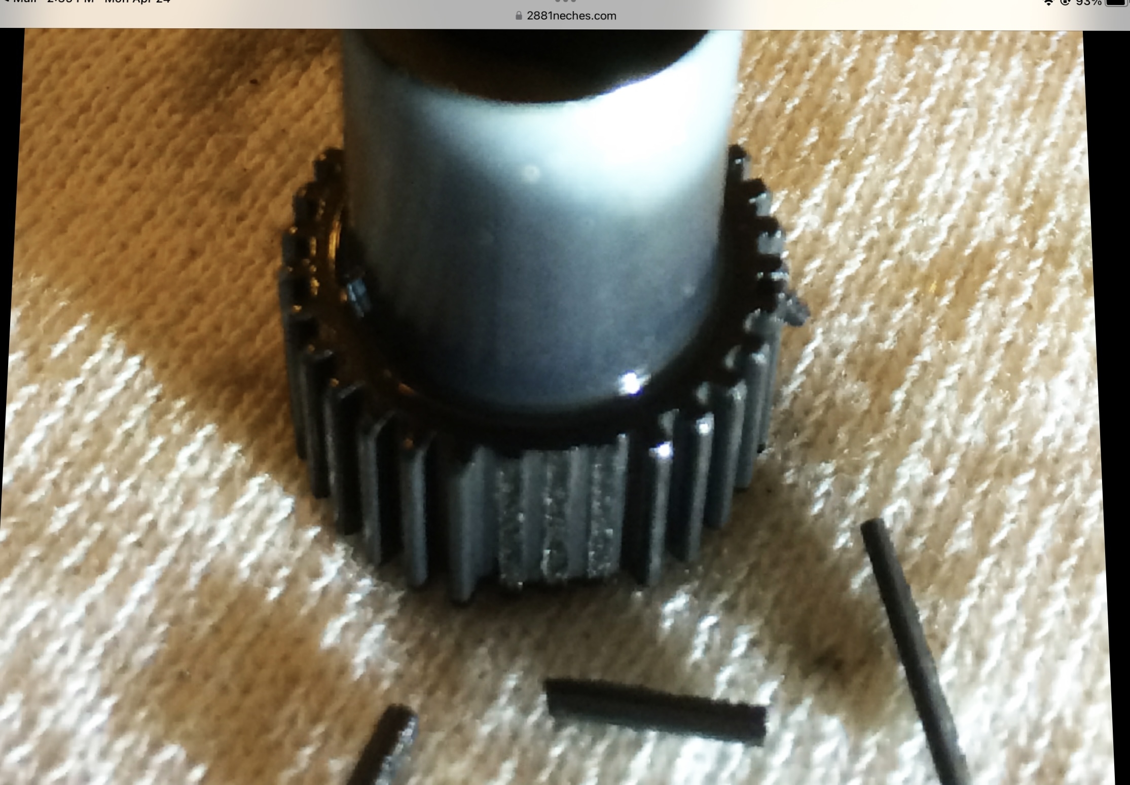

I just went through a two week period of waiting for parts for my injector pump, that was stressful! Thankfully everything went smoothly from getting parts to assembly!👍🏻 IMG_5321.jpeg
