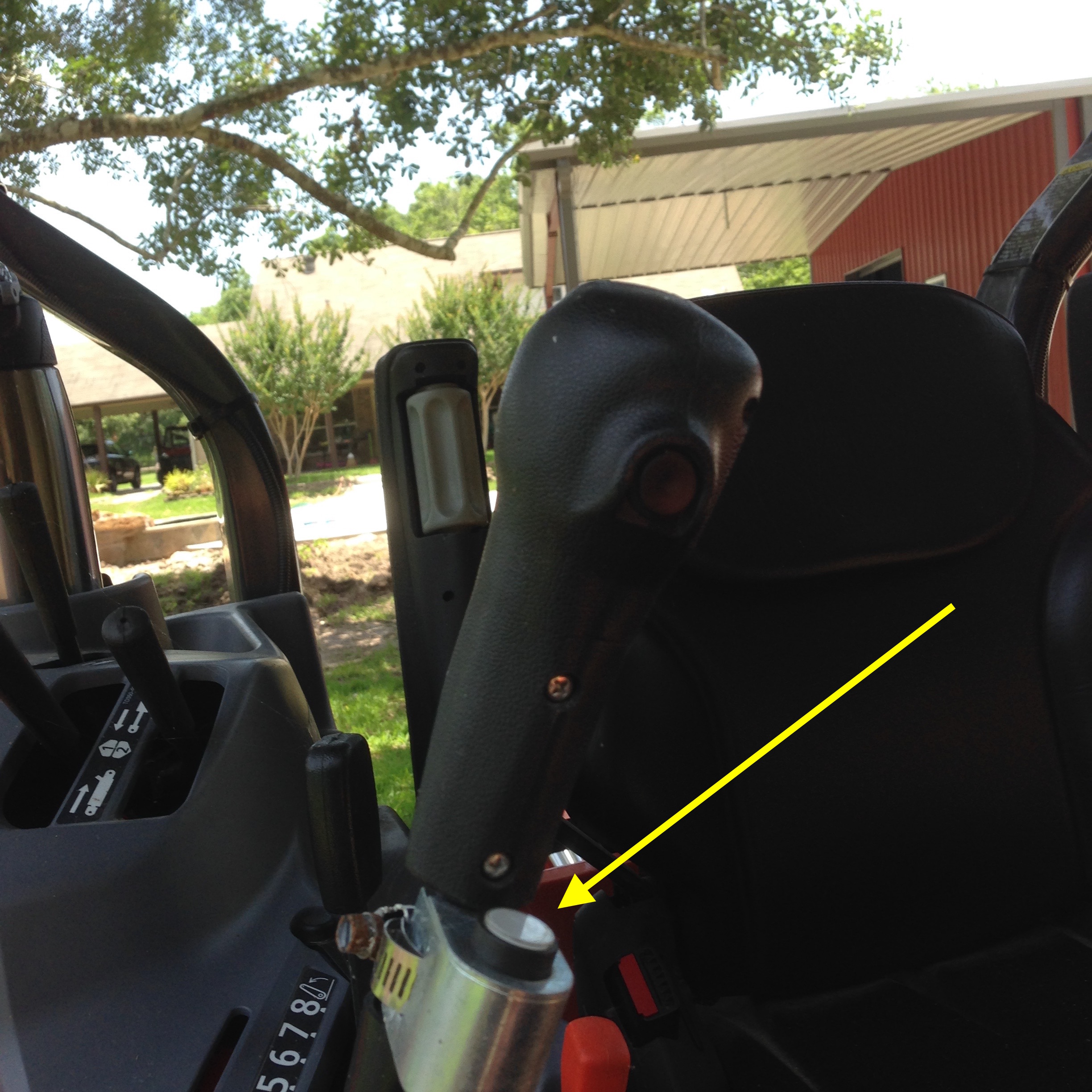

As a follow-up question, I have attached a picture of what appears to be a factory add-on switch with a "sweet" hose clamp connection for my 3rd function valve. Is the button supposed to light up when it is pushed down (depressed)? I ask because the button doesn't light up nor is my grapple working when trying to use the 3rd function so I'm wondering if the system is getting power. Any info would be greatly appreciated. Thank you.
I have a push button switch that is similar on my L45 for the 3rd function, it did light up when new but quit working within a year.

Mine lights up after 4 years.
I'm thinking you aren't getting power to your solenoids or joystick buttons.

That's what I'm thinking as well...I'm going to get it up to the dealer for that and a few other minor warranty issues. Fortunately it is a short country road drive to get there.
