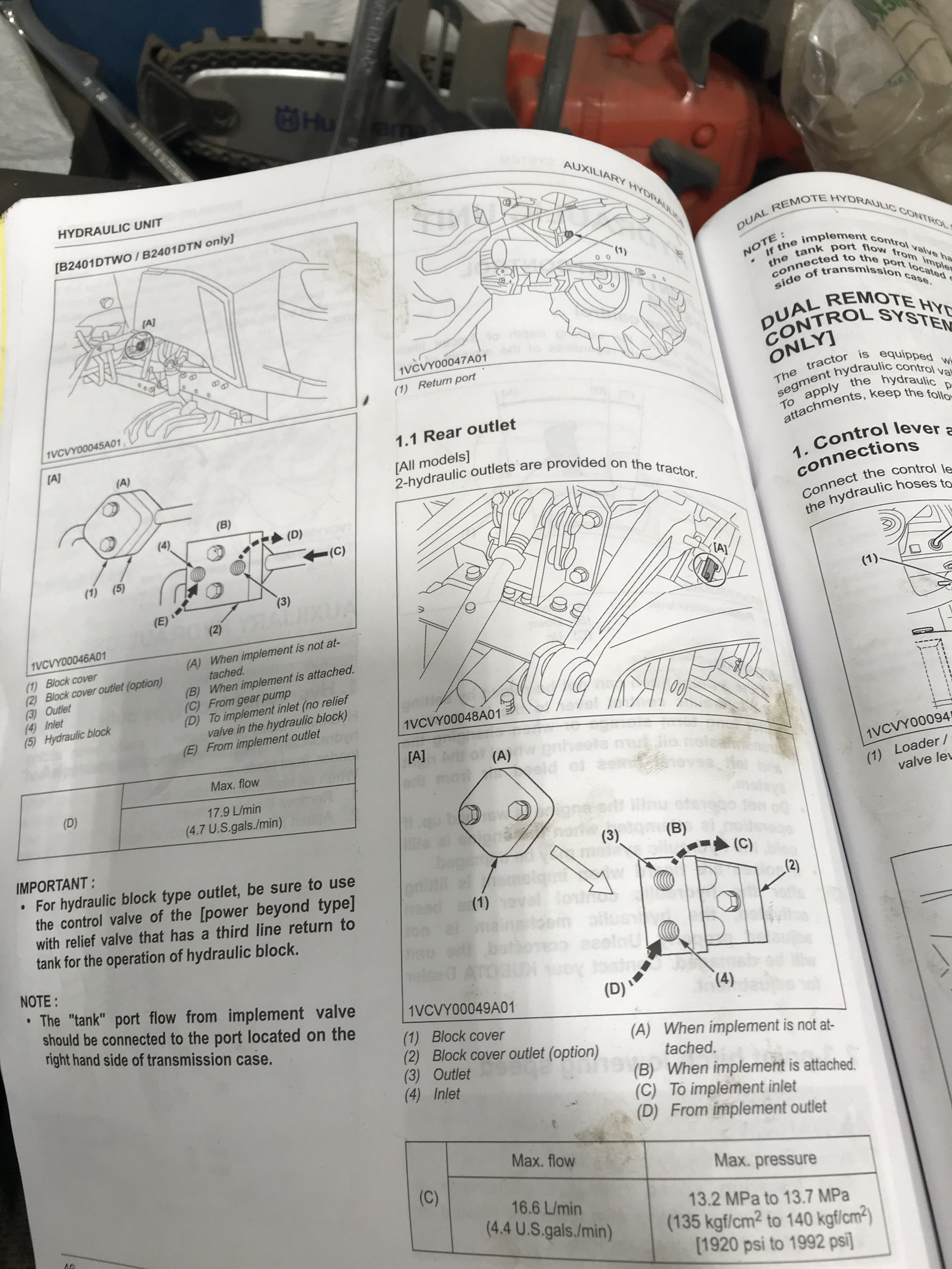

I agree with your thoughts. I should have said, “strains” the tractor rather than stalls. The dealer is going to be sending me the illustrated pages of the 3rd valve and I will post those once I receive.
I’m thinking possibly they did not hook up the lines correctly 3 years ago. I’ll keep you posted, thanks
   / Kubota 3rd valve, no oil
#12
Morning yes you are correct in the hose connecting issue and power beyond.
The dealership sent me the schematics and indeed they had it plumbed incorrectly to the valve. I should have spent the time to research more on the plumbing of the valve but there’s no markings on it indicating what’s what.
I switch around a couple hoses which the dealer put on and just like that the hydraulics are working. Thanks for that

Thanks for letting us know the solution to the problem.
