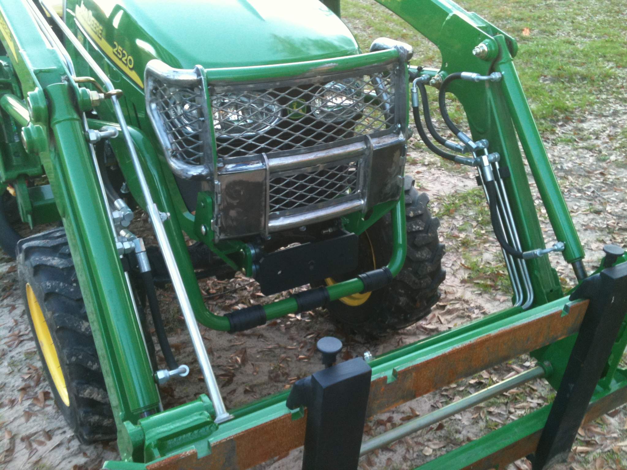

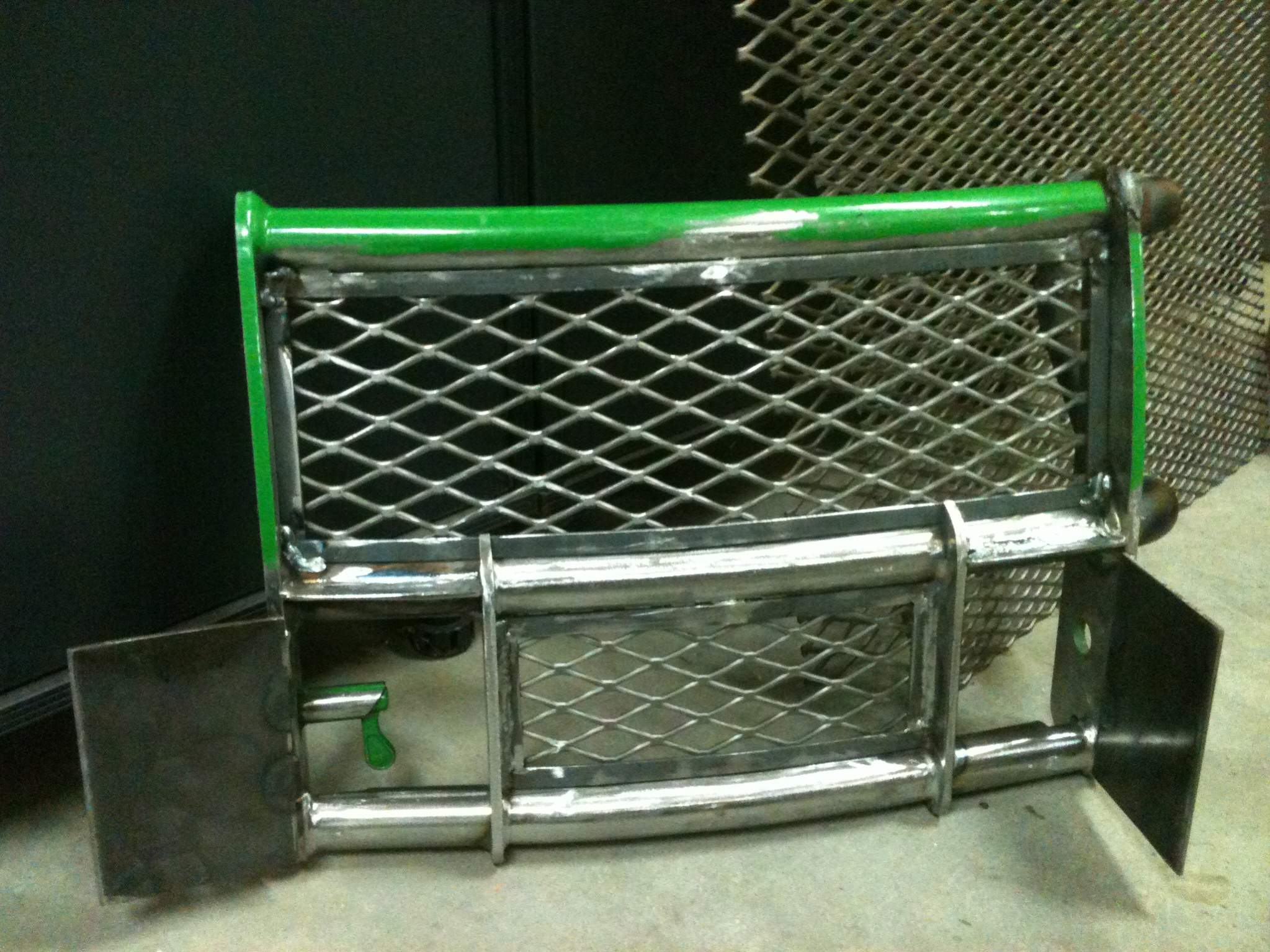

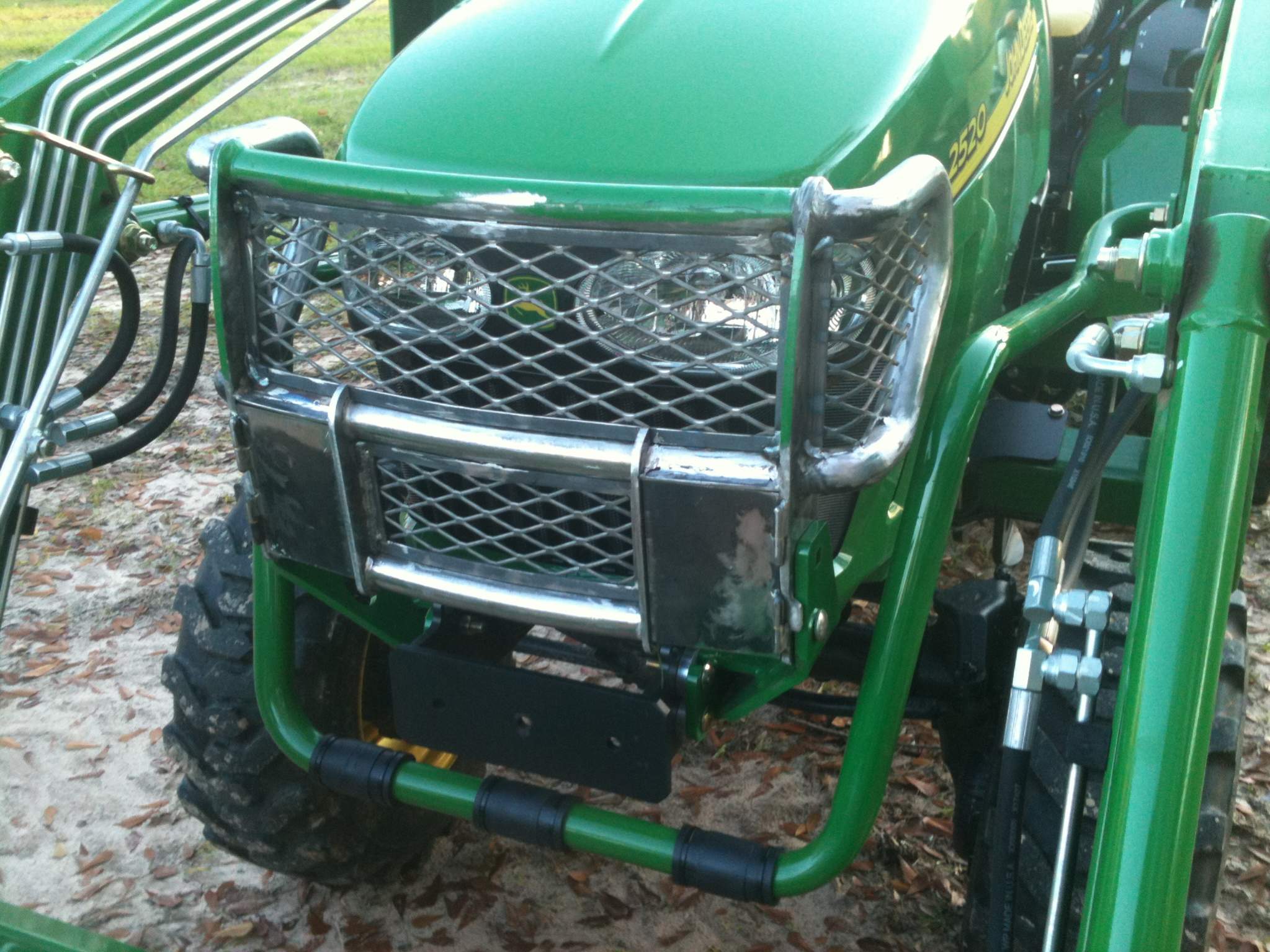

I know I'm fixing to embarrass myself but want to show a grill I'm customizing on my 2520. This project is from " your inspiration". I just wished you were closer to Texas for access to "your tools":laughing:. Here's a couple of pics.....please be gentle....I bruise easily:D
BTW...The 2520 grill comes with only 2 cross bars. I added the bottom bar and bent it to match the upper 2 bar radius's. The 2 doors are for access to the locking mechanism on the left and the right one will be for a 12v plug in for a winch. Its still a work in progress. I also added the side wings to mimic the larger deeres

Man oh man I got to tell you that I'm very impressed with that guard. I like the design and you gave it a nice custom look. I think your being a little hard on yourself here. That's a nice bit of work you've got done. Man it sure makes that front portion look well protected. Please show us photos of it when you get it completed. I bet you have also inspired others by showing your very cool project and thanks for sharing it. I just love that color as well. :)
Thank you for your kind words on my work. I really needed to do something about the seat in this new tractor. This winter I have to travel the machine a little farther to some new customers and I got tired of the seat bottoming out so I knew I had to do something about it.
I've always said that it's the ultimate compliment when someone says that I've inspired them so thank you for that.

Thanks!!....that means alot coming from THE man. I will definitely post up a pic when done. I'm smoothing the welds a little now,then I think I will send it out for powdercoating.
