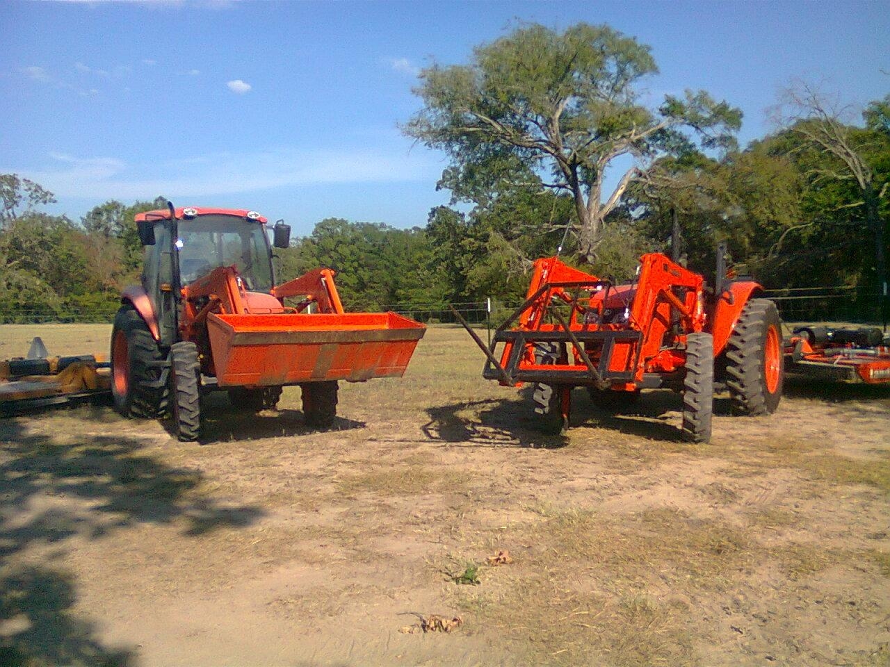

tractor2.JPG(2009) 7040-600+hrs/(2011)5040-200+hrs and we really use our two and havent had any kind of issues. You may consider going with the 12x12 hyd.shuttle,ours have the 8x8 sync.shuttle with no issues but you may get into situations were the 12x12 would give you a better gear. I dont have anything bad to say about the sync.shuttle kubota mechanic just claims they are better/tougher....
