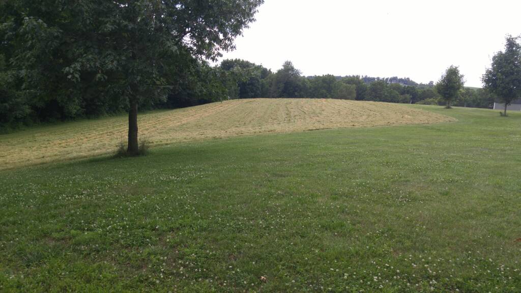

This is 2nd mowing of my field that was over 3' tall, using finish mower. Normally i keep it mowed down, but between all the rain, then getting pneumonia, it never got mowed till now. I'll mow it in another week and it will be down to lawn height. 0629191609a.jpeg
   / Kubota advice maybe not running right, maybe me, maybe disapointed #27
This is 2nd mowing of my field that was over 3' tall, using finish mower. Normally i keep it mowed down, but between all the rain, then getting pneumonia, it never got mowed till now. I'll mow it in another week and it will be down to lawn height.View attachment 610868
Doesn't mean its the right tool for the job.
Any finish mower I have ever owned struggles badly and you need to cut at a snails pace mowing 3' tall grass.
My brush mower or sickle bar mower cuts the same grass with ease.
   / Kubota advice maybe not running right, maybe me, maybe disapointed #28
That's why i cut it high first time, than lower. Finish mower chops it fine, rotary mower will drop it like hay, BTDT before.
