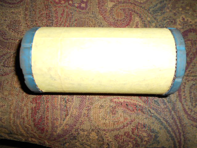

I replace the air filter every 100 hrs with new. Every 25 hrs it is wrapped with a cut to size shop vac filter paper. tractor filter.JPG When this is done the filter is as white as it was at new.
