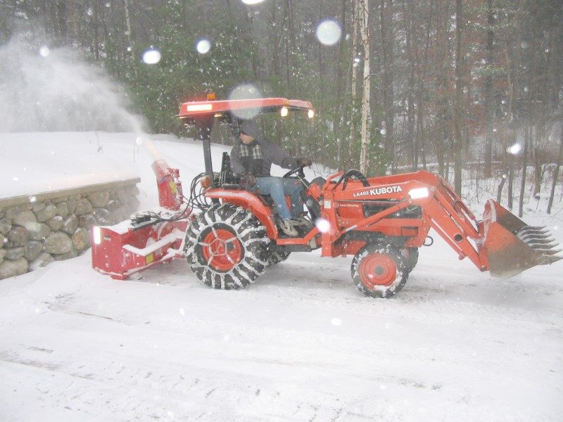

Your 4-link ladder chains look a little loose. I would consider making some adjustments with the tensioners. I went with 2-link ladder chains which not only give better traction with R4's but do less flopping.

Yes Mad, I used your nice tractor photo (nice set-up!) as my inspiration in getting my chains. I went with the v-bar chains as I thought the extra gnarly teeth would help with my forest work.
This was my first attempt at putting the chains on and I agree they are way too loose. I think my chains may be too long which will require me to remove a cross section or two of chain as suggested in the install guide at Tire Chains by Tirechains.com. Did you have to do that?

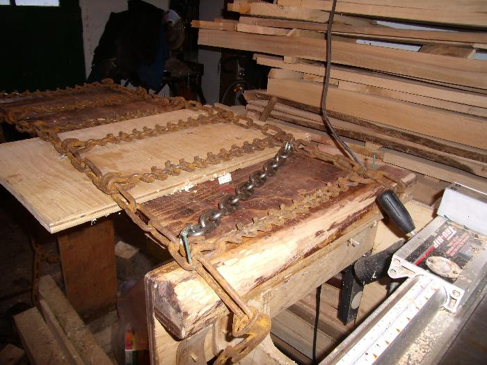

With vbar four link ladder chains consider running a diagonal chain section between each ladder. It will really smooth out the ride. I did this a few weeks ago and my back has been saying thanks ever since.:D

I actually had to remove one cross link on mine to make them fit. The overall length is a very tight fit which makes them sometimes difficult to put on. A few skinned knuckles and a few cuss words later they always fit right on.:D
