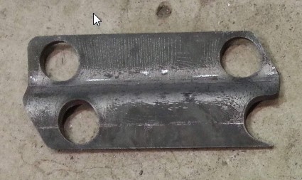

Feb 15, 2013 / Kubota B Series Quick Attach #11 B Buty Silver Member Joined Nov 15, 2012 Messages 152 Location Canton, GA Tractor Kubota L3200 jeep07 said: The U bend I did with a 1" pin and various bottom dies (scrap steel etc) in my press. Once bent I simply chucked the thing in a vise and got a big crescent wrench and pulled it back to bend it. Nothing precise but it worked . Click to expand... I'm sorry, I meant the plates with the two holes.
Feb 15, 2013 / Kubota B Series Quick Attach Thread Starter #12 OP J jeep07 New member Joined May 3, 2011 Messages 18 Location Kingsport, TN Tractor Husqavarna CZ1740, Case 1825 Skid and Kubota B2920 TLB Oh I just bent it partially in my brake and flipped over and bent it back parrallel for the offset. Tried to be consistent in both bends is about it.
