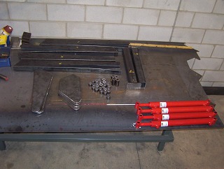

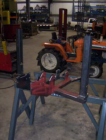

So far, the sub-frame is done,(3/16 2x3 and 2x2, 3/8 mounting plates) needs paint to complete. Now I'm working on the loader frame getting everything cut up and ready to weld. (3/16" cylinder mounts/gussts, 1/8" 2"x4" tube for the frame.) Going to be using 1.5" bore, 16" stroke cylinders. I'm planning to make a quick change for the bucket since I would like to have a set of forks for it too.

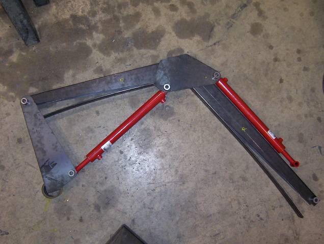

Here's what the arms will look like, not welded yet:

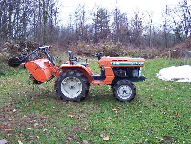

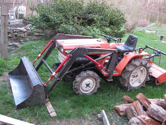

Update, hydraulics lines and bucket quick release left to do.

Phil R: is that one of those two-point tillers like some of the Yanmars?

Look good. The plasma sure came in handy here. Love the curves and angles that need little if any grinding to finish. I made my lift cylinders horizontal to help with the strain on the angle frame to the bucket. The longer cylinders gave an eight foot plus lift also. The loader will exceed the tractors requirements easily.

jas67, the tiller pivots on the frame and is raised by links connected to the lift arms.

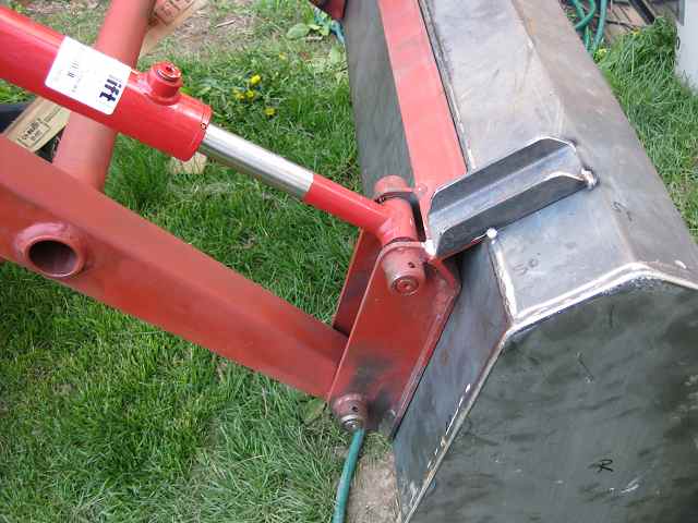

Here's a start of how I'm going to make the the quick attach for the bucket, there will be plates down the sides with pins to lock it in place at the bottom.

I like your quick hitch design. Is there more pics.

Sorry for the delay, was stumped for a while on what size of fittings to use on the hydraulics. I ended up making the quick release for a 1/2"pin instead of 3/4. Will make up some hardened pins for that. Started bending up the 3/8 line today, need to add the fittings and flare the ends yet. Also make some blocks to hold the line in place. One of the pics shows a 37 degree flaring tool I made up last night. Seems to work well.
