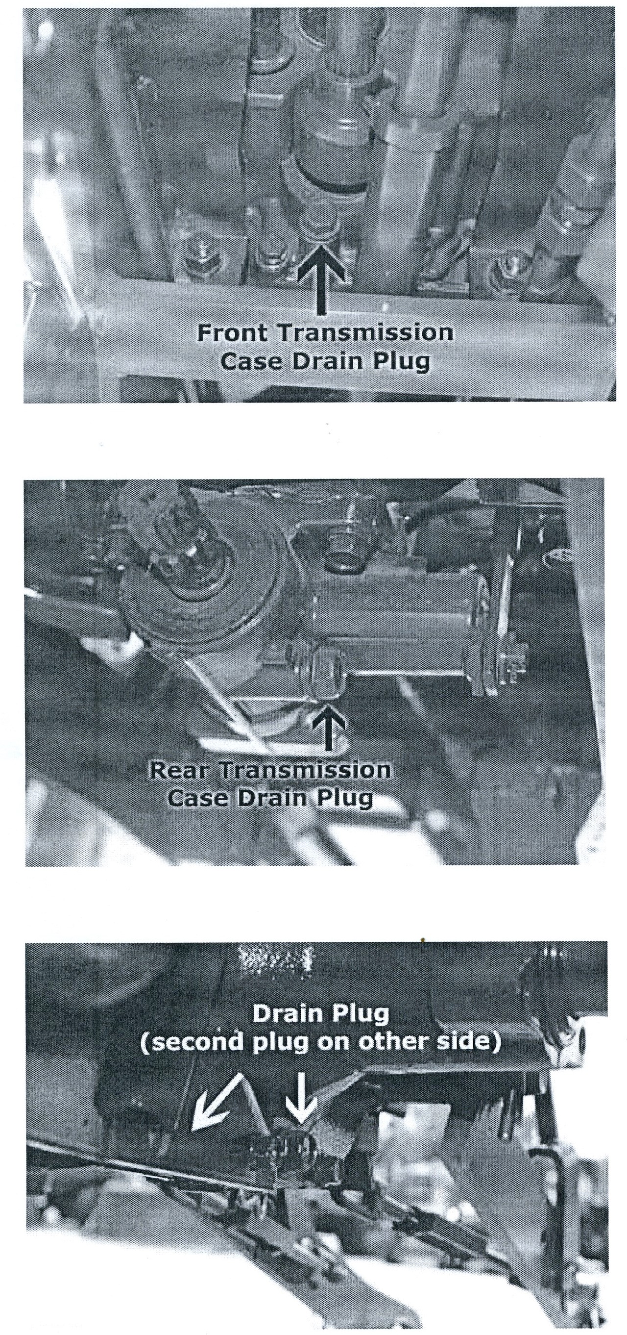

No problem. I'm the one that's confused. What can I say. My first Tractor and I've never rolled beneath one before. Is it me, or is it these photos? Doesn't this look like you're looking for four drain plugs?

Yes. Those are the four for the trans/hydraulic. I've been missing that front one all along on mine, LOL.
I only knew about the one on the mid PTO snub and the two bottom drains on the rear drive case.
And my manuals show the double sump engine oil pan with the two drains but my tractor only has a single sump on the engine with one drain.

Ok,,, there are four plugs and not three that I need to look for?

The top pic that says front case drain plug....I have never taken that one out on an oil change. I missed that one completely. But I just read on another forum that it has oil in it?
So I don't know yet. I'm not due for next oil change so I'm not taking it out, LOL.
For some reason I was thinking it was just a moisture drain like on an ATV CVT clutch, and not a fluid reservoir.
