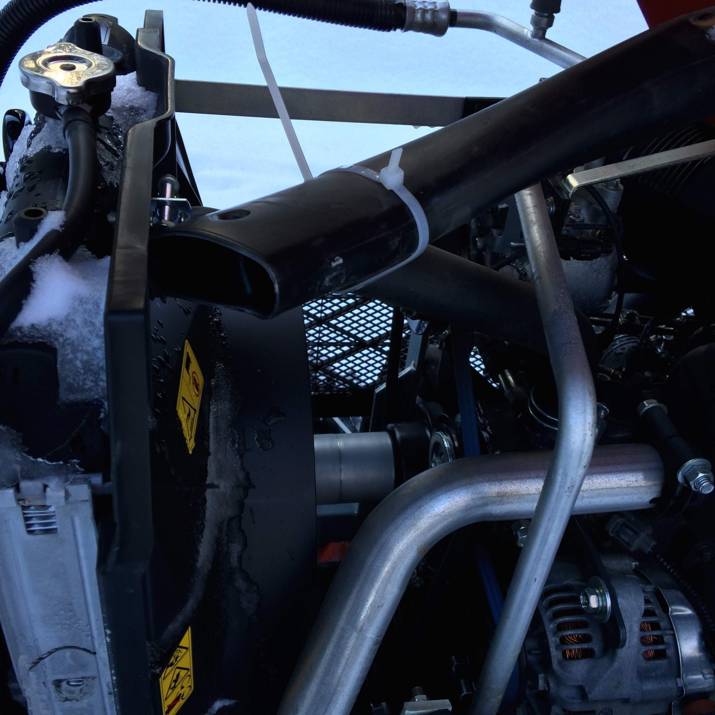

I moved the inlet to the intake snorkel from in front of the radiator shroud to behind it, and it immediately stopped the air filter plugging issue on my B2650. As others pointed out, it was only an issue in light dry snow with high wind.
   / Kubota B3350 tractor regeneration problems #102
DelSc....Thanks for the pic

Well I for one don't mind being prepared for the winter. Putting on storm doors and removing/draining hoses as well as other stuff(tire change-over to studded winter tires) is just part of getting ready up here. To that I'll add installing short downward facing air intake to tractor. Hopefully we won't have a repeat of that fine snow and cold weather of last winter!I appreciate the dealer giving me a heads up on the info he's learned.
In the end, maybe Kubota will sell a cold weather option package that includes a block heater, cold weather intake, and heater for fuel tank to reduce gelling!
