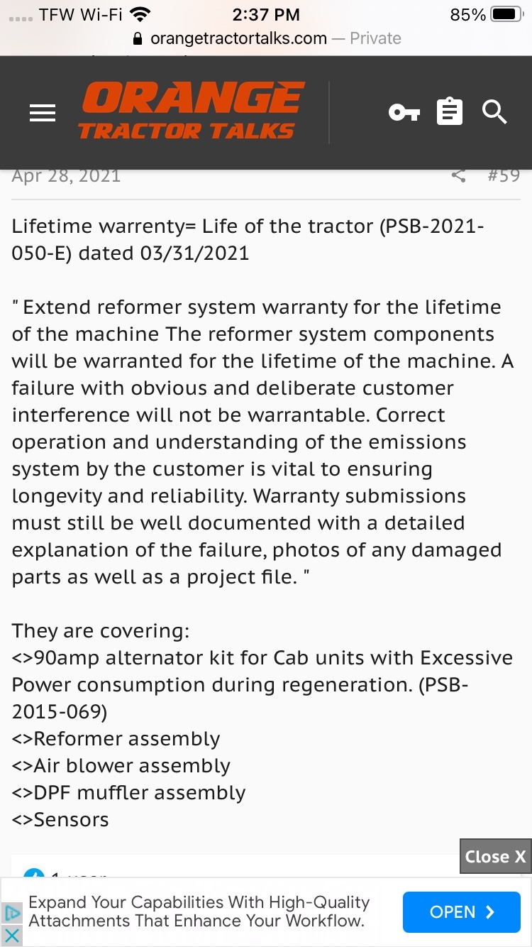

I thought someone posted a bulletin on the factory covering this known defect for either life or an extended time cant remember.
   / Kubota B3350 tractor regeneration problems #336
This is what I remembered. Might help might not.

Kubota recently extended the warranty on the B3350 reformer and related components (with provisions) for the life of the machine. Do not know Kubota's policy regarding those who have already paid for emissions system repairs but it would certainly be worth inquiring in order to find out.
