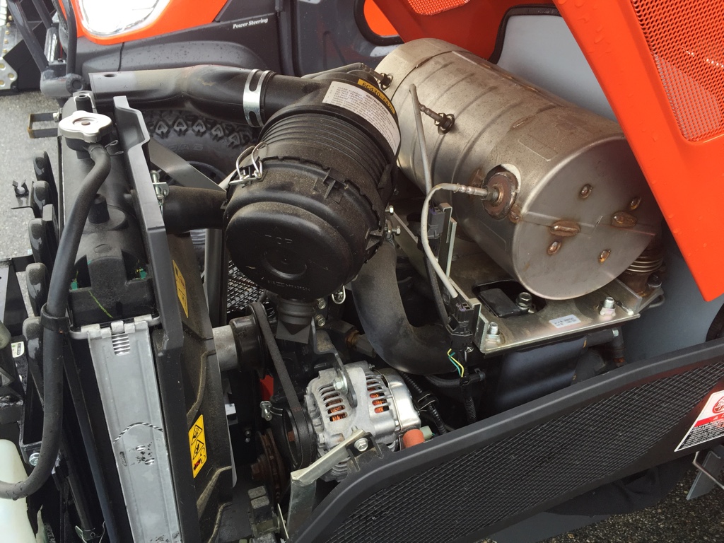

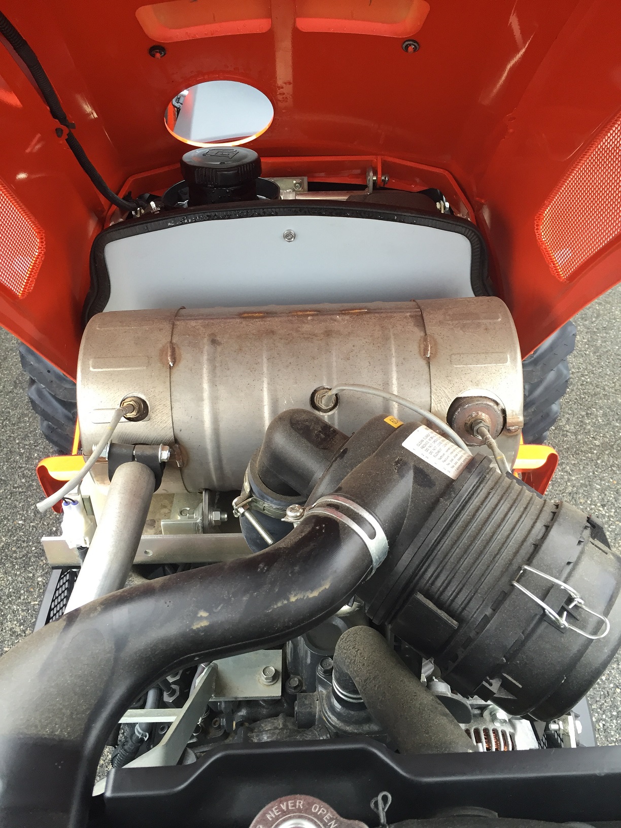

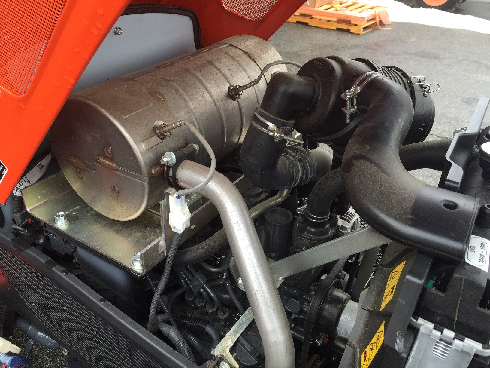

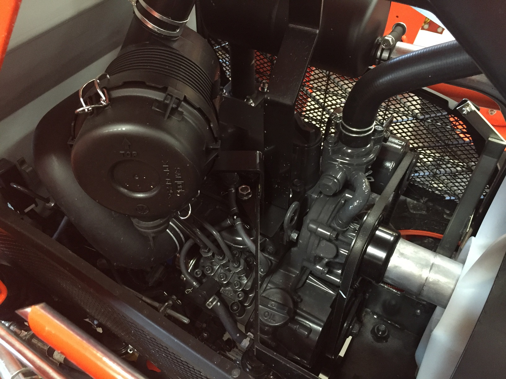

Pics of B2650 engine compartment first. And then the B3350 with the additional plumbing. The Turbo must be under there somewhere in the 3350 photos.
B2650 Engine Compartment
B3350 Engine Compartment

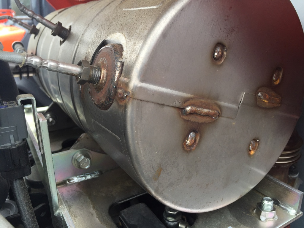

How do they keep all that rubber and plastic from melting that close to the DPF??? And no radiation barrier between the top of the DPF and the underside of the hood?? I'm thinking the hood paint is going to suffer!!!!

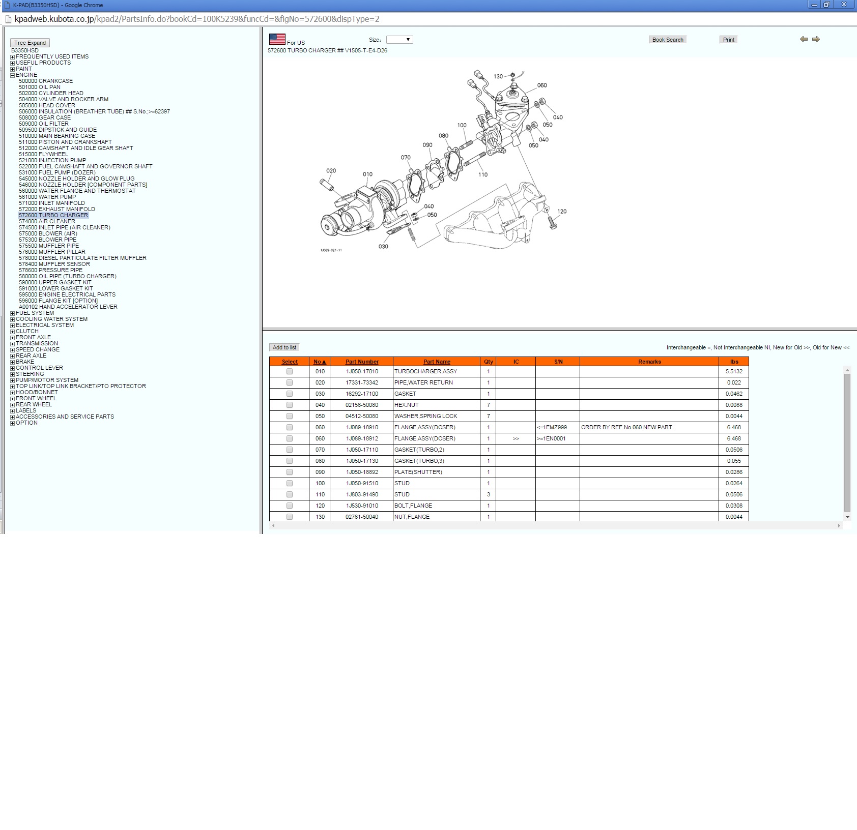

If you go to Kubota.com parts and look up the B3350, there is a turbo assembly listed in the parts. :D
   / Kubota B3350 - Turbo Diesel or Not?
#15
Beck:
Thanks. As a new (again) owner I didn't know the parts fiches were there. Here's a pic of the turbo with the part numbers. It looks to be bolted directly to the exhaust manifold. Click on the small image and then click again to see the full sized image.

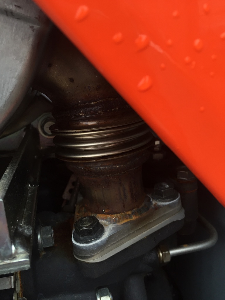

I think this may be a picture of the top of the turbo assembly on the 3350. Most of the turbo is hidden but I think the small metal tube on the right is one of the oil supply or return lines. I took this when I was purchasing my 2650. You can see the hood scoop that the 3350 has as well that the 2650 does not.
   / Kubota B3350 - Turbo Diesel or Not? #18
Yeah, they're trying to cool that DPF. Those things get very, very hot!!!!
