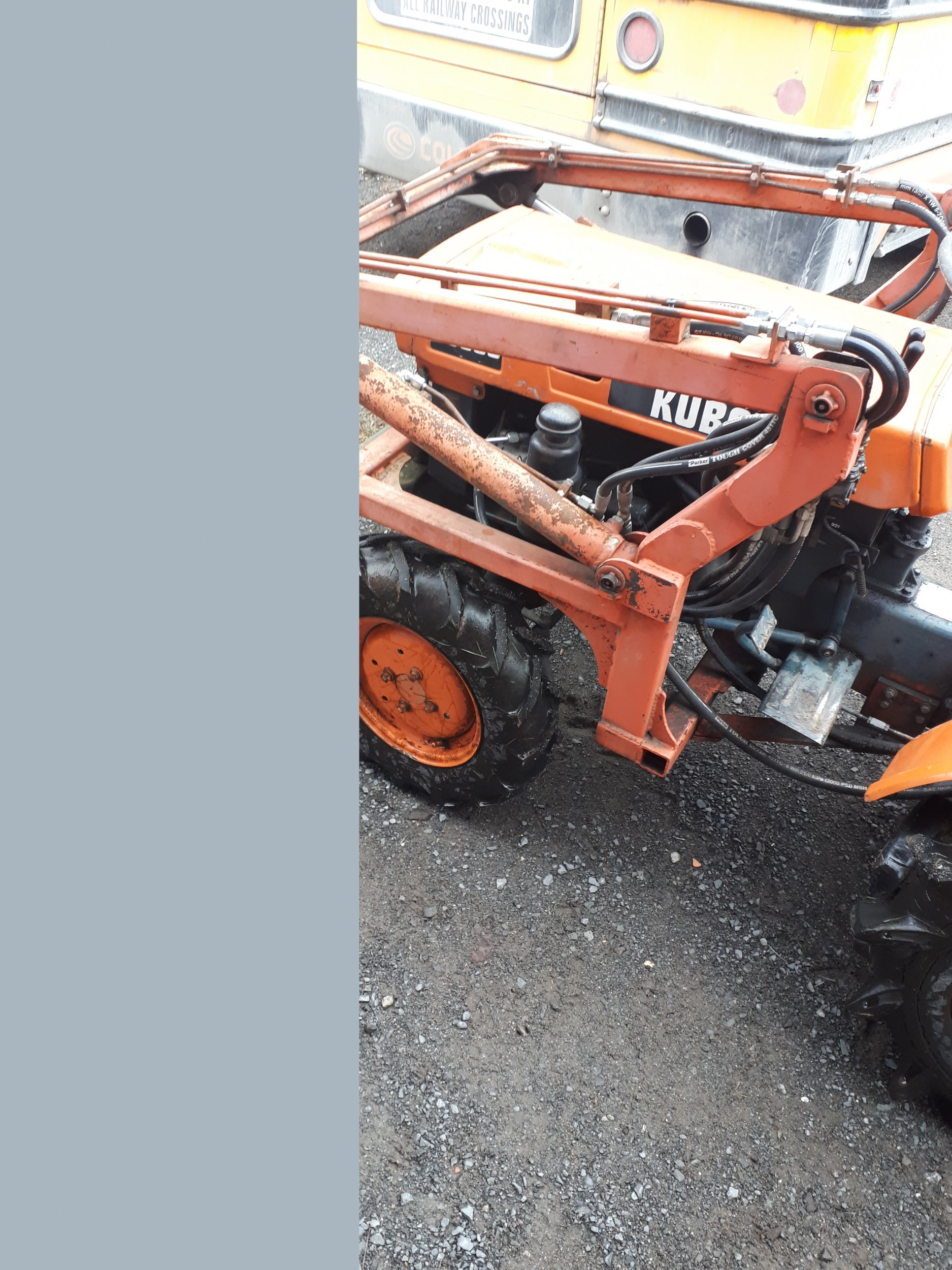

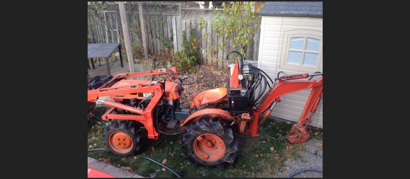

My unit has B6000 right on the hood as appears to be original decals?
It also has a small backhoe on it as well, driven by the PTO, the loader appears to be drivien by an engine mounted pump, there is a hydraulic line from the engine mounted pump back to the hydraulic reservoir sitting behind/above the 3pt hitch arms.

Here's a couple of pics
I'll attach pics once I upload them from my phone
The screenshot pic is from a strangely similar maqchine to the one I acquired, the other two pics are of the machine acquired.

So wait, is there a hydraulic pump on the rear PTO shaft? If you say there is a line from the engine-mounted hydraulic pump back to that reservoir that would suggest the backhoe is sharing the stock hydraulic pump with the (unused) 3pt lift.
I would expect this type of attachment to have its own PTO-shaft-driven pump, but it's hard to tell from the pics if there is even room for one.
