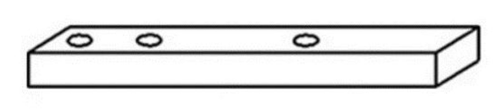

This should be Your Fixed Drawbar, note it is Not a 3Point category 1 attachment.
   / Kubota B6100E #23
This is what I have at this point, a well used place to attach a fixed drawbar.
Can you suggest one that will fit properly no doubt about it or do I need to take some measurements?
Ill need hardware as well.
Looks like the reciever is there, the rectangular box just under the PTO... There is nothing too special about it, Measure the height & width so you know the size that will fit into that box... also measure the hole size for the pin that will pin it in place.
I would take those measurements to a tractor salvage and see if I could find a used one that would fit. Ideally it should be long enough to put the ball mounting hole 14 inches behind the tip of the PTO shaft. but that is not going to be a critical measurement for towing a trailer... KennyV

14 in behind that's good information thanks for that I just came back from the local Kubota dealer and they confirmed what somebody else had already said that there is no such thing as a drawbar for the American Kubota tractor only Canadian so looks like I'm going to be making one cuz I'm not going to spend $60 for a flat piece of metal with a hole drilled in the end of it.
