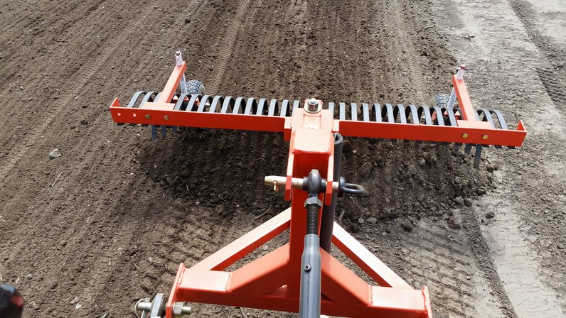

...are all implements $1K and up?
You'll be very happy with that tractor!
Prices depend on what you're looking for.
If you're handy and have a welder or access to a friend with one...you can make some nice implements for cheap!
My latest build was a York Rake...

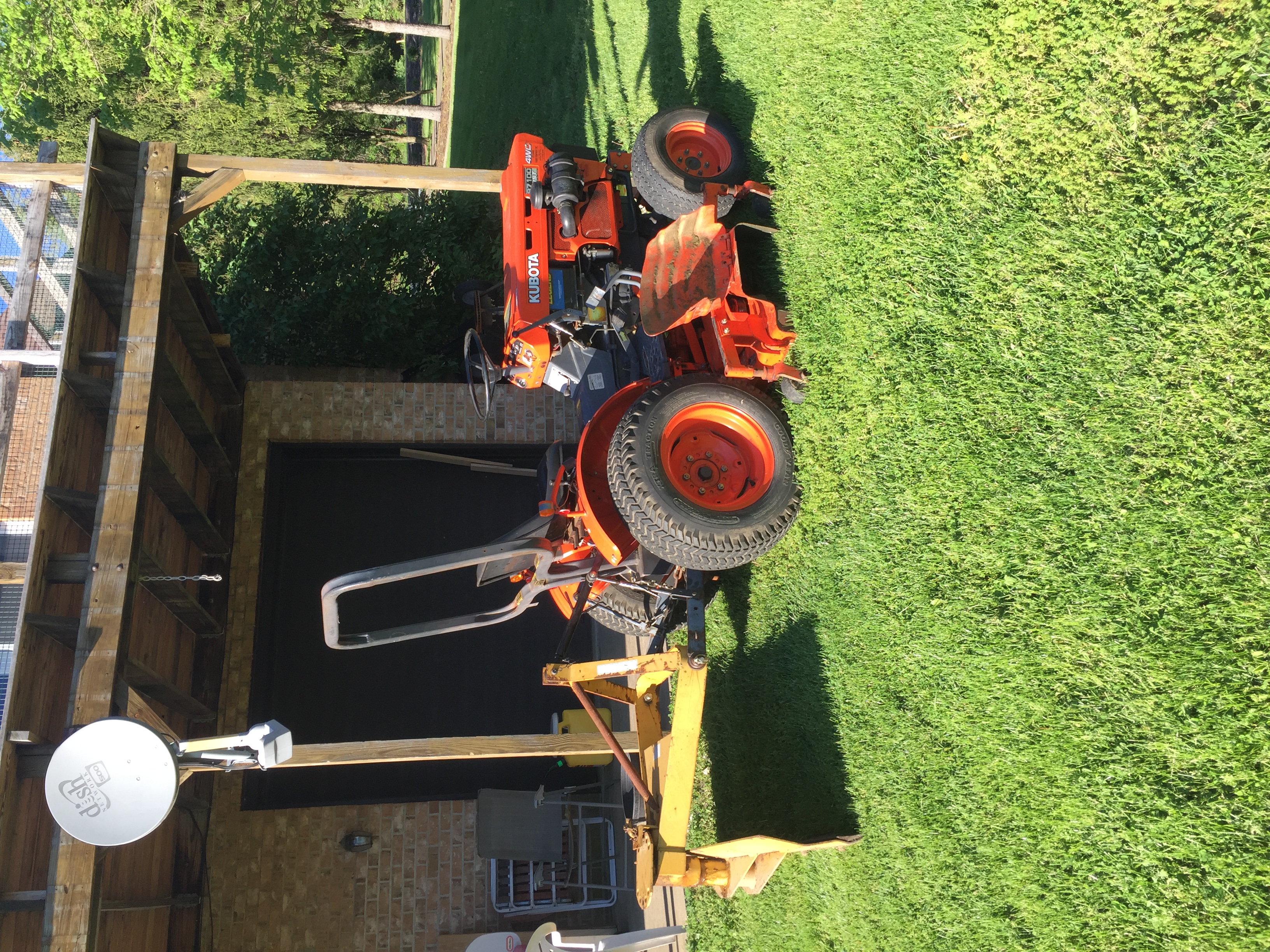

   / Kubota B7100HST #20
you can put skids on the blade, or try turning it around, that way it won't "dig"
I took a took plow and adapted it to work
