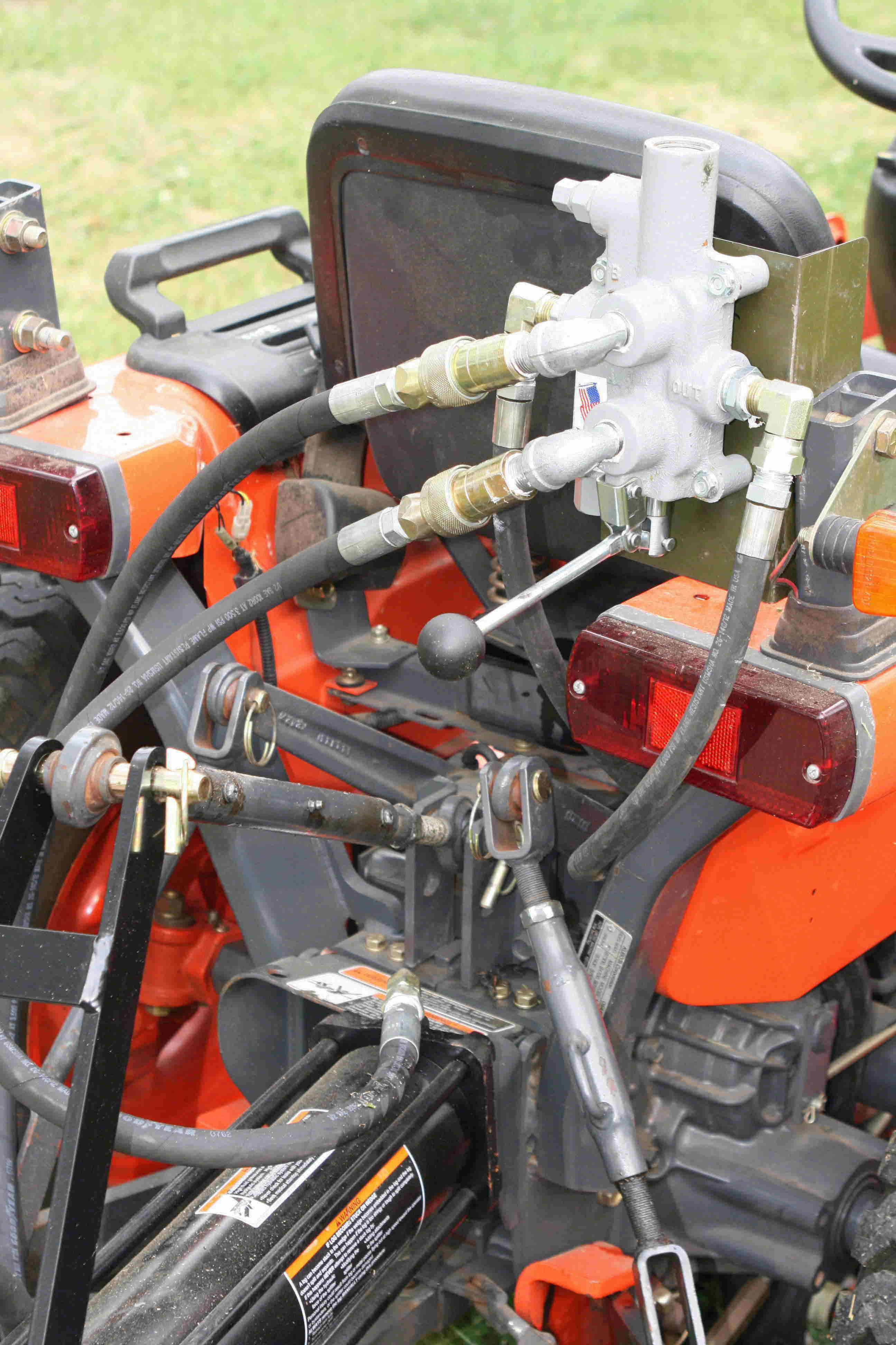

Wayne,
Could I discuss your log splitter plumbing with you please? I want to do the same on my 7500 and could use a little insite.
Thanks.
Bill
   / Kubota B7500 #14
bmclaug,
Here's a pic of the rear of my 7500. I also have the Northern Tools splitter. I removed the valve from the splitter and mounted it on the back of the tractor. That way, the quick disconnects are on the splitter lines and not the tractor lines. I didn't want to ever forget to reconnect the power-beyond loop of the tractor when removing the splitter.
Scott
