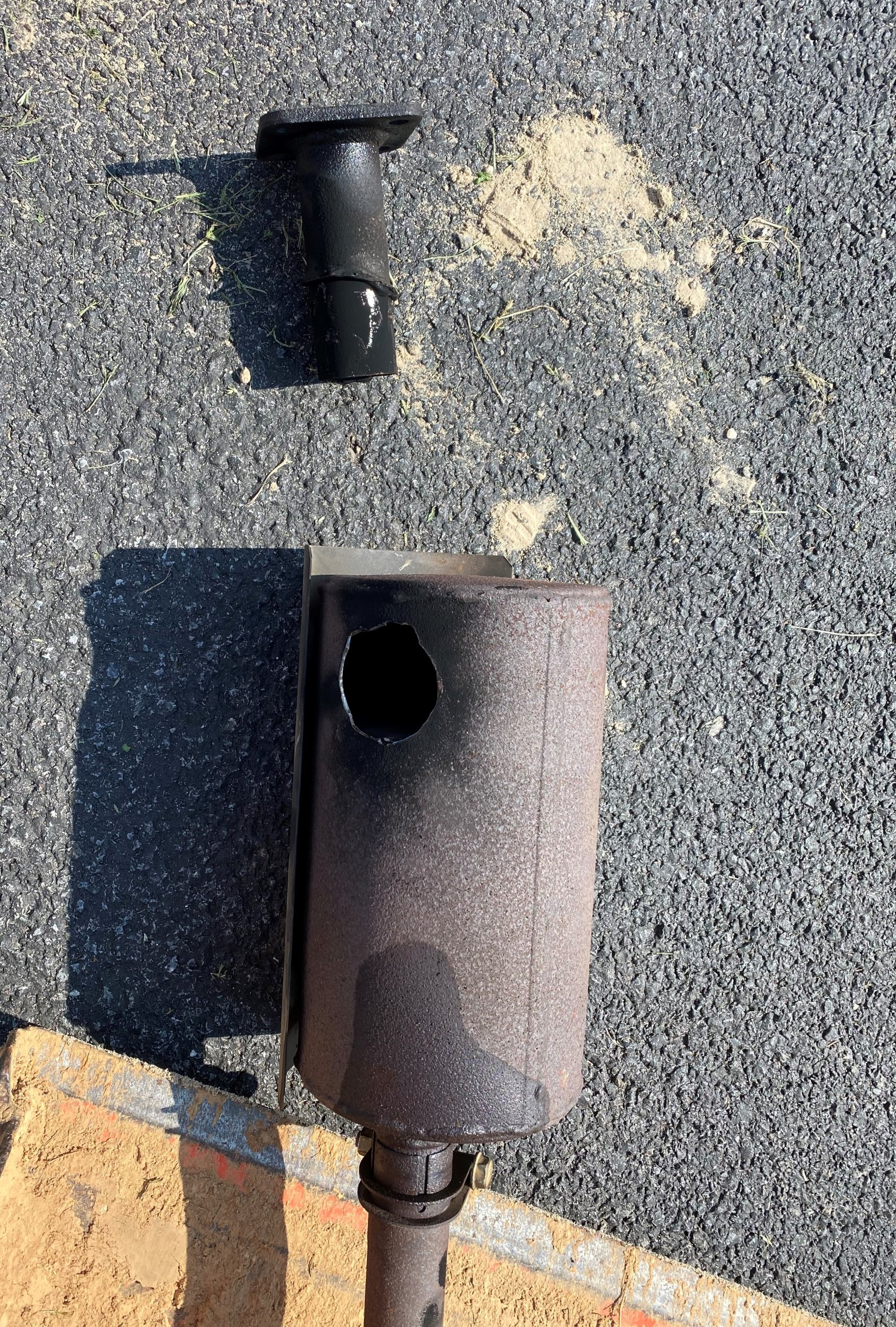

Update: Ran it today. Started right up and had no issues pulling a landscaping rake around a riding arena.
I did take a closer look under the hood as I checked the oil, and noted that the muffler weld had broken where the muffler is attached to the down pipe that hooks into the exhaust manifold. Quick look on Mesnicks, and a replacement muffler is $450...lol. When I have the opportunity, I will pull the muffler and take it to a local welder, and he should be able to reweld it for $40. I do not think this had anything to do with the issue I had....unless somehow the muffler shifted and blocked exhaust gases for a period.
   / Kubota B7800 - hard starting, lots of smoke, low idle
#13
Here is a picture of the broken muffler (I was wondering what that rattle was under the hood). With the relatively heavy muffler sitting on top of that single exhaust pipe, with no other support, it is not a surprise that after 800 hours the weld would shake loose. I will ask my welder to add bracing on either side (exhaust pipe to underside of muffler) to give that point more support.
Started up good this morning....nothing leaked on the driveway overnight, so the original problem is still a mystery.
