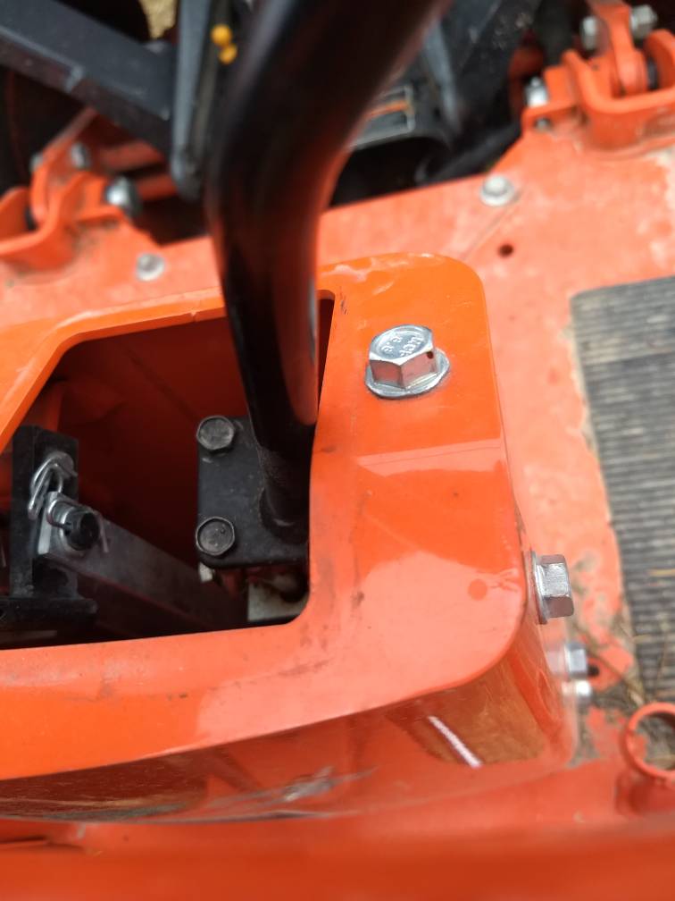

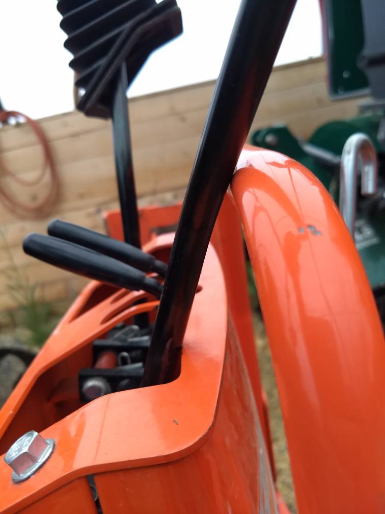

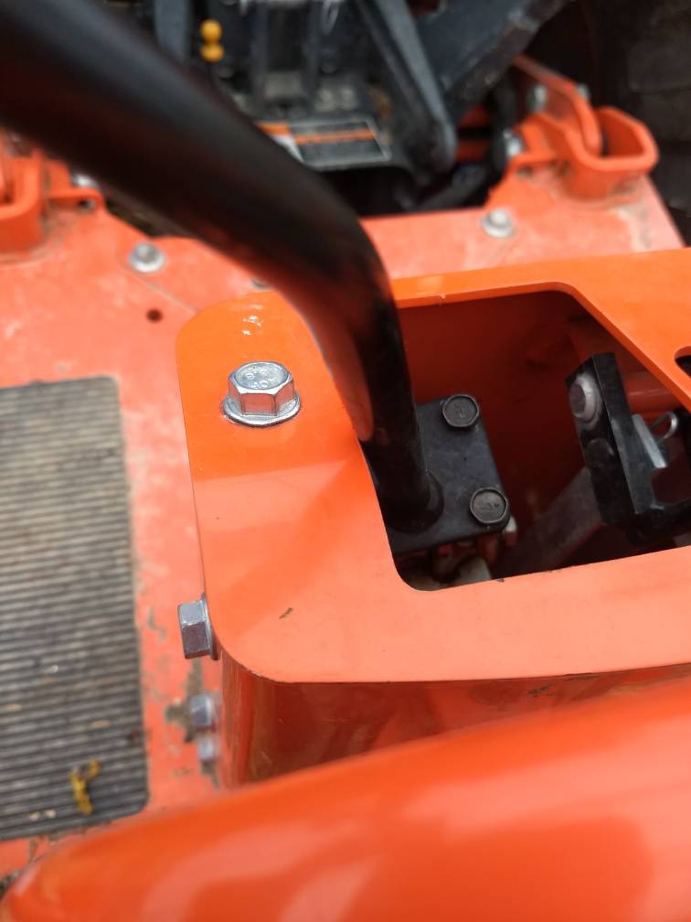

Just in case this helps anything, after seeing this, yet another thread about bh77 glitchy behaviour. My BH77 does sometimes lose force with boom and dipper both extended away from the tractor, with down or lift force weak or gone.
Just checked again the action where the valve levers connect to the BH valve body, with the rubber boots lifted off.
I tried moving the levers through a complete range. The levers hit the metal frame AT 3 POSITIONS!
And there's even more interference when the rubber boots are clipped into place.
Moving the dipper/bucket lever all the way forward even hits the guard rail.
My next task is to remove the top plate that the levers pass through and run bh without that interference.
The design of the BH control tower has the levers way off center of the openings. There's lots of room when moving the levers toward the tractor or center.
I may try shimming under the lever mounting plate to help tilt it a bit away from the obstructions.
It should help SOMETHING to allow the valves full range of motion!

The 3 places the lever motion hits the frame. IMG_20200609_184457473.jpgIMG_20200609_184434563.jpgIMG_20200609_184418352.jpg

Do your levers hit the frame tube or tower top cover?
