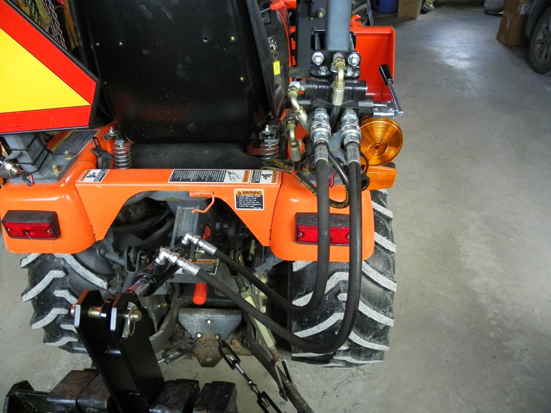

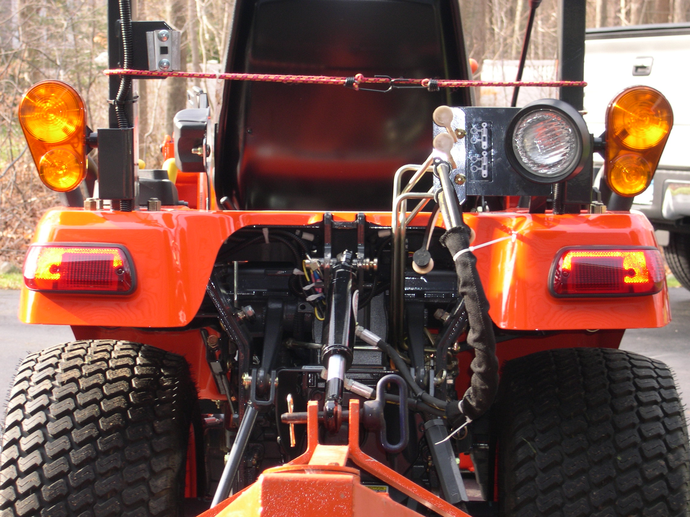

After reading about this here I put these on my BX2230 as I wanted a Hydraulic Center Link on my tractor. Here are the photo's
David Pidgeon
New Haven, Vermont

Nice job. I had about the same exact set up on my old BX1860 with one notable exception. This may not be an issue for your BX2230, but when I mounted the hydraulic cylinder like yours with the 90* fittings on the top side, the one closest to the tractor hit the top link bracket at the back of the tractor when I raised the hitch full up. Sheared the fitting right off. That happened about 5 minutes after I started using it. I had the same Surplus Center cylinder you have. I ended up rotating it so the fittings were underneath, which worked better on the BX1860. Still miss having a hydraulic top link. Thinking about how I might add it back to my BX25.

CHDinCT: Many thanks for the warning. It is not a issue as I kept a eye on it when first installed. I did have to turn the one on my M7040 over and on my old JD 2355. Many thanks for thinking of me.
David Pidgeon
New Haven, Vermont
