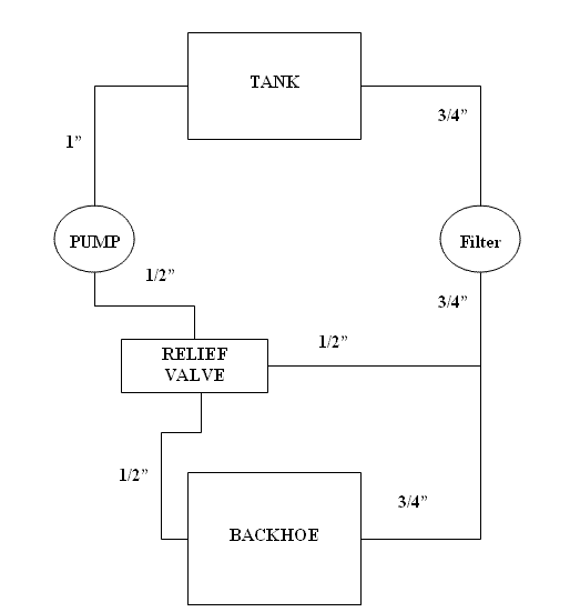

I drew up this diagram quickly with the pump listed above in mind. Before I go too much further though I want to make sure what I have in my mind will work. So does this look feasible?
Also, I suppose this diagram depends on whether the BX23 backhoe uses and open center or closed center valve...does anyone happen to know this?

The BH's valve IS open center for sure, and the valve bank should already have PRV's(pressure relief valves) in it so another one would not be necessary.
/ Kubota BX 23 Loader #10
I agree with Kennyd on the pump. I use the next size up to run a hydraulic motor. You will need a gauge to set the pressure relief valve on the backhoe control valve. It is quite possible that it is set higher than the pump limit.
At 7gpm 1/2" ID hose should be satisfactory in all parts of the circuit (including the return line) other than the suction line, which should be 1" ID as you show.
Good luck, and send us some pictures.

I double checked but it looks like the backhoe might use 3/8" hose for inputs and outputs. I did some checking around and that appears to be good for up to about 6GPM max. I dont think this will be a problem though because my tractors PTO only turns 540 right around 3000 RPM so I should be able to run it at a slow speed something like 1500 and should be right around or under 6GPM.
