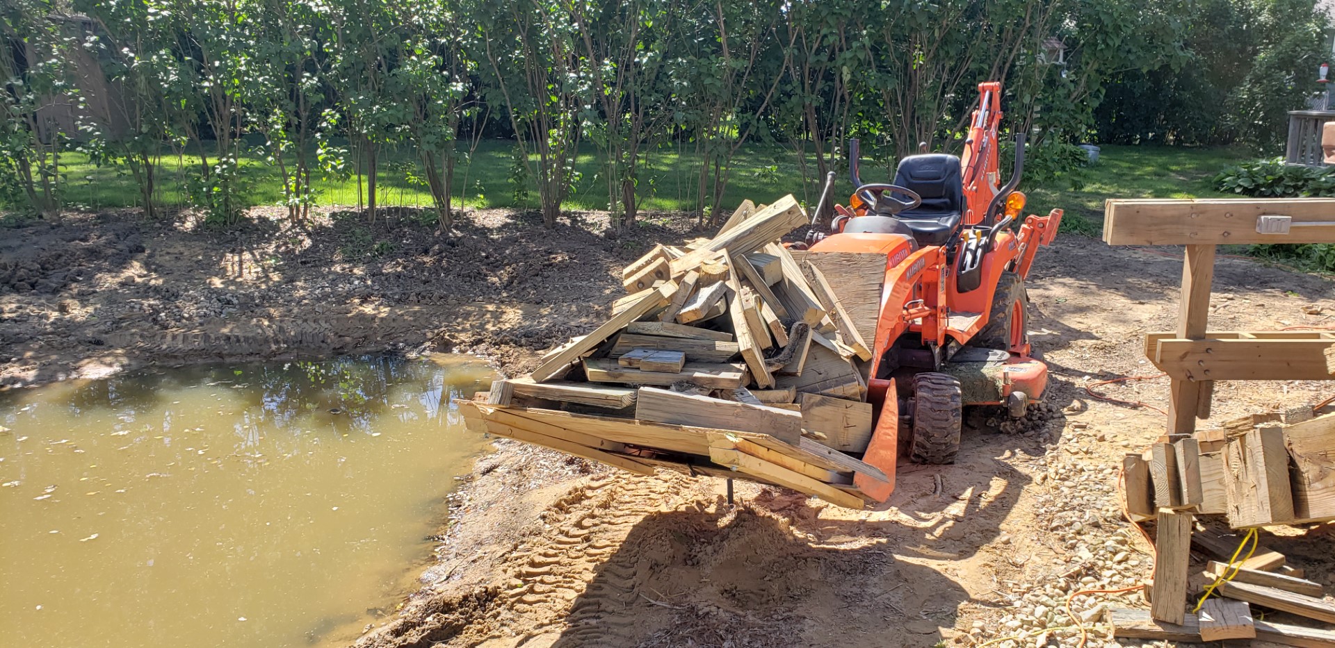

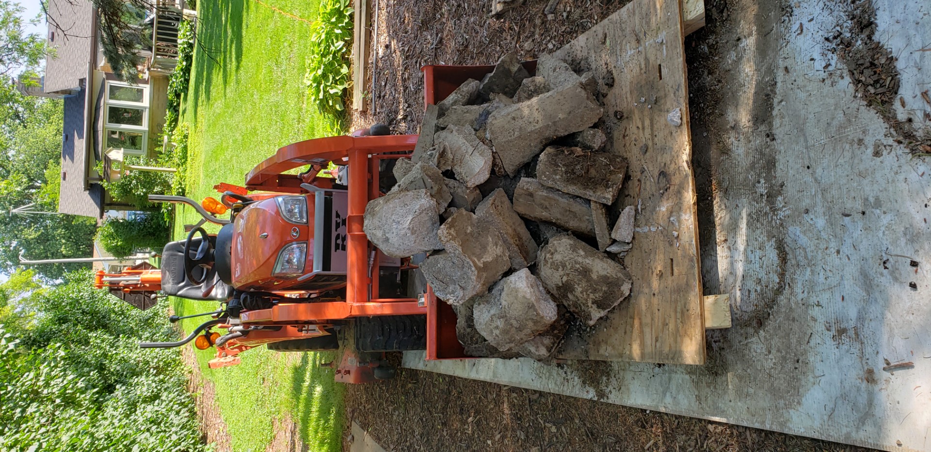

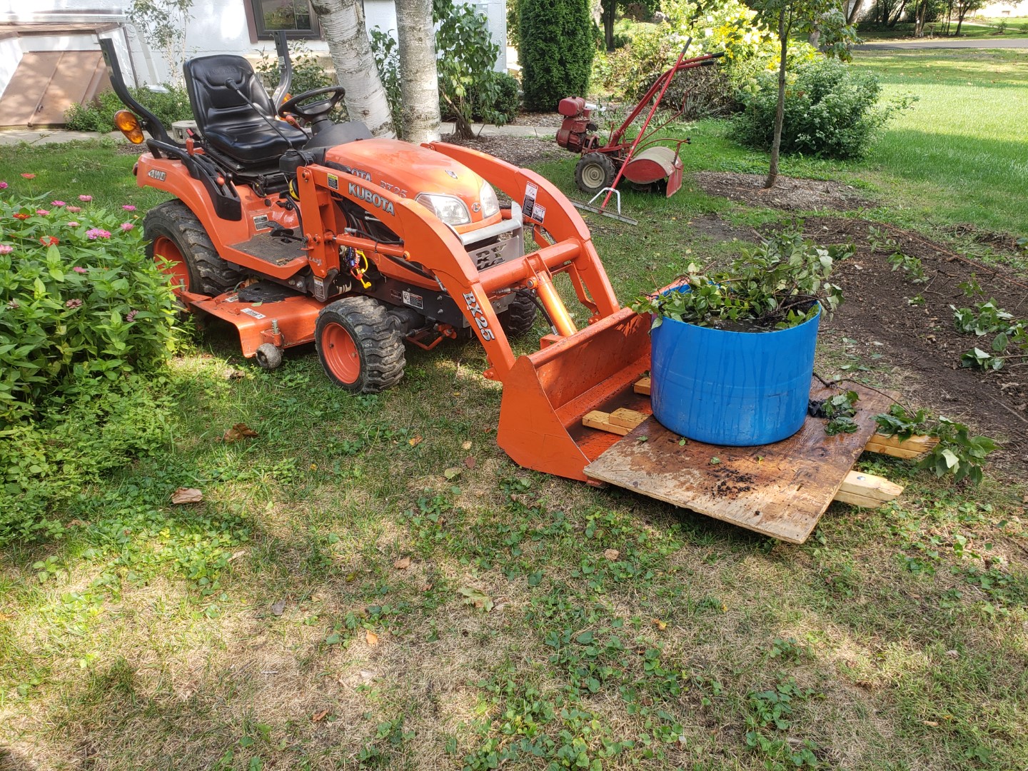

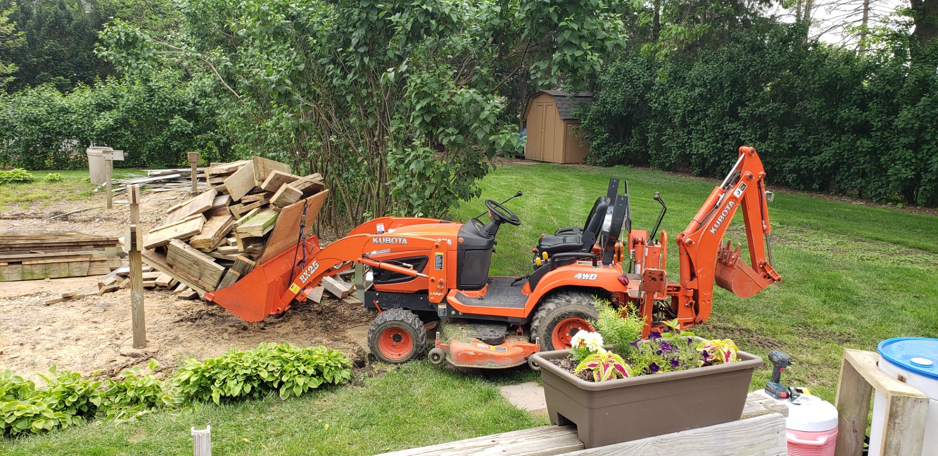

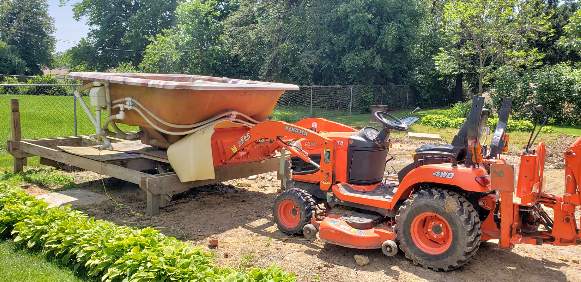

I recently had the task of tearing down an above ground pool and deck. This included removing the in ground concrete from structural posts. The bucket on the BX-25 (according to specs) will list 510 pounds. The area inside the bucket is quite limited. I wanted a way to move much larger quantities of material. I looked at commercial forks for the bucket. First, I felt I would only need them for this one project (I later found out I was wrong :)) I also didn't want the expense of commercial forks along with having to store them and the fact that they are heavy. I thought for this project I will use 2X4s. I didn't even tell anyone because I thought they would laugh. Well, they worked perfectly! ------
I bought:
  • two 2x4's - 8 feet long
  • four 1/2" carriage bolts that where 4" long
  • four 1/2" nuts
  • four 1/2" washers

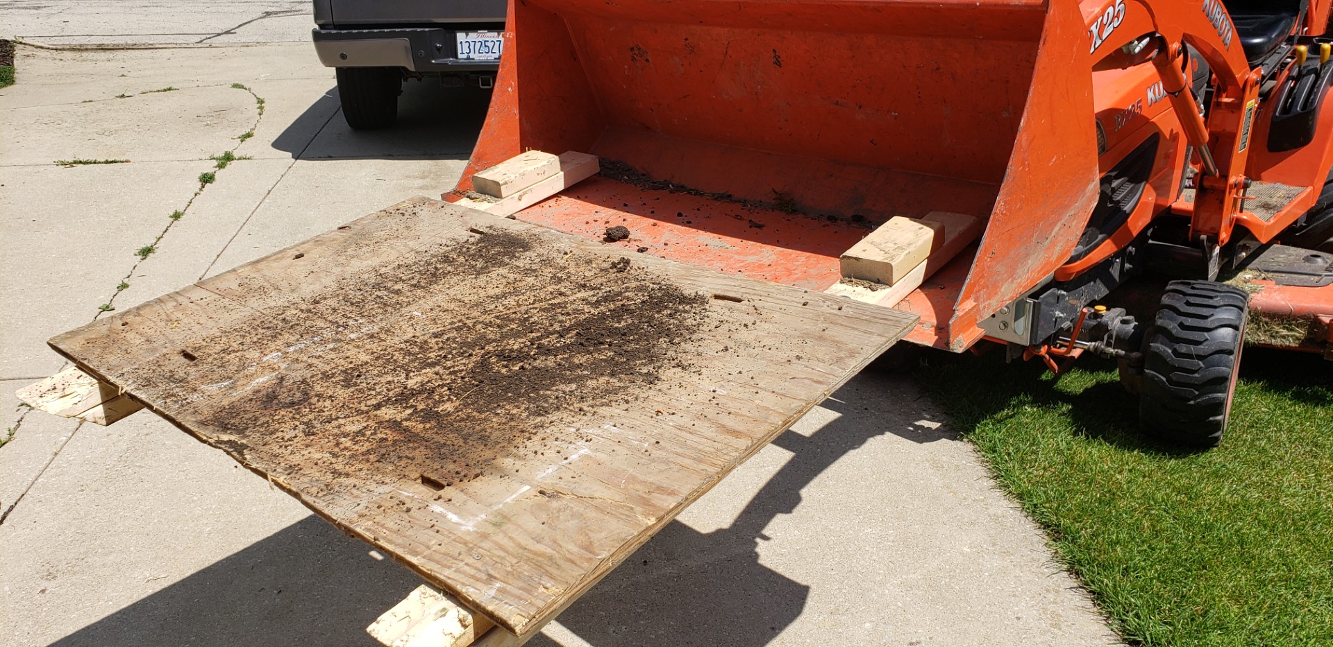

  • I utilized a scrape of plywood for more surface area. I use 4 woods screws to hold the plywood in place during use.

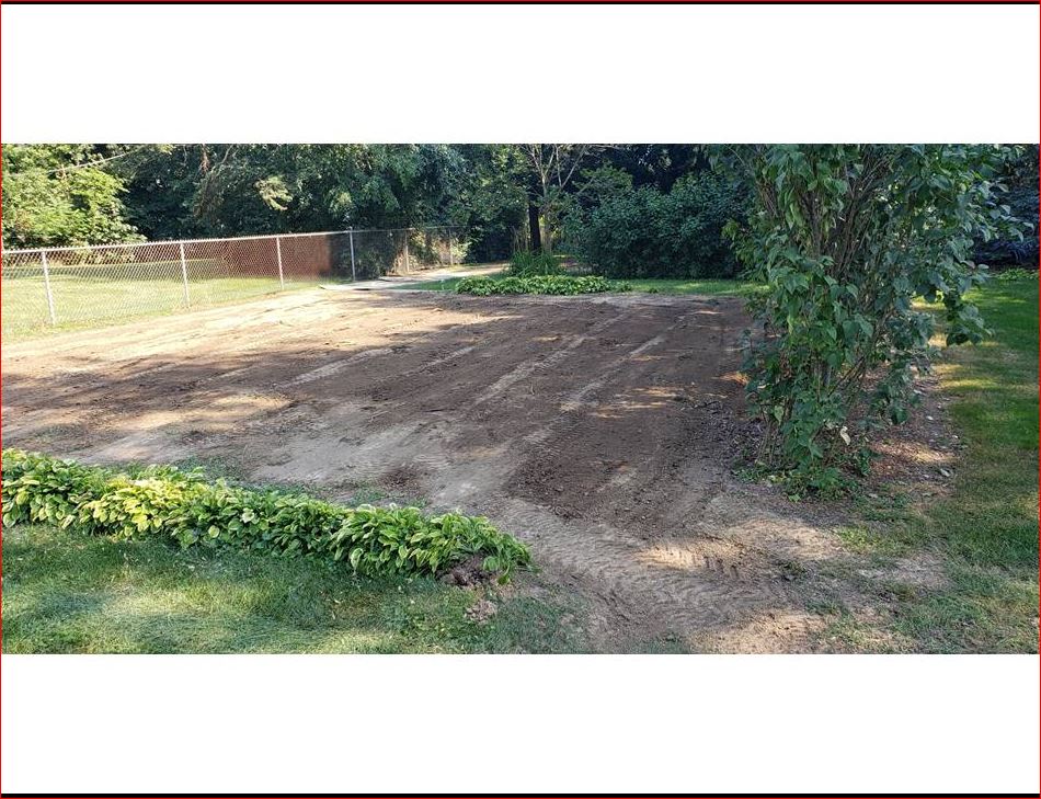

I have about $12 in the entire project. ---- I cut the 2x4s in half. For fabrication (it's so simple I think fabrication is too big of a word) I just clamped (pinched) them on the bucket so I could locate the holes. Each pair has two 1/2" holes drilled in them. The photos will be self-explanatory. These two forks will hold more than the tractor can lift! - I snug up the carriage bolts, pinching the forks onto the bucket with a cordless impact gun using a 3/4" socket on the nut. It takes all of 2 minutes to install them. They are light weight and easy to handle. When I installed this pool 25 years ago I hand dug out the deep end. (A lot of work!) I removed approximately 18 cubic yards of dirt at that time. I made a large mound in the backyard and planted wild flowers on it. It was very attractive. And, now that the pool was coming down I had the dirt to fill the hole back in. The BX-25 made this a simple and fun task. I have included a before and after picture of this project.
Additionally, one photo shows the forks being used to move a blue bucket full of water as I recently was transplanting lilacs. I find they are getting used far more than I expected. I also just used them to load a large piece of machinery into the back of a pickup truck. The equipment was secured to the setup with ratchet straps......Give them a try and OF COURSE never get under the elevated forks of any kind. Mechanical failure would cause serious injury or death....I have a saying. "If it's predictable, it's preventable." Don't get careless and end up getting hurt. Laugh if you wish but you will love this inexpensive addtion to your tractor.

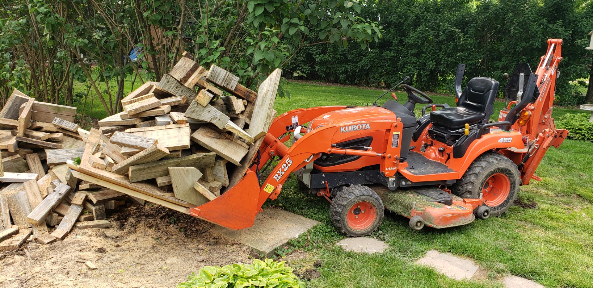

I'm glad you enjoyed it. It worked much better than I had anticipated. I had hoped that it would get me through the swimming pool demolition project but I now use it often. I didn't mention this in the original post but you will see 2 small 2 x 4 blocks mounted on top of the forks inside the bucket. When I have a lot of brush from trimming lilacs and trees, etc I prop another piece of plywood vertically. I secure it with a ratchet strap because it's quick and simple. That keeps things from toppling over onto the tractor. I think you can see it in one of my pictures.....I suspect you have a larger more powerful tractor. Perhaps you could add a 3 fork to make lifting heavier items possible.-- Regards, Pete Siekmann, West Chicago, IL.

Have you had any problem with the forks coming loose? It looks like they could just slide off. That is an idea I will file away for later use.
Doug in SW IA
   / Kubota BX-25 Super Simple, Fast and Inexpensive Forks for the Bucket
Hi Doug,
No, when I use the cordless impact gun it tightens the forks up really, really well....There is no problem there....I hope you enjoy it.
