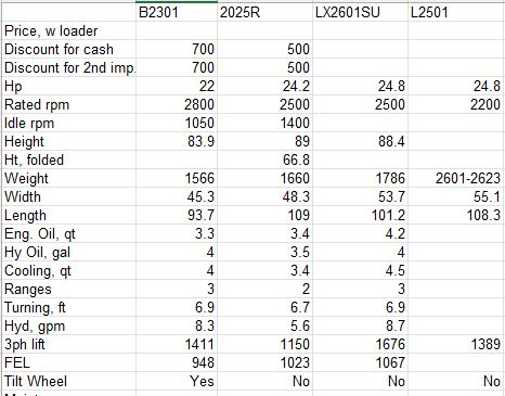

I've a 2025R and am considering switching to a B2301 or B2601. Do not like the idea of the hydraulic cooler and fan underneath like on the BXs. The fan would get ripped away by brush in the work that I do. I even had brush remove my oil dipstick once when I had a Gravely.
Had a lemony 1025R for almost 2 years. I once accidently shut off the fuel supply by hitting the lever with my right foot. It was just too small and, of course, lemony. Liked being about to refill the tank located underneath one rear fender vs. going up top on the 2025R and the 4010 before the 1025R.

What is making you want to switch from a 2025r to a 2601? How do they compare?
   / Kubota BX 268I've owned it since 2007 and it has 1,000 vs BX 23S VS B2601 #8

I'd look at an LX2601. It's like about a 2.5 series JD. I'm looking at either a B2301 (don't need the hp) or LX2601SU (don't need mid PTO) to replace my JD 2025R. They still have turning brakes.
