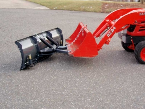

I have had my eyes open for a used blade, cheap thinking if I ever find one I would try to make a mount similar to the bxpanded blades that mout with the bucket on and use the lift and dump of the loader..
This is one way you could do it or even adapt the blade to mount to the loader with the bucket removed.

The biggest issue with attaching the blade to the bucket is being able to stack snow. With the blade that far out in front of the pins you are seriously reducing the amount of snow you can push-up into your pile. I would suggest either building or having a bracket built for the blade that replaces the bucket. It would move the blade a lot closer to the pins.

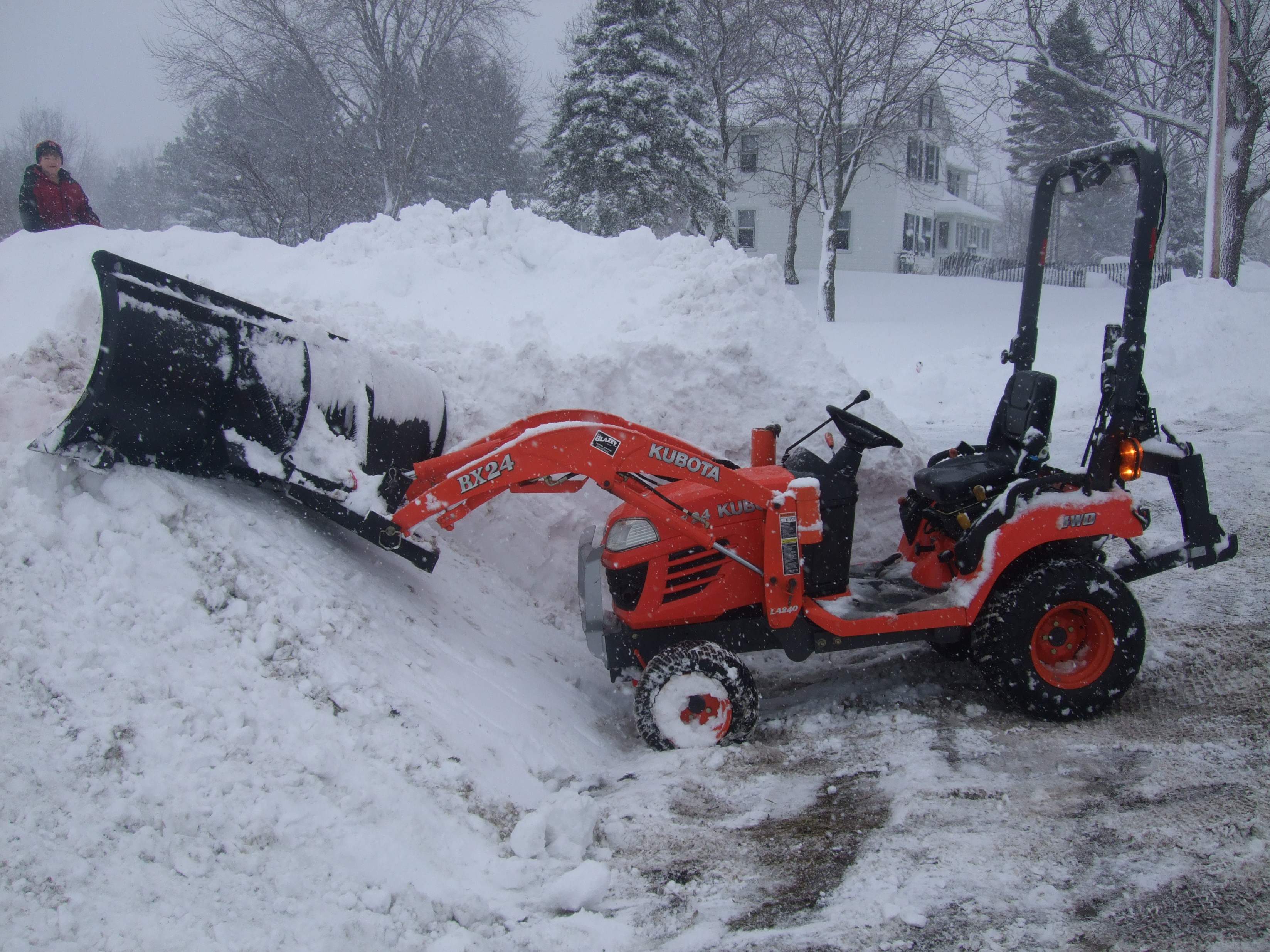

I modified my A frame off old truck plow to fit on my FEL arms as I prefer to use plow in front. No problems what so ever. Since I had scrap metal, and welder I just went at it. I mounted the FEL points as close as I dared to allow the plow to pivot. Dont worry about sfrankland comment about stacking snow. If you can push it, then you can push it up and over the bank. DSCF3353.jpg

With your current setup radioman you would be fine. Stick that blade on the front of your bucket and yes you would still be able to push just as much snow. Pushing has more to do with traction then the lifting ability of the loader arms. With a blade like you have stuck on the front of your bucket I doubt you would be able to stack very much. Stacking snow has less to do with traction and more to do with the lifting capacity of your loader arms. At the pins on a BX25 you can lift 745 lbs. but moving out just 19" past the pins you drop to 518 lbs of lift which is roughly where you are at. Moving out another 20 inches or more to allow for a pivoting blade attached to the bucket and you are losing a lot more lift again. The combined weight of the bucket and the blade assembly would mean a smaller lighter blade would have to be used to effectively stack snow. A setup like I suggested and like you have where the blade is attached directly to the loader arms would be the better and more effective choice.

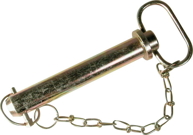

My neighbor has his plow pinned on the same as radioman's. He removed the factory pins that are secured with a small bolt to one that is held in place with a lock pin like in the photo. In the summer he bolts the bucket back on. It takes a minute or so to switch it over once you get the hang of it.

Its a function of the angle of the plow. When radiomans plow is going up into the pile, the A frame is angled up (the plow is higher than the pivot point), so his plow goes up. When the guy is pushing into the pile with the bxpanded plow, the A frame is flat or angled down so it is trying to push the whole pile and it runs out of traction.

As for swapping bucket to plow - I bought the hitch pins from local TSC and used that to swap in winter time only. During the summer for dirt digging, I swap back to the normal black pins. The middle curl hitch pin, I drilled a hole to install a zerk and drilled another hole to let grease come up to the middle of pin.
I use the same hitch pins for bucket when I need it during the winter so swapping it only takes me 10 mins or so. If you cant spend 10 mins of your time, then something is wrong. I believe the new QA's will eliminate that time wasting.

That'd be great if you could take pictures! I'm thinking I might go the route you took! I originally was thinking I would build an attachment that connected to the front bumper. Similar to how the Kubota blade/blower attach to the front. That way I could switch between blade and bucket as needed.
