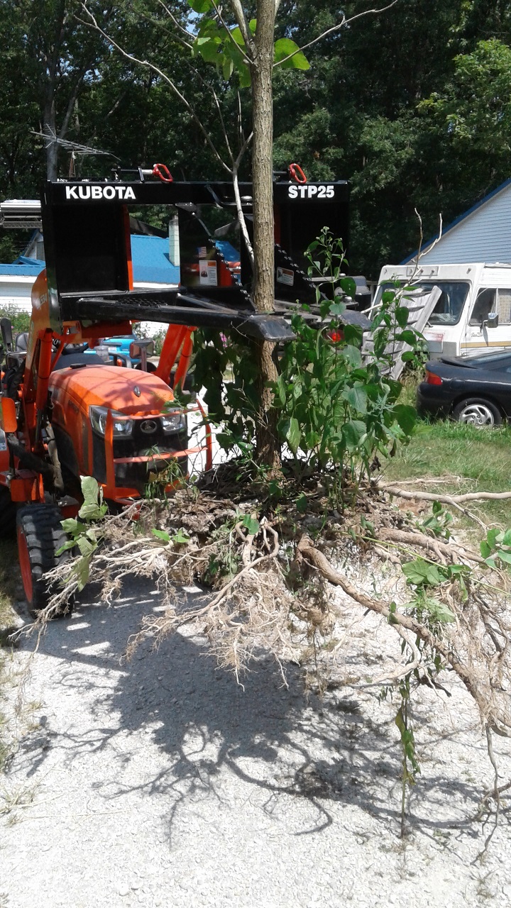

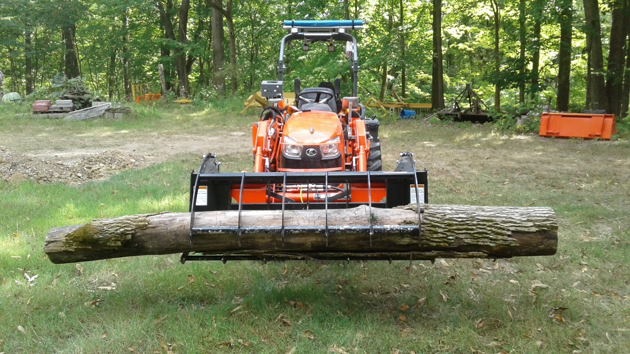

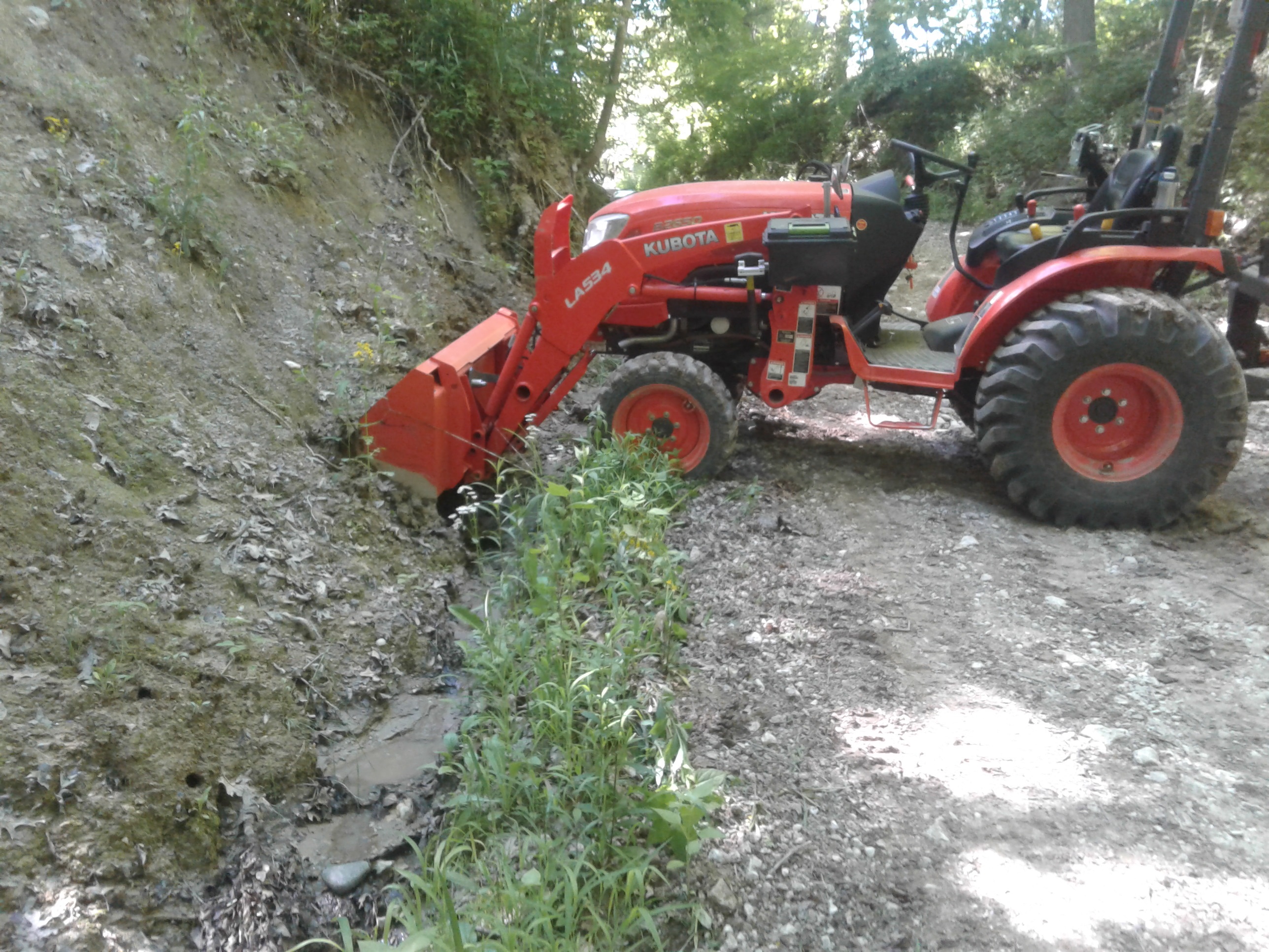

How do you plan to use it? I replaced a lawn mower with a BX2370, FEL and pin on bucket. One of my applications is removing mudslides from a drainage ditch on a hillside (most dangerous thing to do when tractor is already leaning).
Purchased B2650 with FEL, SSQA, 3rd function control, loaded tires and larger ballast box. Feels safer, still dangerous. By BX is now my mower, tiller and lawn rolling tractor. The B is my general purpose machine and becomes more useful as I add attachments.
The B2650 has been replaced with LX2610, BX2370 with BX2380. The new hydraulic connector (all 4 hoses at once) seems to be a (leaking) problem Kubota is still working out.
I would recommend the B/LX for more lifting power, positional 3pt control and 3 range transmission. The new loaders can be setup with mechanical self leveling (pallet stacking).
