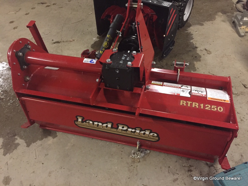

Which Landpride tiller? Makes a big difference. I would not recommend the RTR 0550 or RTA 0550 at all to anyone. I would highly recommend the RTR 1250 or RTA 1250 to anyone.
You had me worried for a few minutes. I went down to the shop and took a picture. I wanted the reverse tine tiller, not the forward. I didn't research these at all, just bought what the dealer had in his yard (as far as model goes). What's wrong with the 0550 models?

The RTR 0550 has 4" tines instead of 6" on the 1250. There are less of them. They don't till as well and the unit is way lighter. The worst part of the 0550 though is it has a shear pin instead of a slip clutch. And it breaks, very often. All around, the 0550 is a very light duty tiller, while the 1250 is quite the opposite.
My last tractor was a L3800. I had the 1260 on it and did a ton of tilling with it, including a lot of virgin soil. It worked flawlessly with no problems. If something stuck, the slip clutch did its job and protected everything. Remove the rock or sticks, then go right back to work. I tilled my brothers large food plot several times with it with the first time being it's first ever tilling.
My brother then bought a BX25D with the 0550 tiller. The very first time he tried to till that same plot that had now been worked over several times by me, he couldn't make it 20 yards max before breaking a sheer pin and he couldn't till very deep either. I was there with my 1260 and went right to work and did the whole plot with no help from him. He spent more time trying to replace pins that it became useless.
When I bought my BX2370, I made sure to buy the 1250 with it. I have used it quite a bit and it is as durable and easy to use as my 1260 was. Can't say enough good things about it.
Basically, the 0550 is a toy in comparison and in my opinion is not worth having. My brother is trying to see if he can buy a slip clutch shaft to replace his current shaft, but even so, it won't till as deep or quick as the 1250. He really wants to get rid of it and buy one like mine (and yours).

My RTR0550 has the optional slip clutch and it works fine for my needs, but if I had it to do over, I'd get the 1250.
