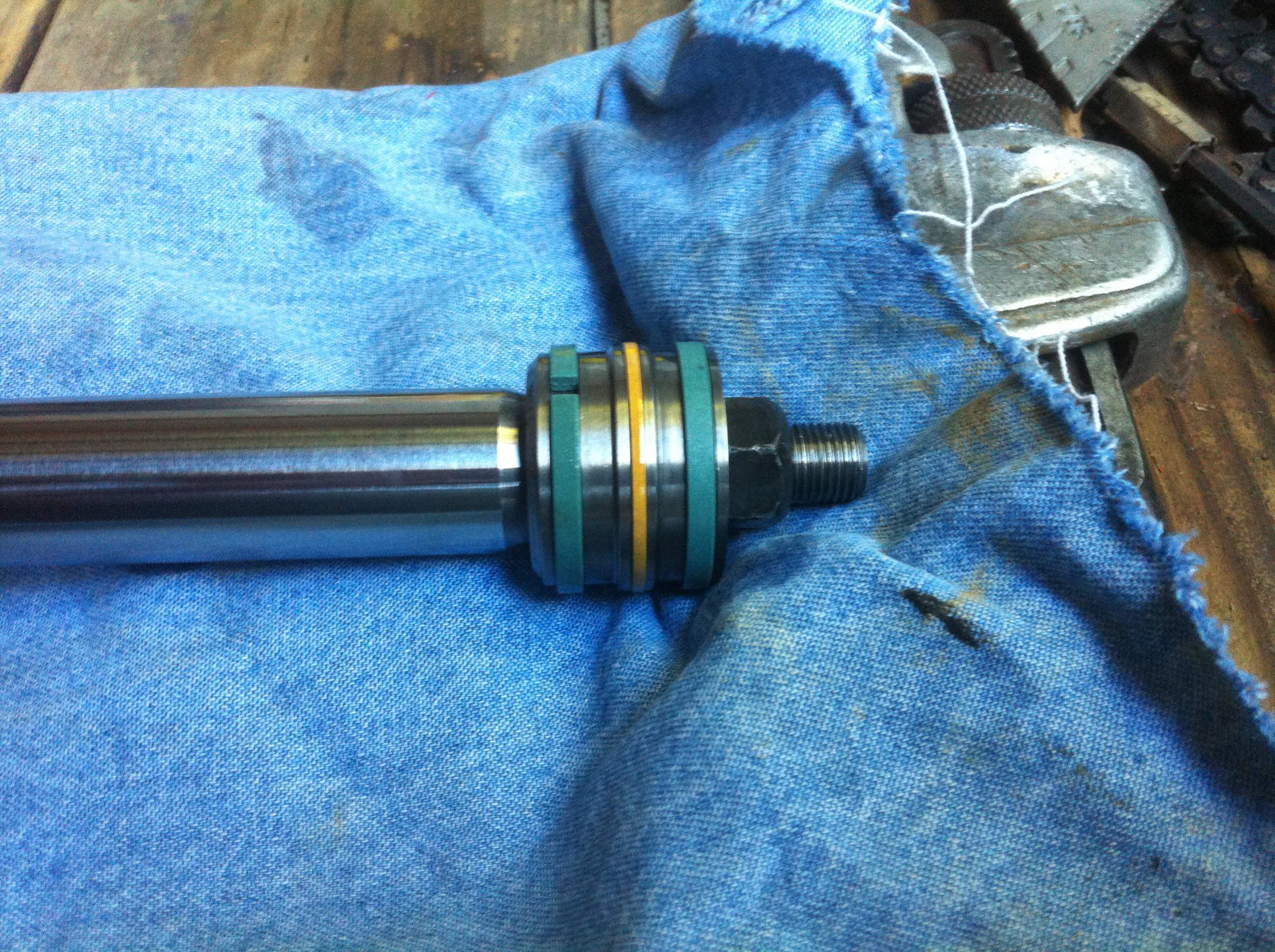

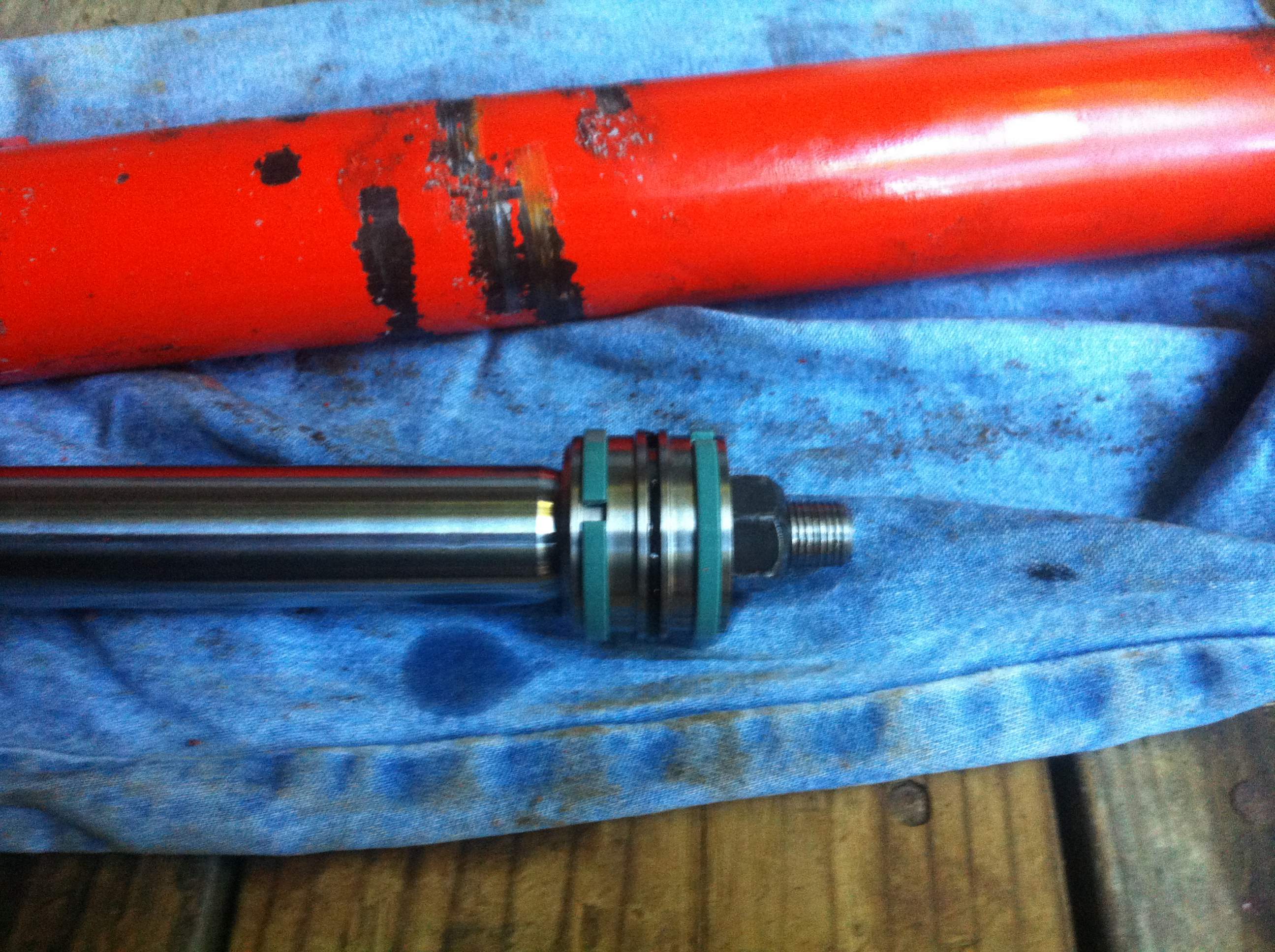

   / Kubota BX22 - LA210 - Lifting Issues
#12
As you can see from the attached Photo's the right cylinder is bypassing from within. Some of the center O-rings are missing. Thanks for your input and help. IMG_2750.jpgIMG_2752.jpg
   / Kubota BX22 - LA210 - Lifting Issues #13
Calvin,
My concern would be what allowed or caused this seal to fail again? Is the cylinder bore scored or enlarged/ ballooned, egg shaped etc. at some point which would cause the seal to fail.
