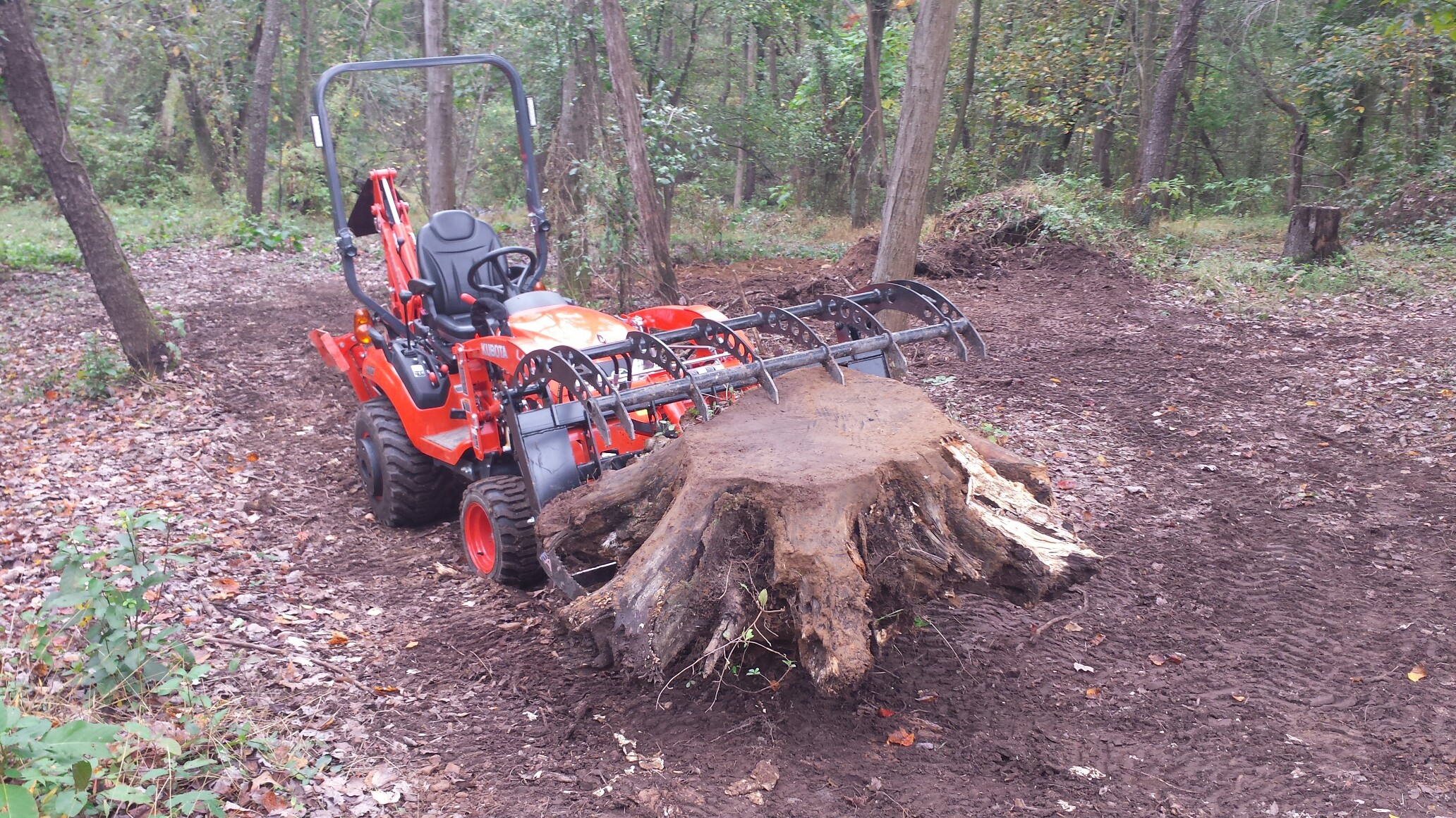

Definitely get the 3rd function when you order it. I didn't and took it back later for them to do it. I bought the kit and after looking at it, just figured it was something I didn't want to get into. It really is more of a diverter valve than a true 3rd function, but I really don't notice any issues with using it. Doesn't take long to know when to push the button and when not too. :)
The EA grapple for the SSQA is the 55" one and weighs a bit over 200 lbs. I am assuming the LP one is about the same weight. However, when I did a lot of research on the EA and Land Pride ones, the EA one just seemed to be built much heavier. I can attest that I have been using it very hard the last few weeks and I haven't seen any issues with the structure of the welds. All I have done is knock some of the paint off and got it muddy as heck. :)
Also, I wanted flat face connectors, so when I ordered my grapple from EA, I asked them to just cap the lines. They took $20 dollars off the cost. Then I got 2 sets of 3/8 inch flat face connectors from Amazon and attached them to both the 3rd function valve and the grapple. I put a male and female on each end, so there would be no way I can attach them backwards. I am sure you can get the dealer to add the connectors to the 3rd function valve when you get the tractor, if you don't want to do it yourself.
Here is a picture of me using it this afternoon in my woods that I am clearing.

Sweet! That's exactly what I will do. Are those weights on your back wheels? That stump is huge.

You are welcome. I am far from an expert. It is just that I just did all this research earlier this year, as I just got my BX23S in the Spring. Hopefully I can help a little. There are more knowledgeable folks on here, so keep reading. :)
Yes, those are steel wheel weights. I preferred them as if I loaded the tires with something, and it got a hole, it could all leak out and I have to do it all over again. These are just held on with 2 bolts and are easy to remove. Also, if I need to repair/replace a tire, I don't have to deal with all the mess inside the tires.
Yea, that stump was all that the BX could handle. There were a few it could not pick up, but I just grabbed onto it with the grapple and pulled or pushed it where I wanted it to go. Not quite as fast as being able to pick it up and carry it to the burn pile, but it got there... and I didn't break a sweat. ;)
