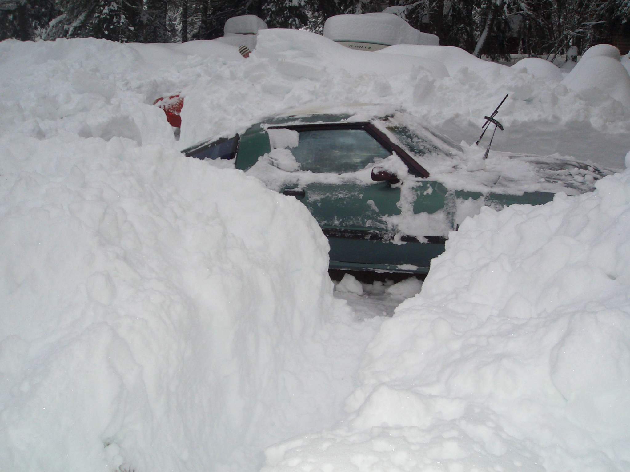

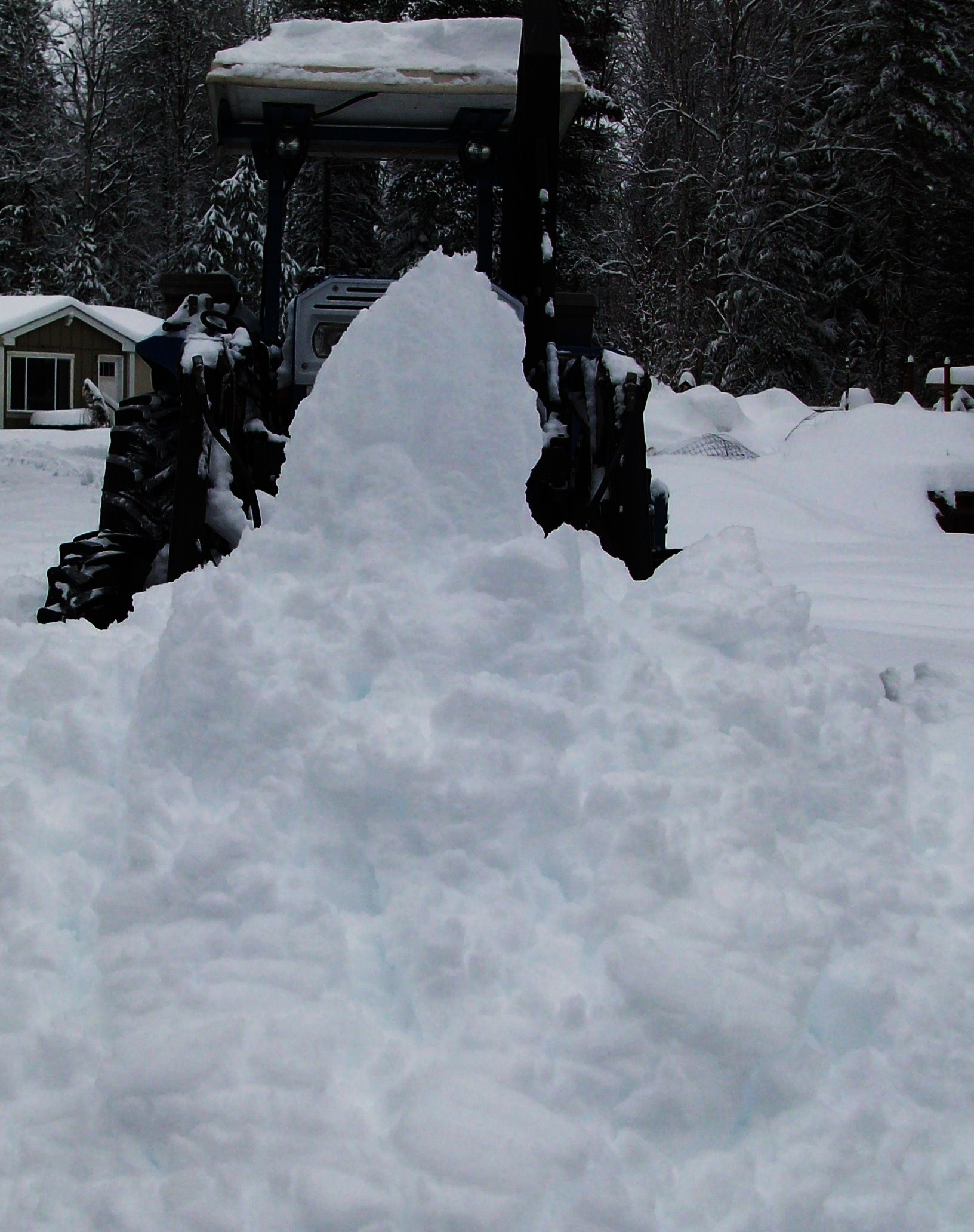

N idaho?? here are pictures from a few years ago... the tractor one is from this previous winter and the other from around 08-09.
i would hope you are also getting a standard fel and bucket for your Kubota -there are times it may come in handy, in addition to the blade. congrats on the new tractor - you will love it:thumbsup:

Regardless of snowfall in inches high winds can multiply this greatly. I would recommend buying some chains. And buy them soon. 'Tis the season when sellers of tire chains are selling out now until next season.

yes- around Silverwood there is less snowfall than farther north ( where we're at)- in general.
With the back hoe weight and loader / plow you should be in good shape. I agree with whistlepig that having a set of chains for some extra traction is a good idea- just in case the snow gets deep before you can get out to plow it.

I think you will definitely want chains. It was surprising to me how my BX with turfs would get pushed around by heavy snow- even if it wasn't too deep. The backhoe will help get you unstuck but it does take weight of the front and hurts your ability to steer. If you have another vehicle that can help you get unstuck I would leave the hoe off in favor of a normal weight implement like a box blade. For snow country like idaho I think might want to think about a blower later on. A BX with blower and chains would be unstoppable and a blade with no power would get old pretty fast
