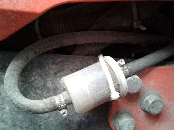

The BX's have a fuel filter in front of the hydro cooling fan. Had same problem as landrand with mower deck locked into TOP position. Real hard to get heat gun on filter. Bought 6' of fuel line, clamps and a splice to mover lower filter in front of FEL mount
and use power service on a 50gal tank

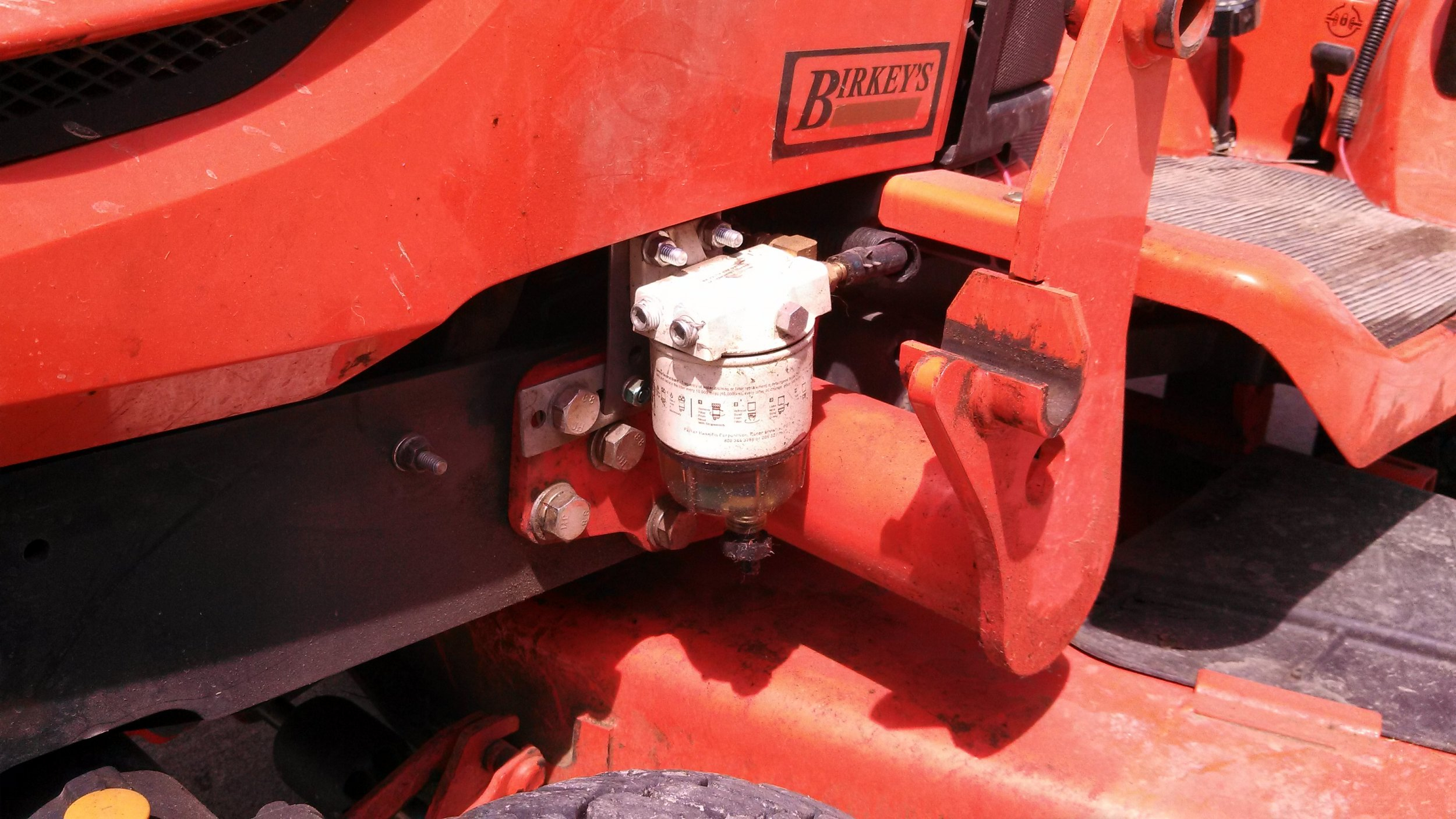

I added this Racor to mine as shown and eliminated the one near the back of the tractor. This one still gelled on me but at least it was easy to change and you could clearly see the problem. One thing that I always thought is the fuel filters, no matter the setup are hanging out in the cold air where the fuel tank is a larger volume and would take longer to get cold.
