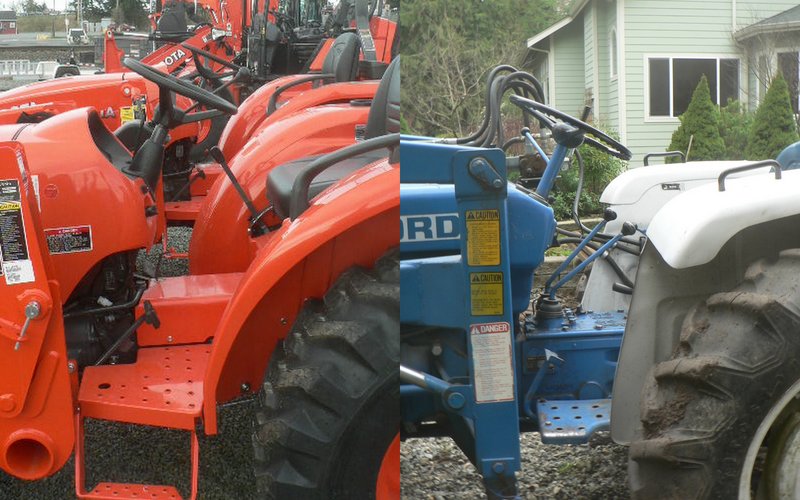

TheMadOne: I know that one can get carried away with the options, but what I did not say in the original question is that my goal is to get any option that may help when I am in my seventies. The ONLY reason I am buying a new tractor is simply ergonomics- I hate getting in and out of my Ford 1700 with size 14 boots, see attached. I usually buy something and figure I will go aftermarket for this and that, but for once said forget that. I am ordering any option that I think will have any value later on. I think I'll even take the hit and trade in my tractor, instead of selling it myself.

I own a L3301, I can say with certainty that it's better than the 1700 for ergos, but I still struggle for foot room, especially on the right side. You're fighting the brakes and rocker pedal for space, with a very awkward parking brake location as well. I don't know if your locked into the L2501, but sit on a L3560 and/or B2650 if you can, and feel the difference having the brakes on the left makes. I wear size 15s, for reference.
Also the middle hump is more prominent than you think, coming off an old tractor. As I got used to the tractor the hump went from a minor detail to a downright annoyance.
