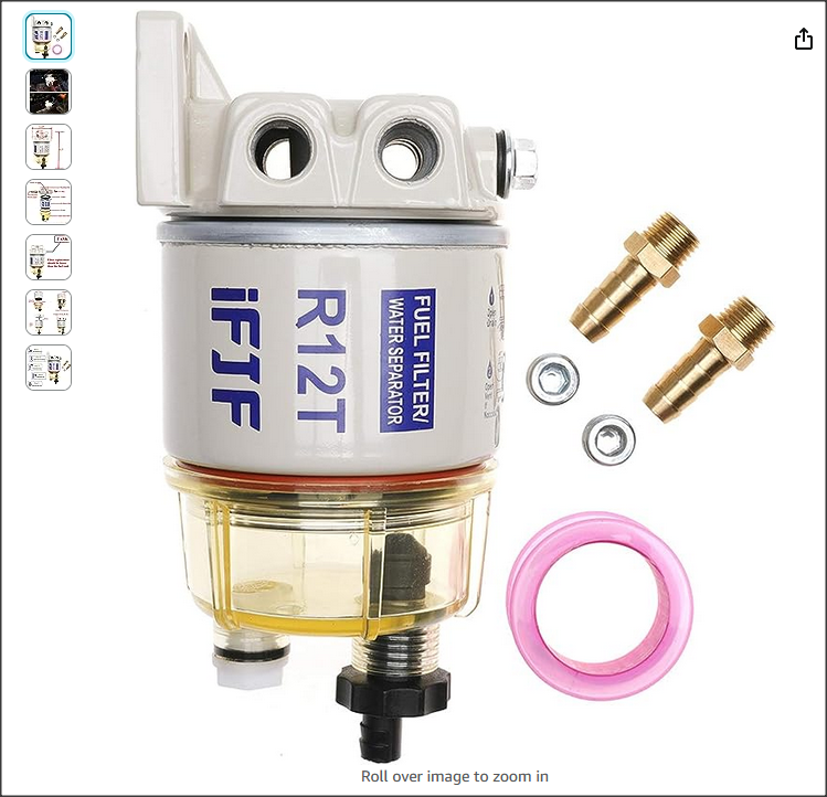

This time, buy the Chinese Racor clone and install a genuine Racor element like I did. ..................snip.......................
They are cheap that's for sure, but be aware that they do not have NPT threaded barb fittings, which is OK as long as you plan on using the barb fittings that come with the chi*com RACOR clones.
NPT 90* ell etc. will not fit without some adjusting (re-tapping ?) which is not a big deal for most of us I think.
Cheap clone:

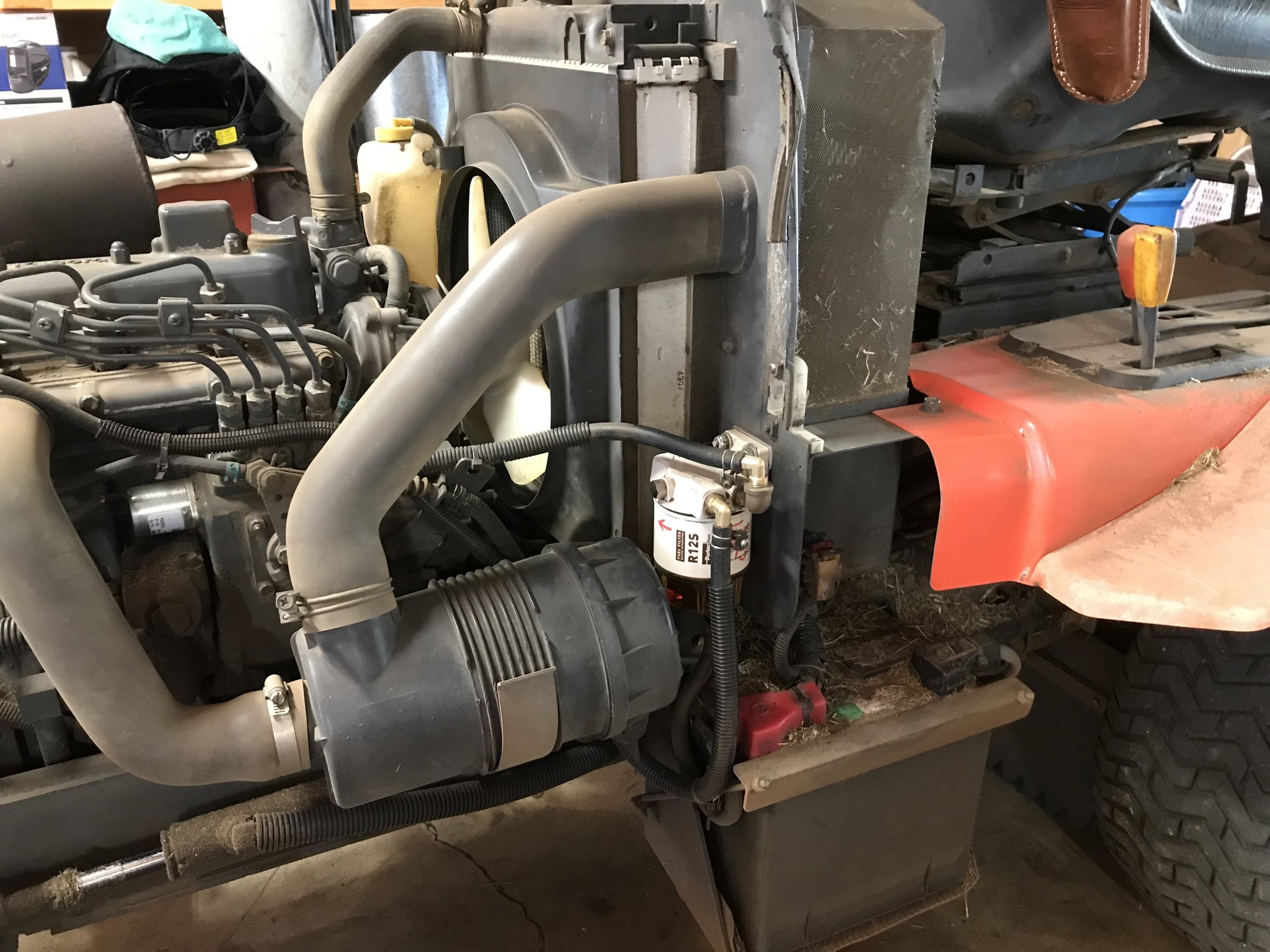

I replaced the secondary filter on my F3060 with 2 micron filter had both filter housings on my shelf - ended up using genuine RACOR for this reason.
RACOR in F3060:

First thing I did was toss the IFJF filter and replaced it with a Racor even though the reviews I've read on various websites say the the IFJF cartridge is as good as. I don't trust reviews today, too many biased reviews anyway.
Far as the fittings go, I just chucked them in one of my engine lathes and reduced the OD to the ID of the supply hose plus .030, no big deal and as far as the barbs go on the fittings, really not needed as there is no positive pressure in the fuel lines or the fuel polishing unit, it's all negative pressure produced by the fuel pump on the engine.
I did find some of the 'reviews' entertaining. " the fuel bowl melted". Of course it did. It's a Diesel filter not gasoline. The stupidity of some people amaze me.
Finally, I see you can now buy the clone bases with a purge pump built in which will eliminate hand priming of the filter entirely.
Both mine are mounted to the loader upright that is attached to the tractor frame but protected by the upright itself and easy to see as well as drain the bowl and change the filter. Gonna put one on my diesel pickup truck as well but that one will be frame mounted.

Just for the record - F3060 fuel system is little different with the primary filter being on the suction side of electric fuel pump, and the secondary filter is on the positive pressure side.
No idea how much pressure there is, but it must be pretty low.
