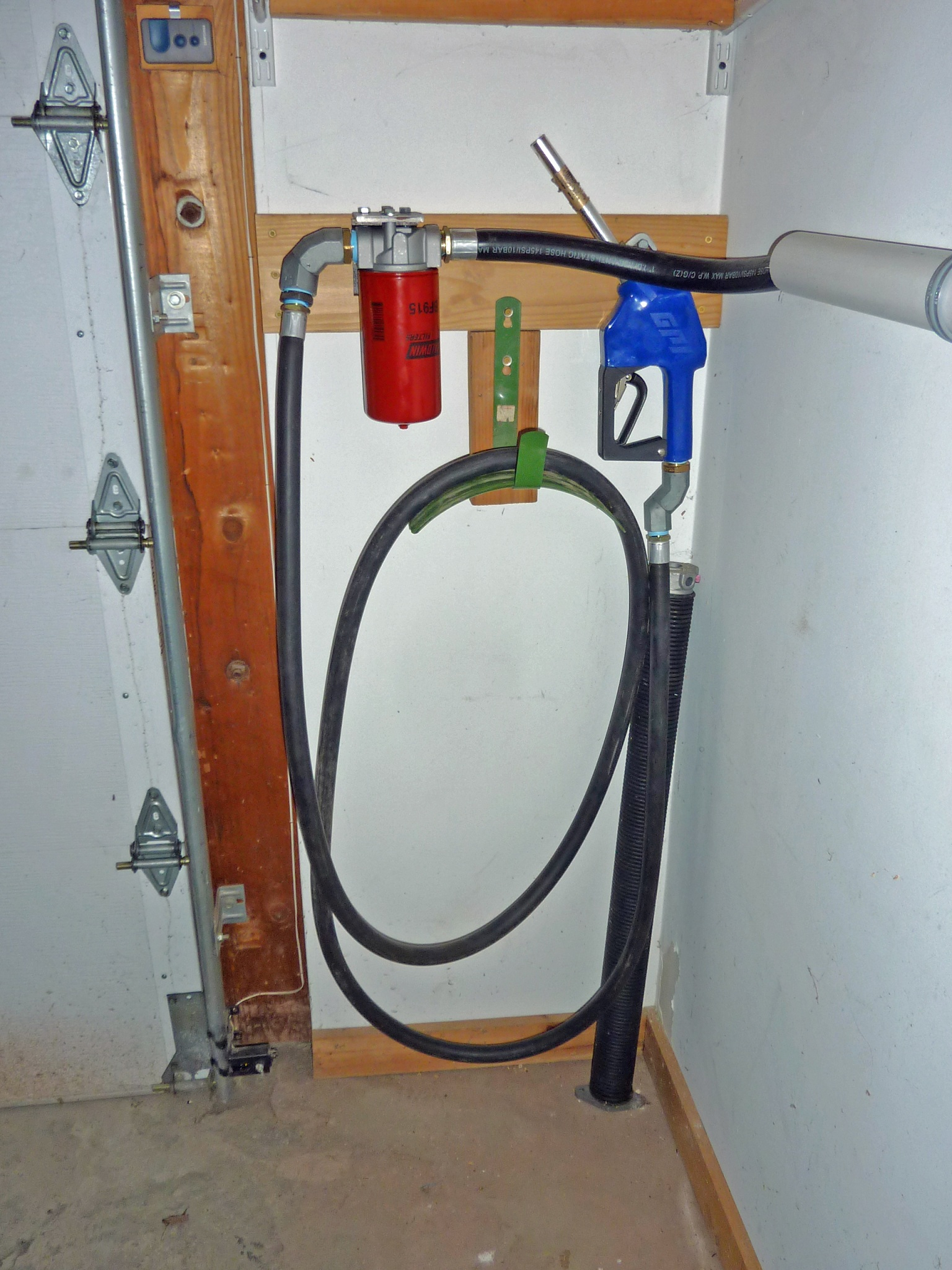

I had two Kubota tractors in the 1990's that came equipped with these drop in filters. They work well for keeping out leaves, twigs and small rocks but they let the fine stuff through. I still had to replace the tractor fuel filter a couple of times a year.
I use fuel oil and depending on the source, it can be fairly dirty. Eventually, I began using an in line filter in the fuel filler hose.
I replace the cartridge filter once a year and now get 4 or 5 years out of a tractor fuel filter.

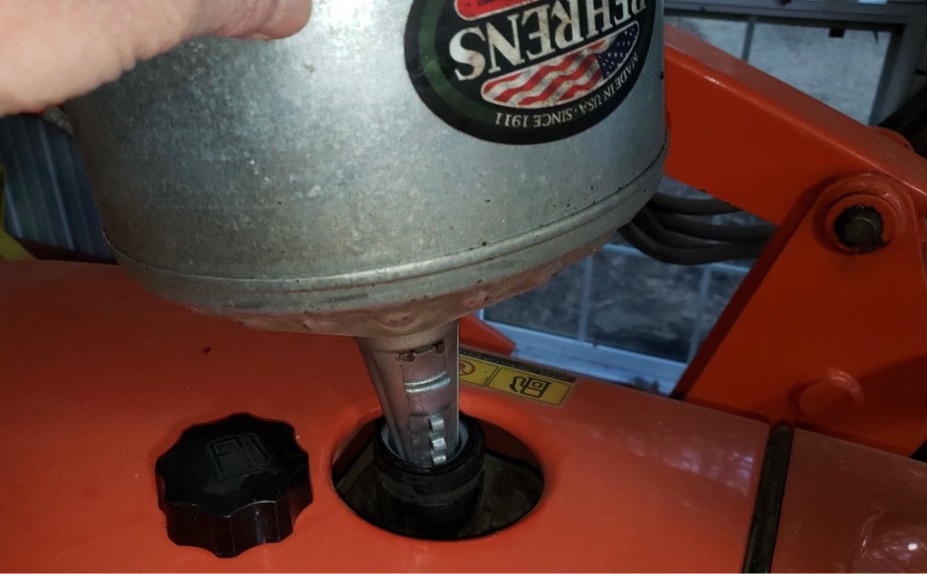

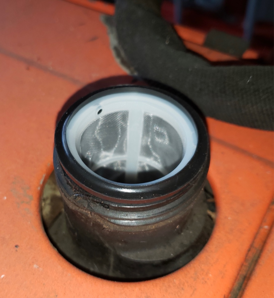

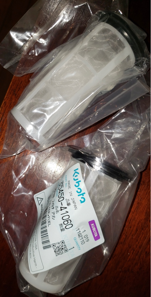

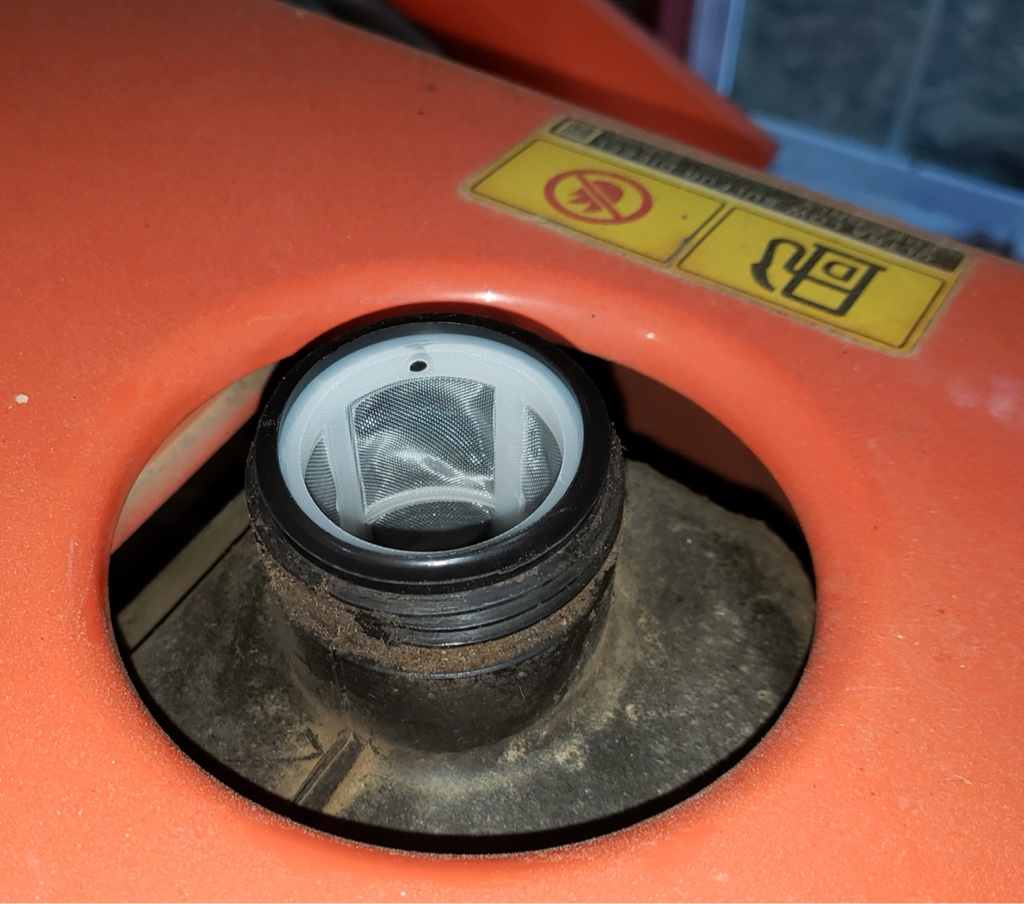

So I bought these from Messicks and they arrived today. They fit fine on both my L2650 and my L3200. I’ll need a way to seal them somehow as when I put my large funnel in it it wants to fall over.
But they’ll be good for when I drive them down the road to get diesel at the gas station to strain any crap out coming from the pump.
