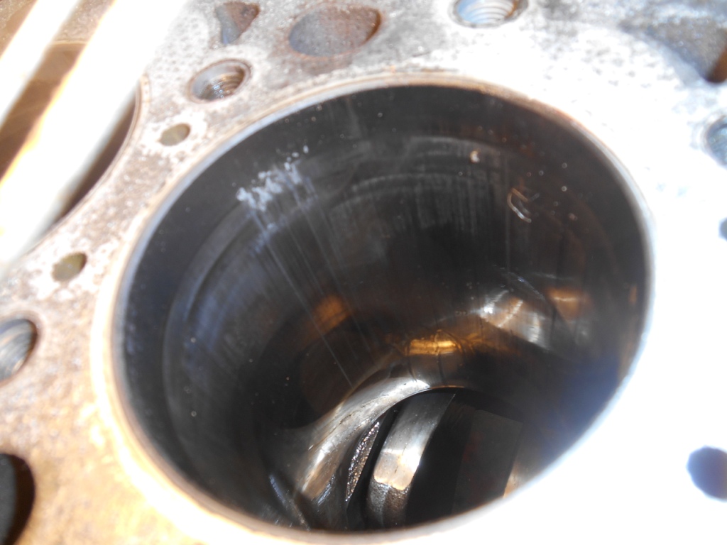

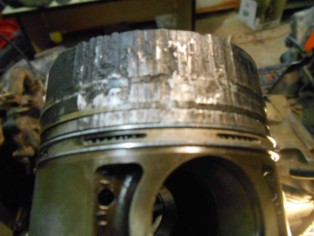

Today I removed the engine head and finally discovered what was wrong. The third piston partially melted on the cylinder walls. Exhaust port was wet with unburned diesel as opposed to3 other ones. I removed the piston and the rings were still in one piece. There is very ligh scoring on the cylinder walls but my nails will not even catch. The biggest issue is the aluminium from the piston that is now stuck on 2 spots on the upper cylinder part. My plan is to try to remove the aluminium and use the stone to lightly hone the cylinder in place. I would then throw a new oem piston witht new rings. The engine head seems in good shape but I will try to find a straight edge to check for flatness with filler gauges. Does anyone have a trick to remove the aluminium off the cylinder walls? I know that with chainsaw one can use muriatic acid with some Q-tip and some light stoch brite. Any thoughts on the plan of action above? Any help/ opinion is very appreciated. For those who wonder, this tractor is mostly used for light duty work 200h a year mostly rototiller in summer, and logging winch in winter. Cheers

I wouldn't be surprised if the other cylinders/pistons show damage as well. I don't think a hone is going to fix that.

Is there damage to the cylinder or just melted aluminum? It its just melted aluminum you can try the trick with acid to remove aluminum.

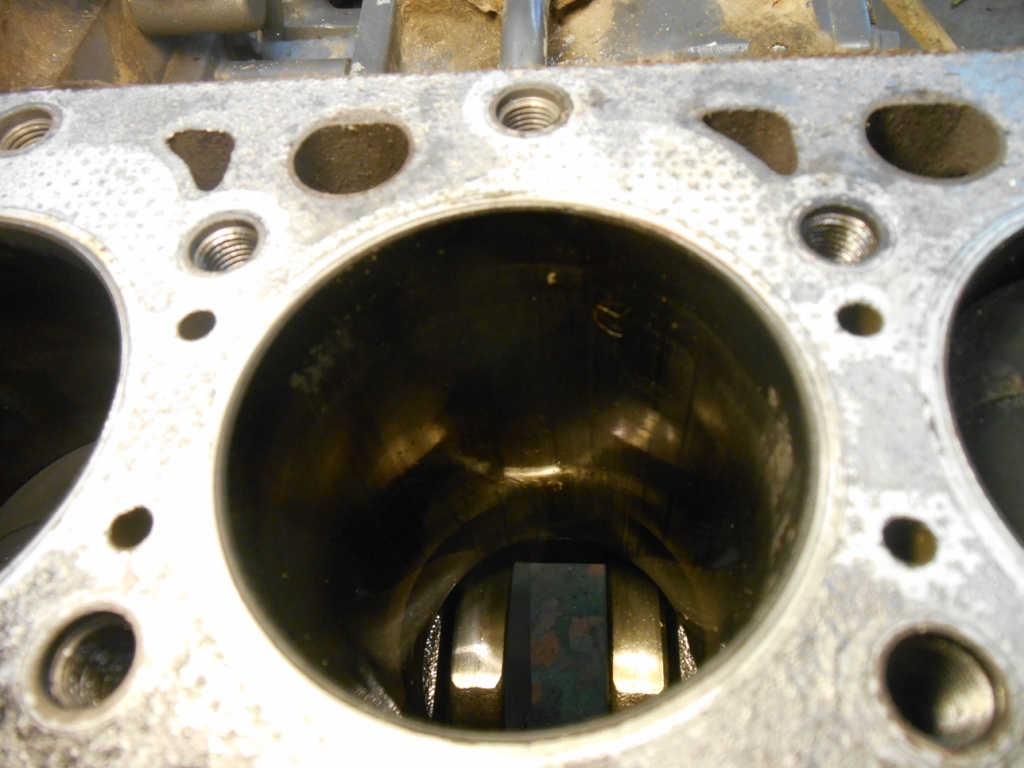

It was just melted aluminium on the cylinder wall. This morning I cleaned the cylinder. I tried the muriatic trick and it worked better than expected. After all the aluminium was gone, nothing would catch a fingernail. It looks better in real than on the picture below. Just for good measure, I removed the 3 other piston for visual inspection and they all look good. I did the ring gap test and everything is below 0.020''. As for the head, I cleaned all the leftover gasket and the flatness measures with a straigHT edge and a filler gage is well within .001''. I will just stone all 4 cylinders and try to find an oem 76.3 mm piston and ring and reassemble the whole thing.
After the removal of alu in the cylinder:

If you are honing all the cylinders, I suggest new rings on the old cylinders when doing the install. That way the will break in correctly. Rings are cheap insurance. Did you check the bearings? Again if you disconnected the rods from the crank as it looks like you did, just replace the bearings too. Its apart, so spend a few $$ and do the job right. Piece of mind is worth it.
One last thought - are the rod bolts reusable? If they used a crush washer for install torque, you should replace as some are a one time use item.
