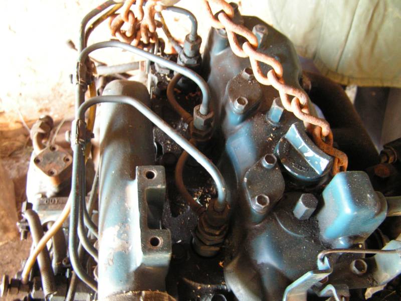

Hi,
I bought a prototype of czech tractor, where Kubota engine is in. Can you help me with exact identification of the engine? I want to know that before I need some spare parts.
It water-cooled, 3 cylinder, diesel, production year about 1994. It should be "1229R5A" but it's not a true type name that can be found on web pages.
See attached photos.

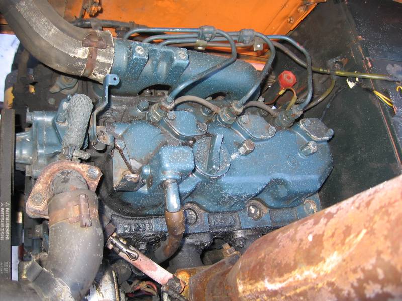

Welcome to TBN!! I can't make out an ID from current pictures. My B2400 has the engine series number cast on the block and it's located just under/behind the exhaust manifold area below cylinder head/ block mating surface. Yours is probably over 17hp as I see it has a water pump. the B7100 ( 16hp) 3cyl diesels do not have a water pump and rely on the Thermocycle principal to cool.

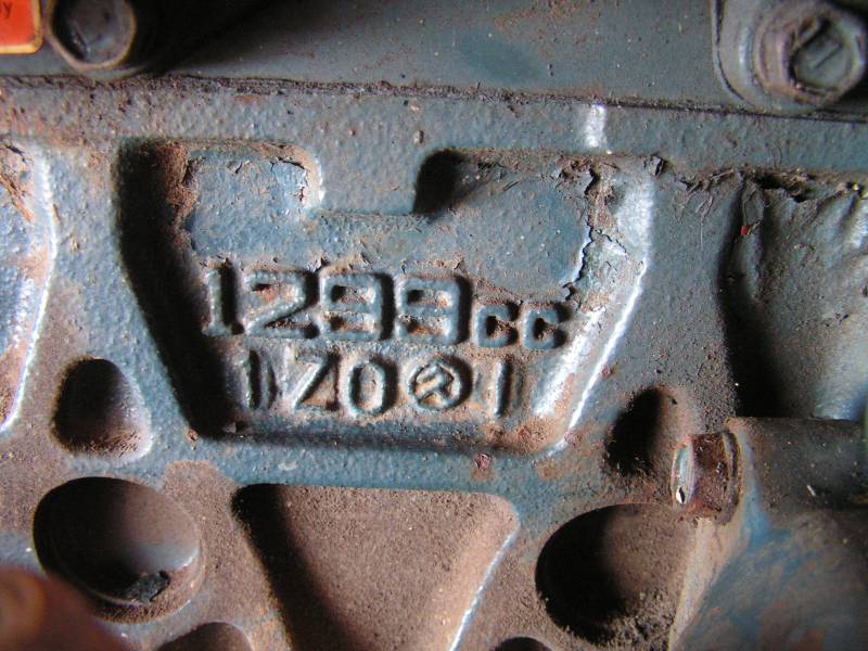

Yes, it can bee seen on last photo: "1229" and "K5A" (on the edge of the block near exhaust pipe). It should have 32 or 36 HP. I guess it can be "D1703" but I'm not really sure how to confirm that.

As you can see, there is "1299cc" written on the block, so this means that it's not D1403 (1393ccm) neither D1703(1647ccm). :( So it has to be older. As I said the tractor is 1994 so the engine can't be younger.
/ Kubota engine identification
news: 1299 cubic cm has 3 cylinder engine D1301, D1302. Any idea where to find differences?

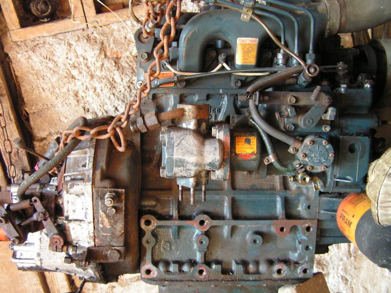

:D I found the serial number. It was just at the injection pump. The engine is D1302-26014. So it should have about 27 HP.
Have you any idea where to find workshop manual and parts catalog? (That's not on kubotabooks.com) It's 02 series engine.

Keep in mind that the D1302 only tells you the # of cylinders, the CC, and the series. What that means is that when you order parts, you must be careful because all you really know is the block and bore size. I have seen (admittedly not very often) these engine have different heads (DI on 1, IDI on another), different fuel pumps and fuel pump locations, different cooling and charging systems, different pistons, and even different oil pans. In most cases, most of these engine are the same. However, some times the vendor ordered them with something "off the wall". The best thing to do is find a KEA (Kubota Engines America) dealer to get parts, not a Kubota Tractor dealer. At least till you can verify that it is the same as the Kubota Tractor engines anyway.
