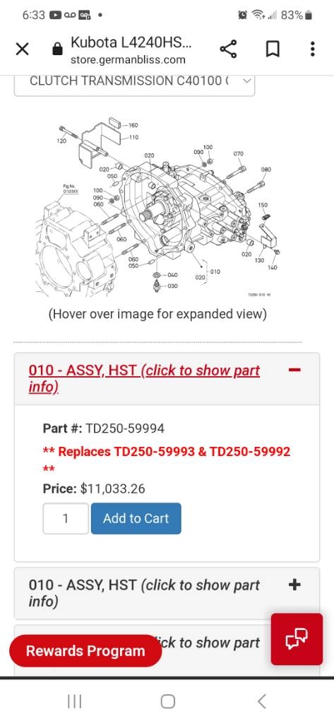

"Needs engine rebuild" makes it sound like wear and blow by/oil consumption; not donor block. Probably while it's apart, might want to do injectors, ect; and If you have the ability and time, this might be a $1500-2500 job, and a few weeks of nights/weekends. I would still want to pay less then $5k, just for the possibility that there is more wrong then you expect, or your forced to call in professional help. Is there a way to confirm transmission is intact? Looks like that is an $11,000 assembly
