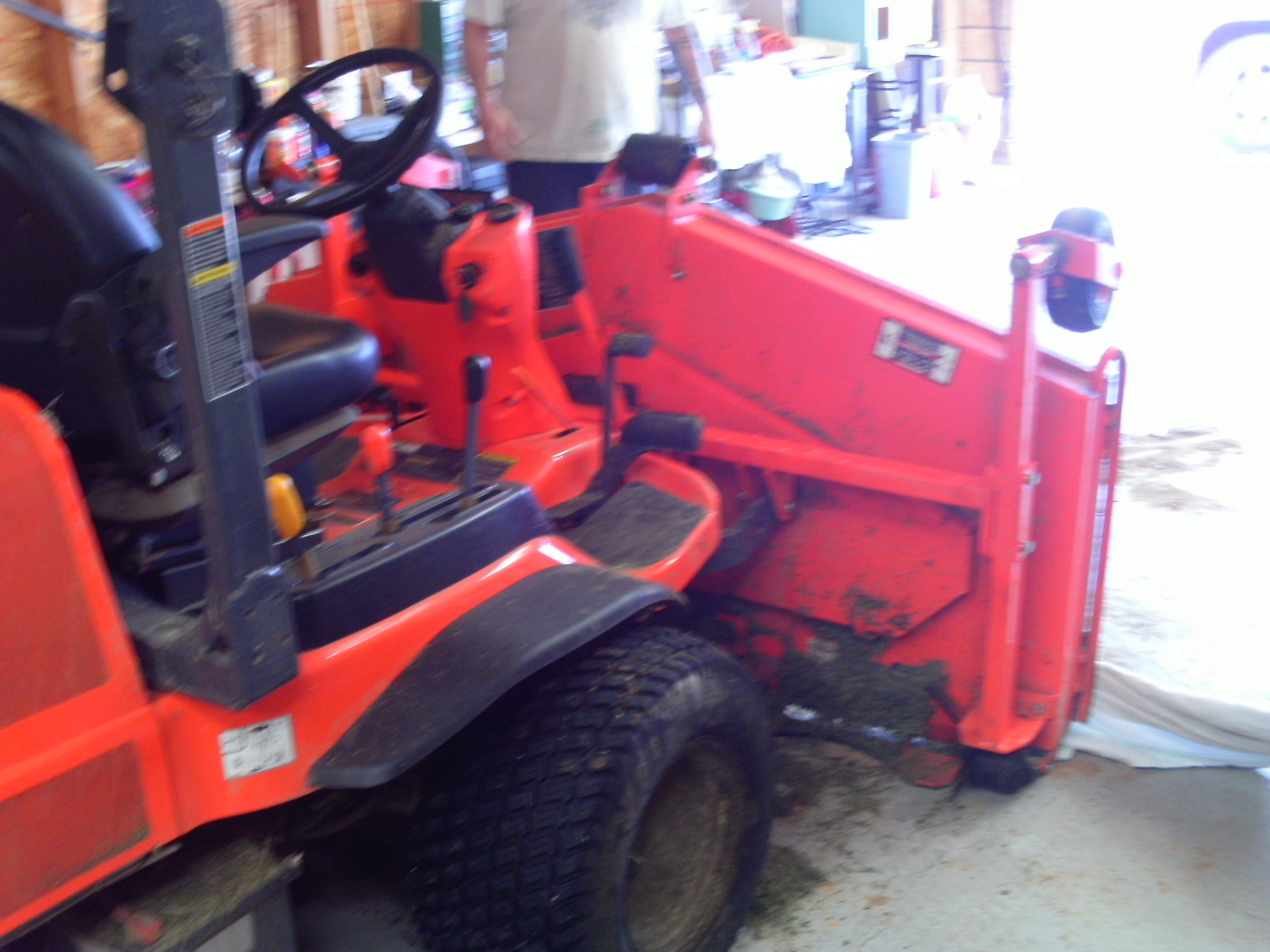

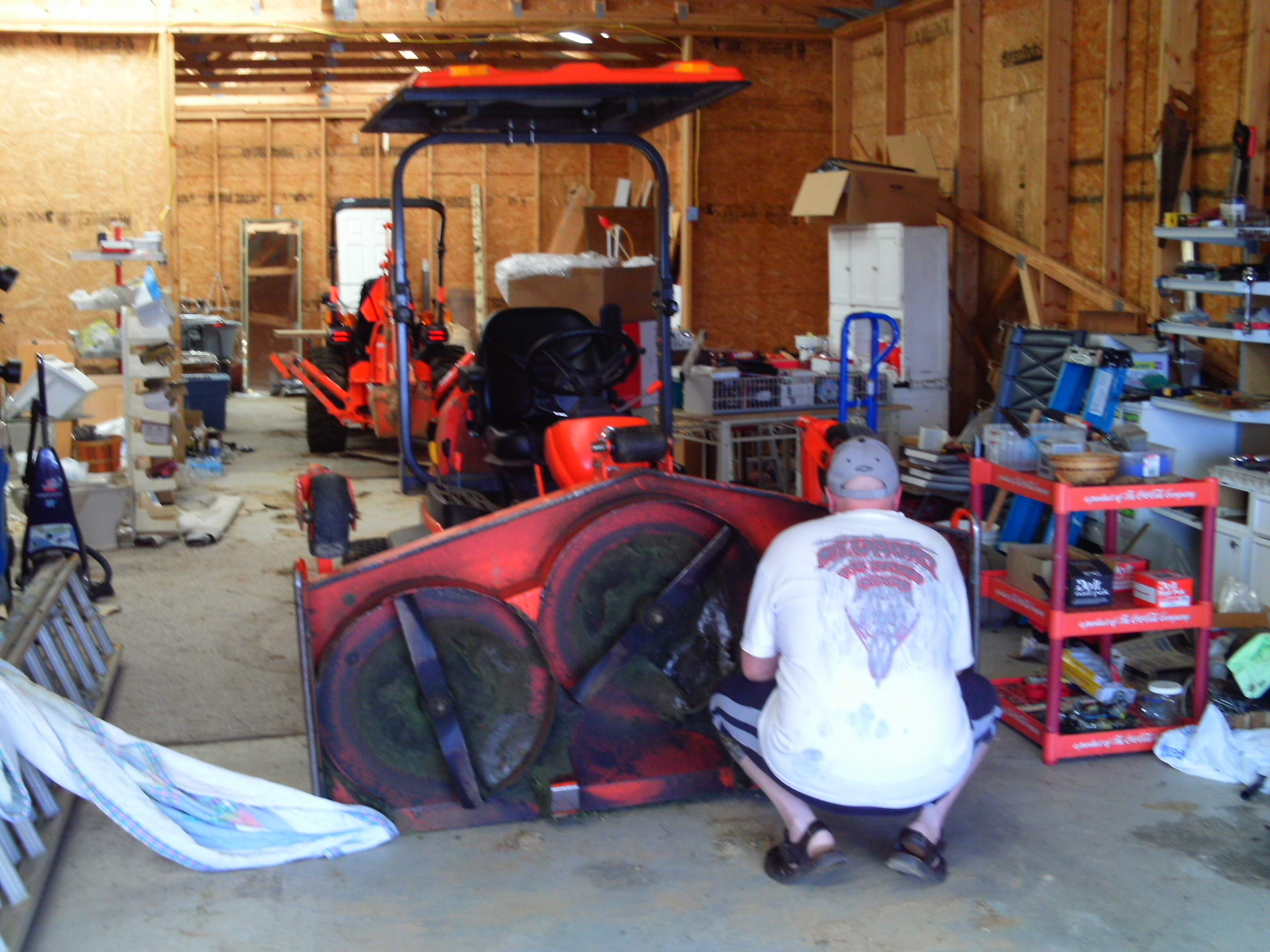

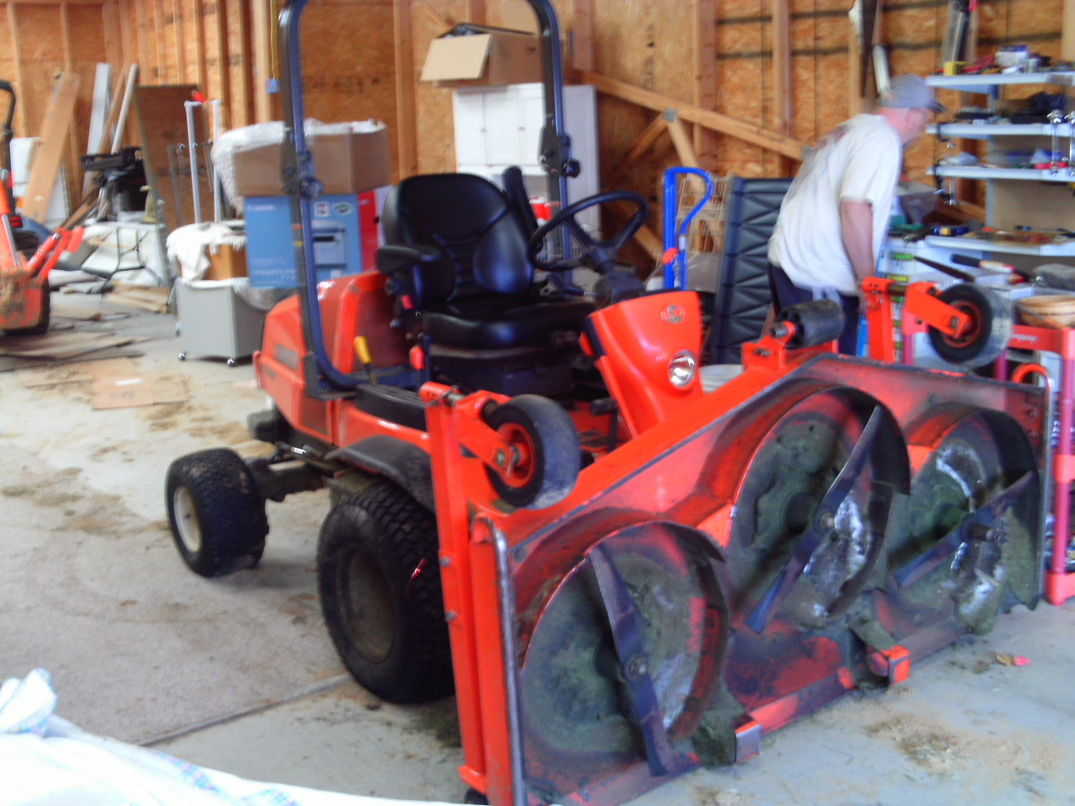

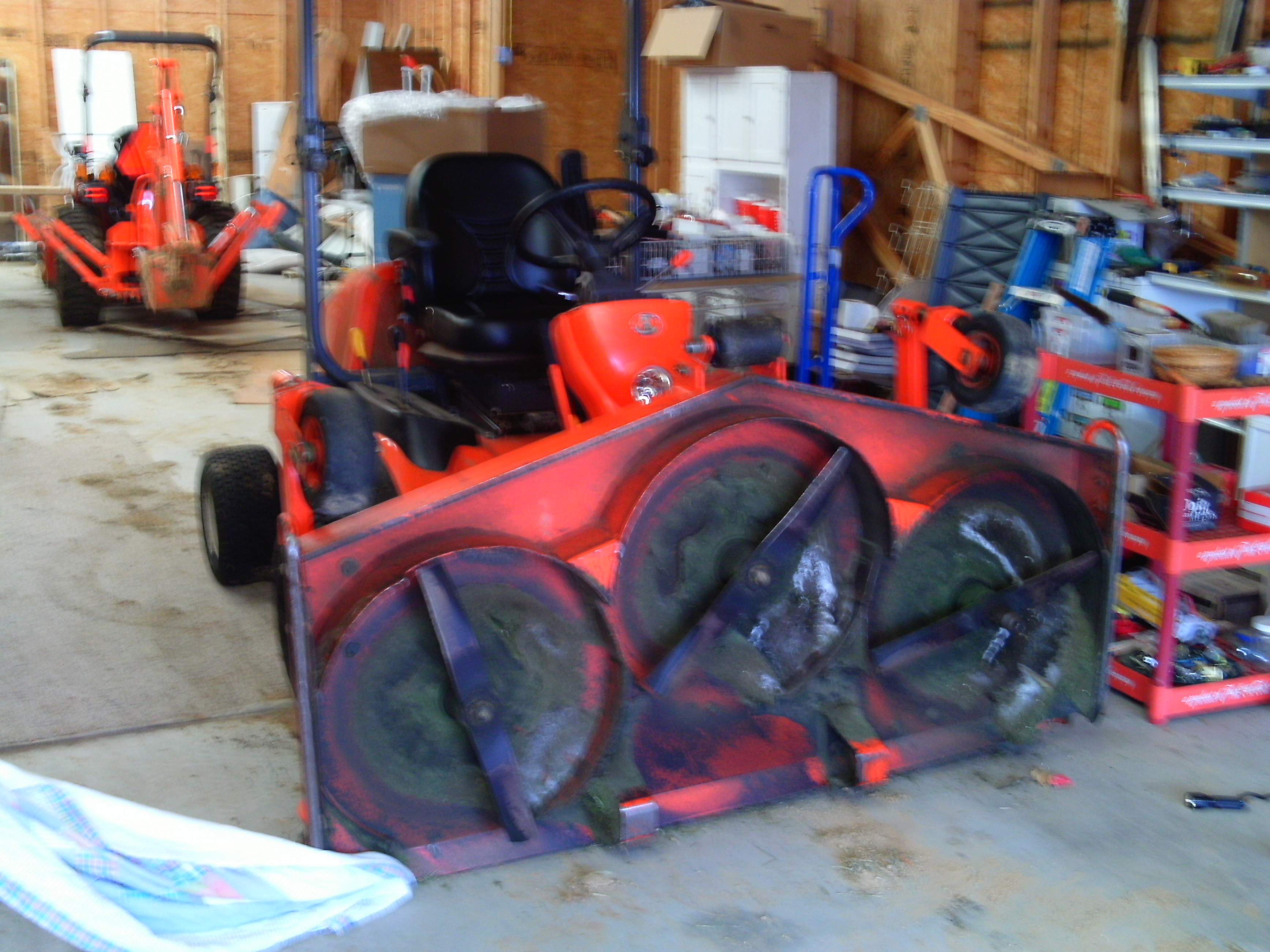

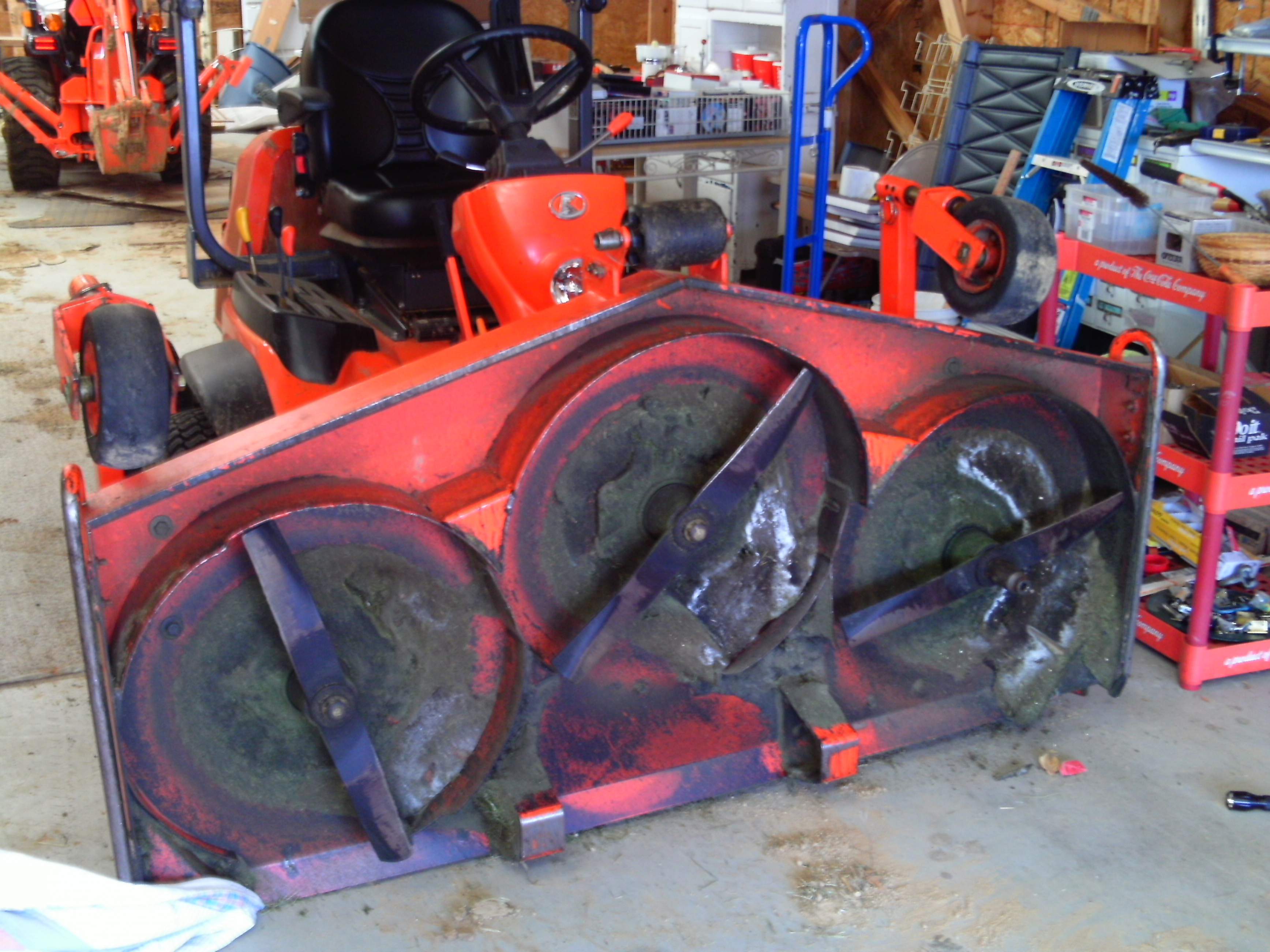

Some pics of front deck attached and standing up for blade replacement/sharpening. Not me in the pic, guy helping which I let him do since it was his 30MM socket and my air wrench.:D

That is one of several reasons I want one.
That rear discharge in effect has an opening for every blade....did not visualize it that way.

Glad to give you a picture of the real thing. First time I ever raised it and feel foolish that I hadn't done it before with it being as simple as it is. I can say that after spending 20 minutes trying to figure out why I couldn't raise it and even disconnected the drive shaft thinking that may be what was holding it down. It was 2 pins that are spring loaded that have to be pulled to release the back leveling arms, pulled them and it lifted right up but of course had already pulled the 2 pins on rear anti scalping wheels that released them to float and pulled the lever and pulled the pin that lets it automatically lock up when it reaches a certain point standing. Sounds more difficult than it is now that I've done it twice in a couple of days on both decks.
