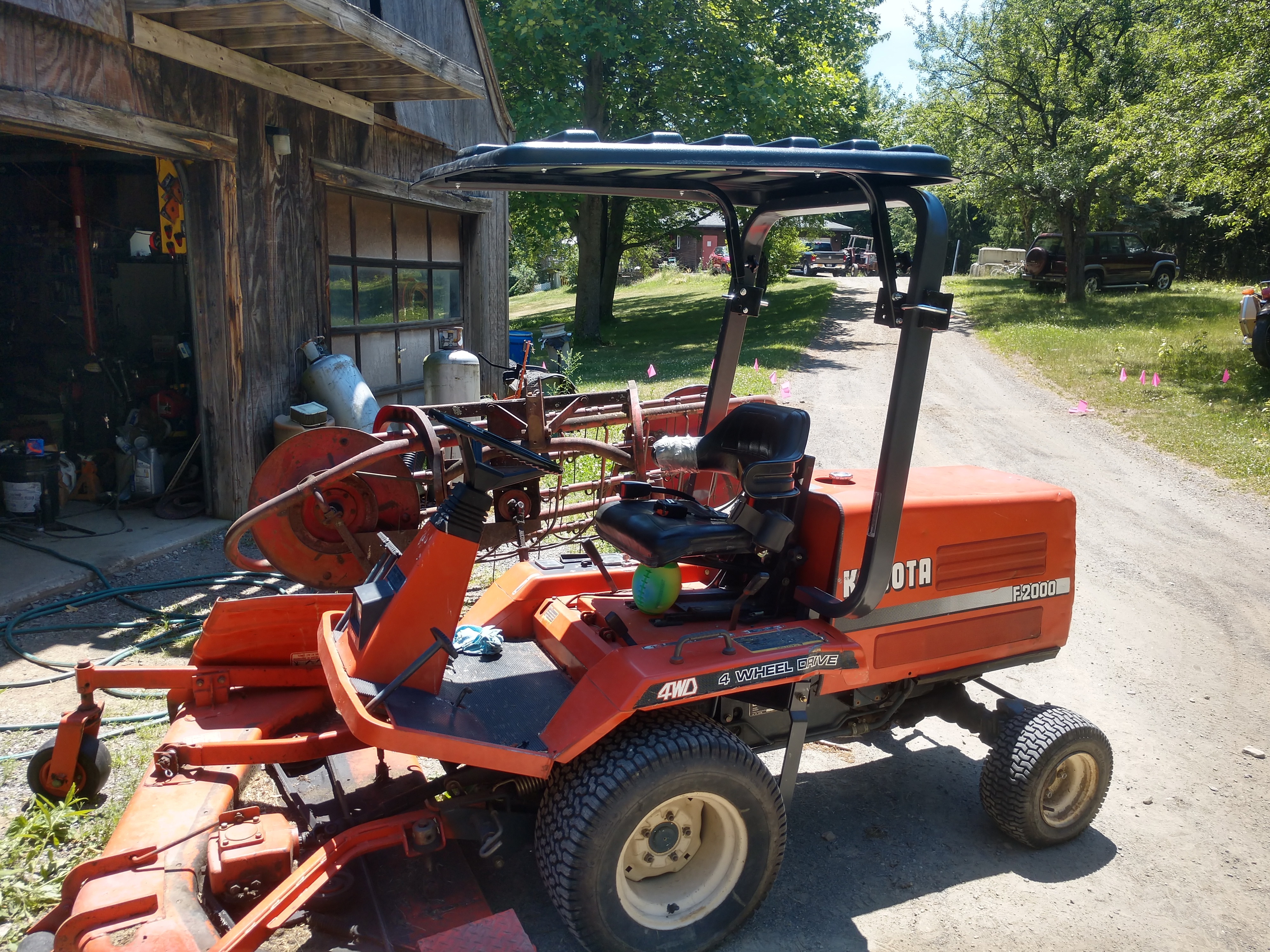

Need to de-thatch (mind you, I have 'mowed paddock', not lawn as such) and was thinking of making an attachment to mount in front of the mower deck using light-gauge hay-rake or similar round spring-steel teeth at 3 to 4" spacing. Just want to lift the dead matted grass up to re-cut and scatter while mowing couple time a year. Anyone done or seen something like this??
Also been thinking of a hitch receiver for the rear.....be nice to see what others may have built.

There are lots of threads on light duty dethatchers but just not attached to the front of a mower.
   / Kubota F series #145
Sixdogs....I have seen a number of commercial and DIY de-thacher devices and gotten ideas from many......just went by the local farm equip dealer and picked up a double-spring-tine that I will see what I can design around. Was just wondering if someone had already done something closer to what I am thinking as a front mount? I have designed and built many things from my own head, but am not above taking good ideas where and when I can find them.

Rip-- know I have seen front mounted homebuilts but I can't seem to find them. I did find some three point hitch models but none that were up front. maybe start a separate thread looking for ideas and let them find you?

As Aczlan said, the F are really factory Frankenstein versions of the BX and B units, so completely different than the ZD or other zero-turns. Still not the best for towing as the back end swings around like a crocodile tail, but would still be useful for some things.....just have to work around the counterweight also, so was wondering if someone else had come up with a slick version? I can certainly (re)invent my own wheel though.
Will get to working on my de-thatcher soon as I get couple other little projects out of the way (including taxes).
