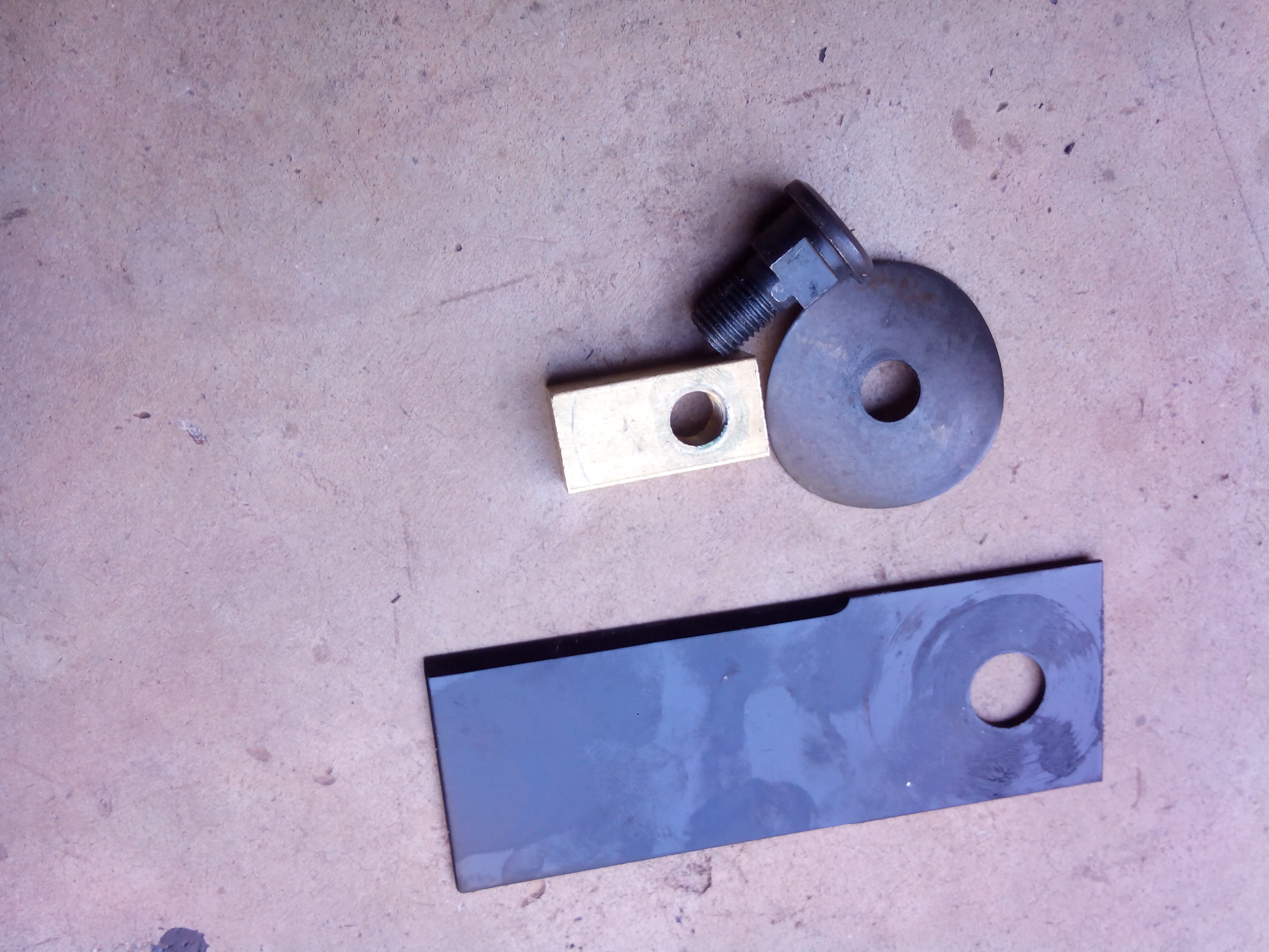

Have any of you F series owners ever considered or fitted swing back flat blades. I was told at the Kubota dealer that they used to be a Kubota option here but not these days unfortunately.
I am thinking of making up a set and see how they go.
Years ago I owned a similar style mower which had swing back flat blades which I was very happy with as even though it was a side discharge deck it would throw so much out the side but would also mulch do some degree.
The blades also cut cleaner, easier to sharpen and cheaper to replace from memory.
I had also bought that previous machine from the local City Council who I was told used to convert all their mowers from straight solid bars the the swing backs interestingly.

I started making the blade sets up yesterday. I am using and old set of worn blades and cutting them down to make the blade carriers. First obstacle was because they are tempered steel, makes them a bit difficult to cut and drill. Cutting wasn't too bad, the band saw got through them OK and I was using my worn blade that already has a couple of teeth missing so it didn't matter so much if it got a little more wrecked.
Drilling proved to be a drama, after getting the pilot holes done after several resharpening and lots of pig like squealing sounds, the 16mm holes for the blade bolts were just not happening. So I had to soften them. don't have an Oxy set or a forge on hand so I used my little TIG welder to heat treat the area which worked a treat and drilled much easier.
Today I will weld in a small side of each hole to key the bolts from spinning in the carrier holes, then try and retemper them which I hope will be just a quick quench immediately after the welding. Otherwise I will take them to a local spring works of something.
Yeah although the standard blades work well and they do incorporate a clutch style attachment to the spindles so that they can slip when hitting something solid like rocks, old stumps and other debris, I just think that the swing back blades are an extra level of protection. They are easier and cheaper to replace and a lot easier to resharpen.
The blades I am fitting are double edged and require no tools to fit or remove and cost about half the $$$ of standard blades.
So as long as the mowing action and finish are good I will be happy for my trouble.

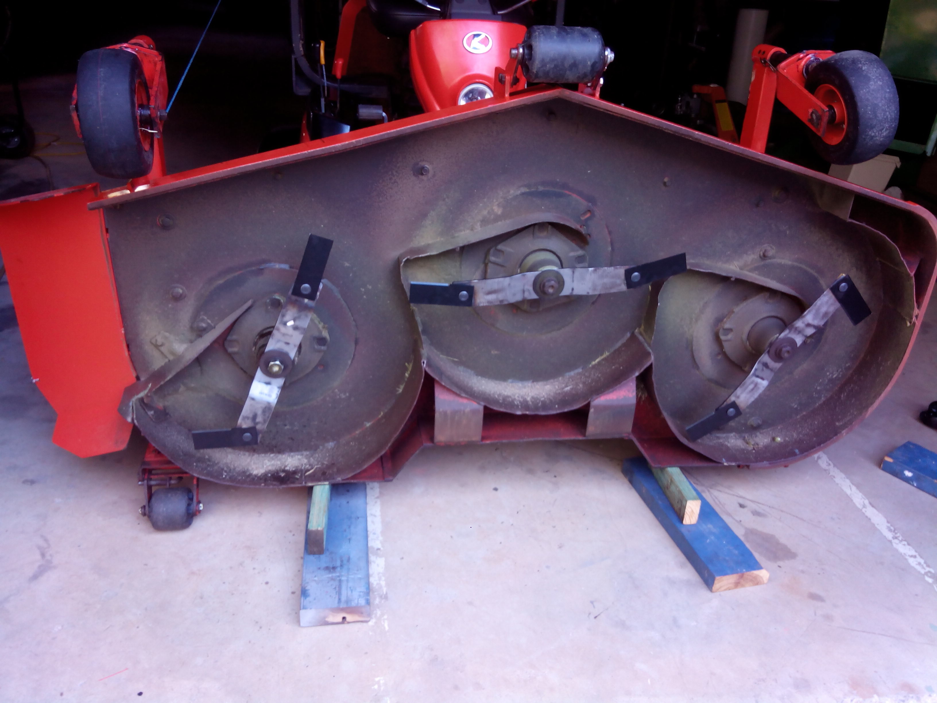

OK I finished them off today and yeah I made sure they were adequately balanced. I set up a jig so that they were all cut at exactly the same length and did the same for drilling the ends so the blade carrying holes were exactly the same distance from the centre bolt.. tested once all assembled on a knife edge through the centre hole and all sat dead level.
Anyway I fitted them and took it out for a test run:
Pros so far:
Cleaner cut and still possible at lower RPM.
Noticeably less load on the engine and transmission.
Easier blade changes and sharpening if needed.
Cheaper blade replacement cost.
Mower deck seemed quieter.
Less clippings getting air born keeping me and the machine cleaner
Less impact on the drive system when hitting heavier debris.
Cons:
Blades would not be as robust but unknown at this stage how well they will stand up but their ability to swing back freely should protect them to a degree.
Some clumping of clippings at the chute when mowing in thick grass but should not happen so much as I mow more regularly. Worked better with the chute pulled fully open. I have used plain flat blades, fluted blades would no doubt throw better but I will stick to plains flat ones at this stage
Blades may need replacement more often being lighter gauge steel.
Now I will try and find out why Kubota withdrew the kit that they used to have available but for my purpose they seem to work well so I will run with them for a while.

View attachment 428158View attachment 428159
Thanks for pictures because I had no idea of what you've been talking about.:thumbsup::confused3:
