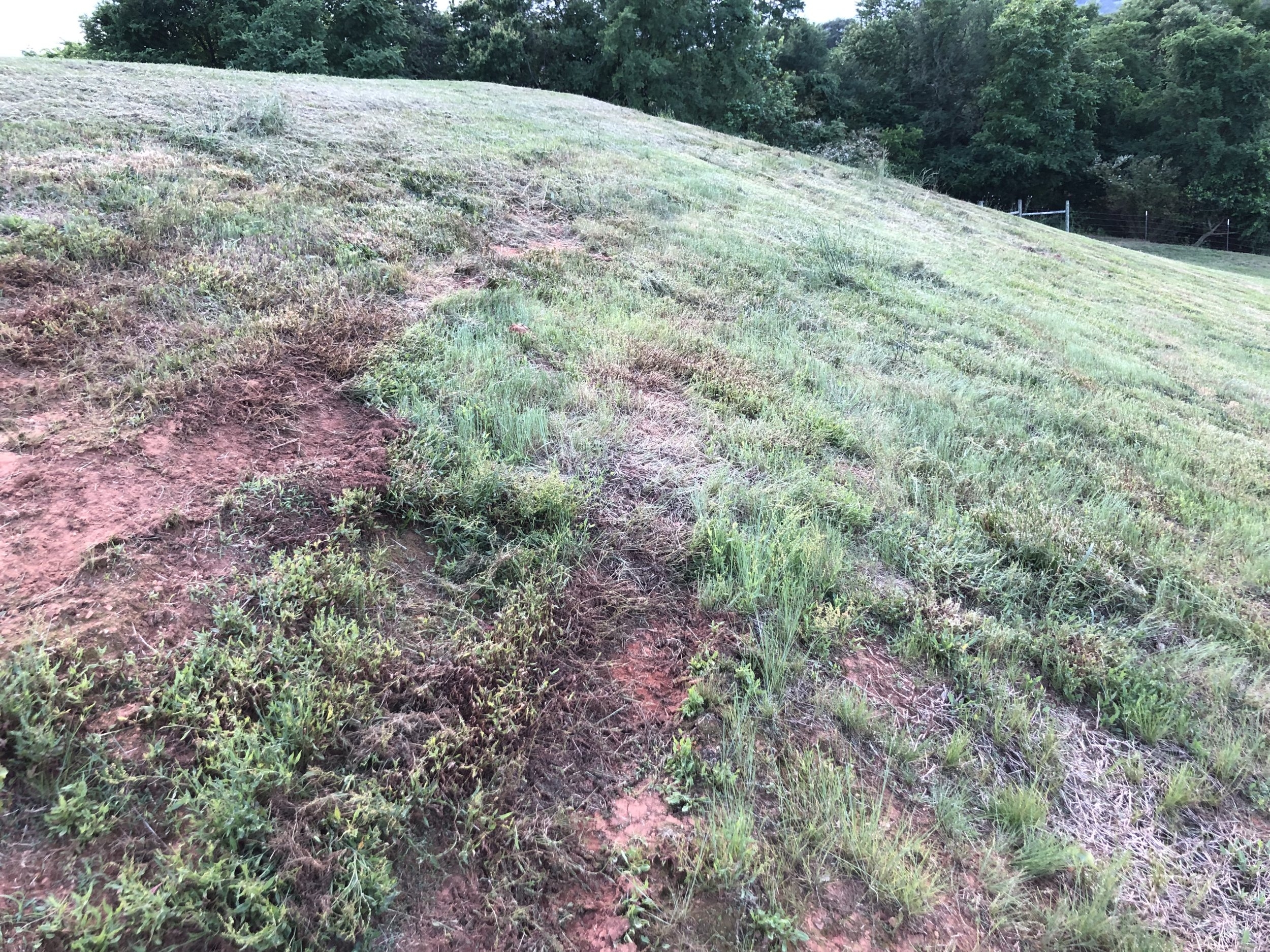

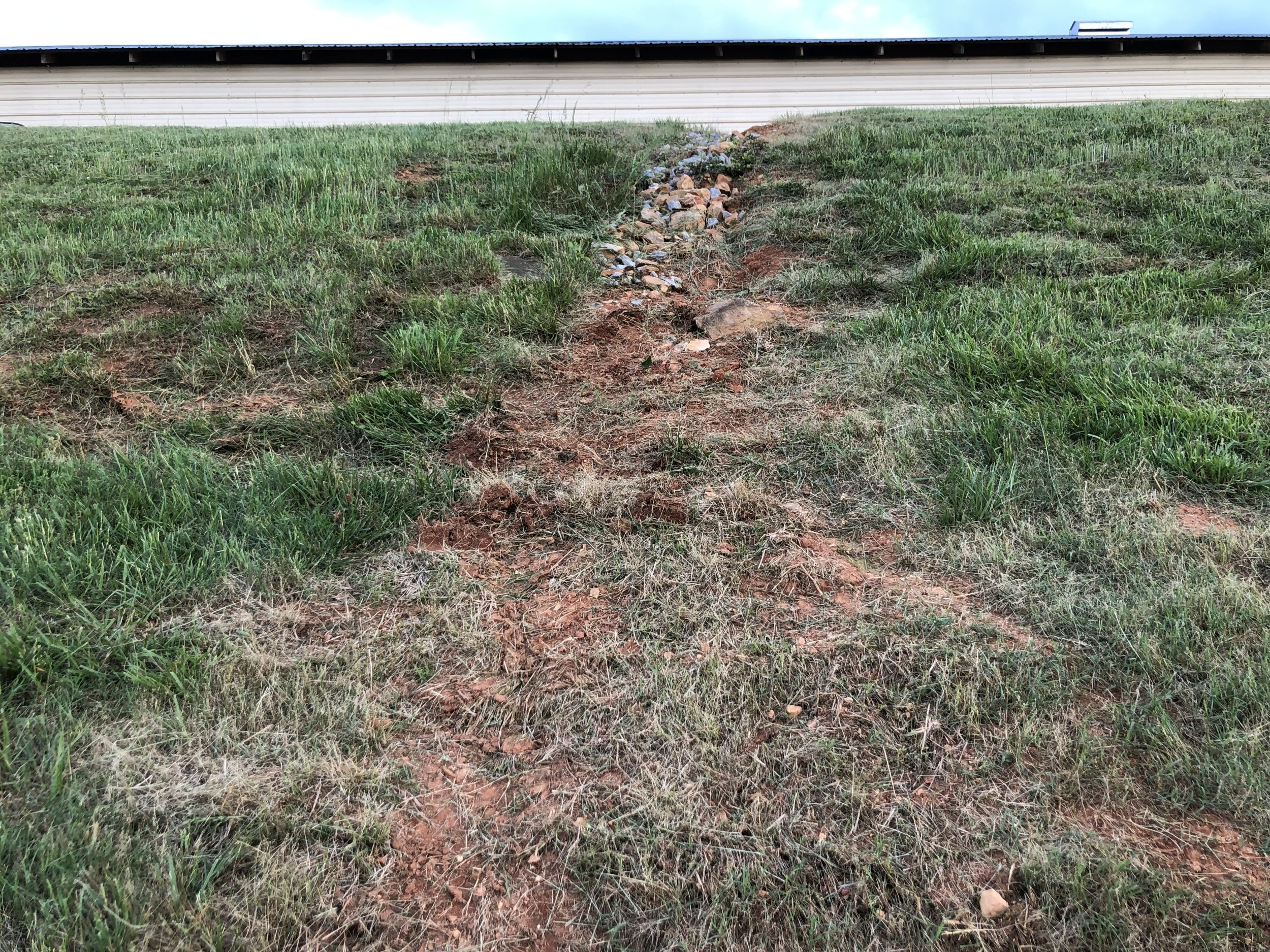

I have a unique, large customer property I am admittedly doing some damage to by a zero turn with bar tires. Turf tires will not hold on the hills. The property is steep and there are a decent amount of trees to cut under. On top of that, the turf is mostly weeds and grass mixed, so the root system is not all that strong. I知 getting a smattering of complaints about tire marks.
Is an F the answer to my needs? I missed out on a chance to get a 3680 72 last year.
Over the winter, should I make the switch?

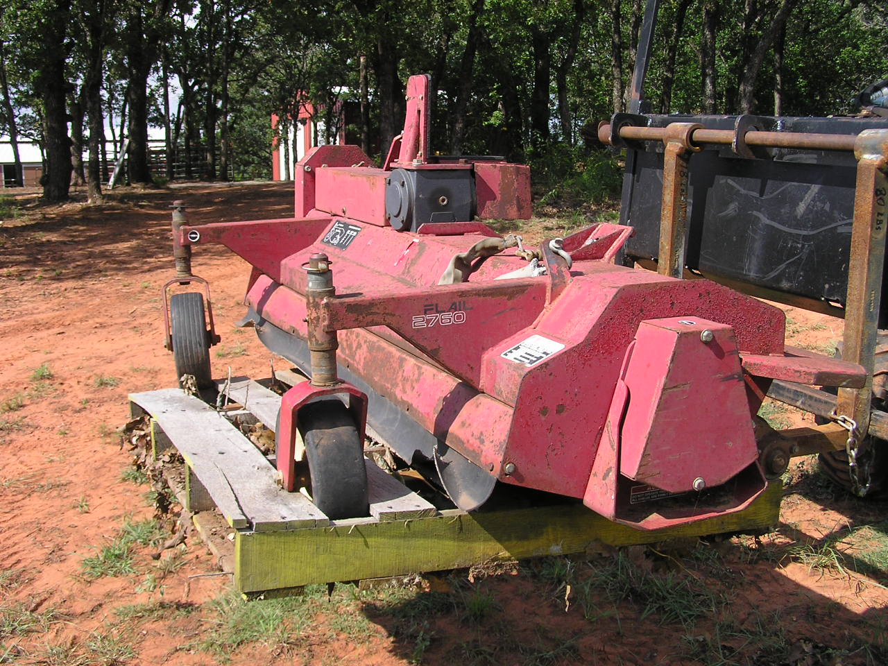

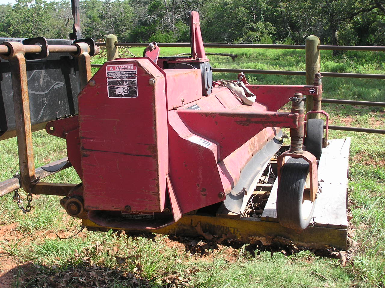

I am also looking at the flail mower attachment to open up another line of cutting options not available to the ZD331
The out front flail I have works good. The disadvantage is you can't mow up close on the sides.
If you are hand trimming anyway it wouldn't matter, but out here in the country I don't even have a weed eater.
