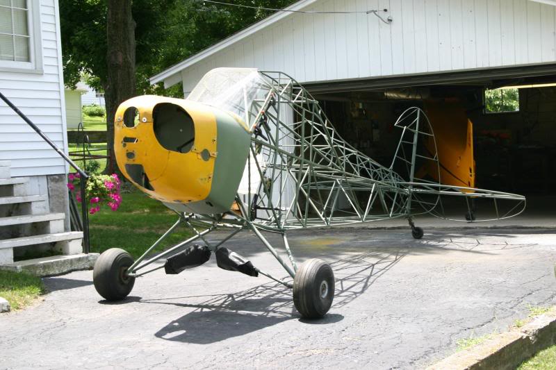

Having a lot of experience with automotive finishes, as well as commercial finishes and electrostatic painting, I can tell you that ANY paint that can be atomized, CAN be applied with electrostatic equipment.
I do own electrostatic spraying equipment, and have used it extensively.
An electrostatic sprayer works best, when what you are painting is metal and mostly air, like the Cub aircraft frame in this photo.
The other benefits are: (a) You can get a more consistent coating thickness, (b) Edges and difficult to reach areas get better coating, (c) Reduced overspray. (d) Reduced material usage.
Most of the paint sprayed with conventional equipment at a tubular assembly like this aircraft frame, is going to miss the tubing all together. Electrostatic spraying allows much more material to hit the target by applying a positive charge to the paint as it leaves the gun, and a negative charge to the frame.
