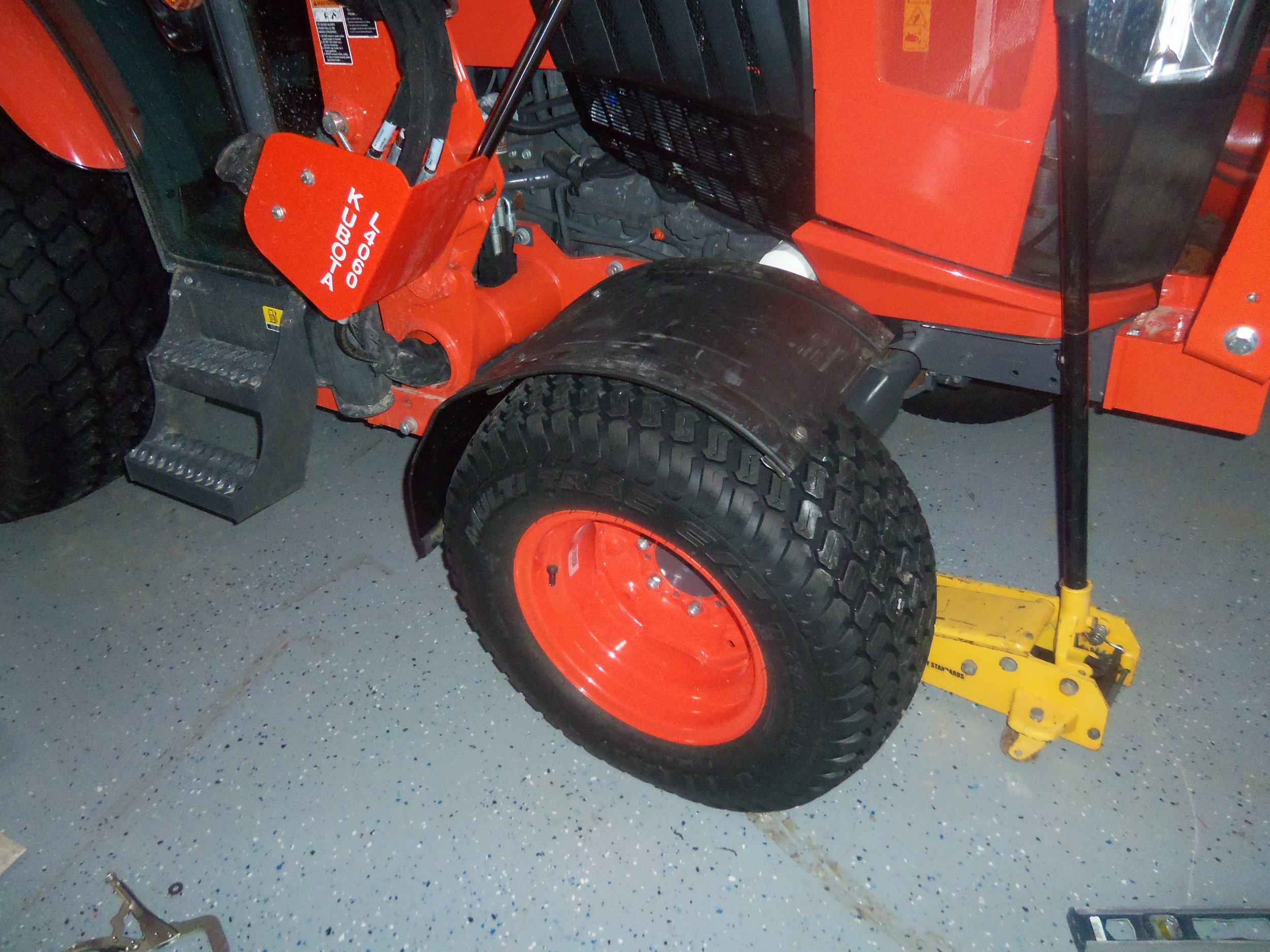

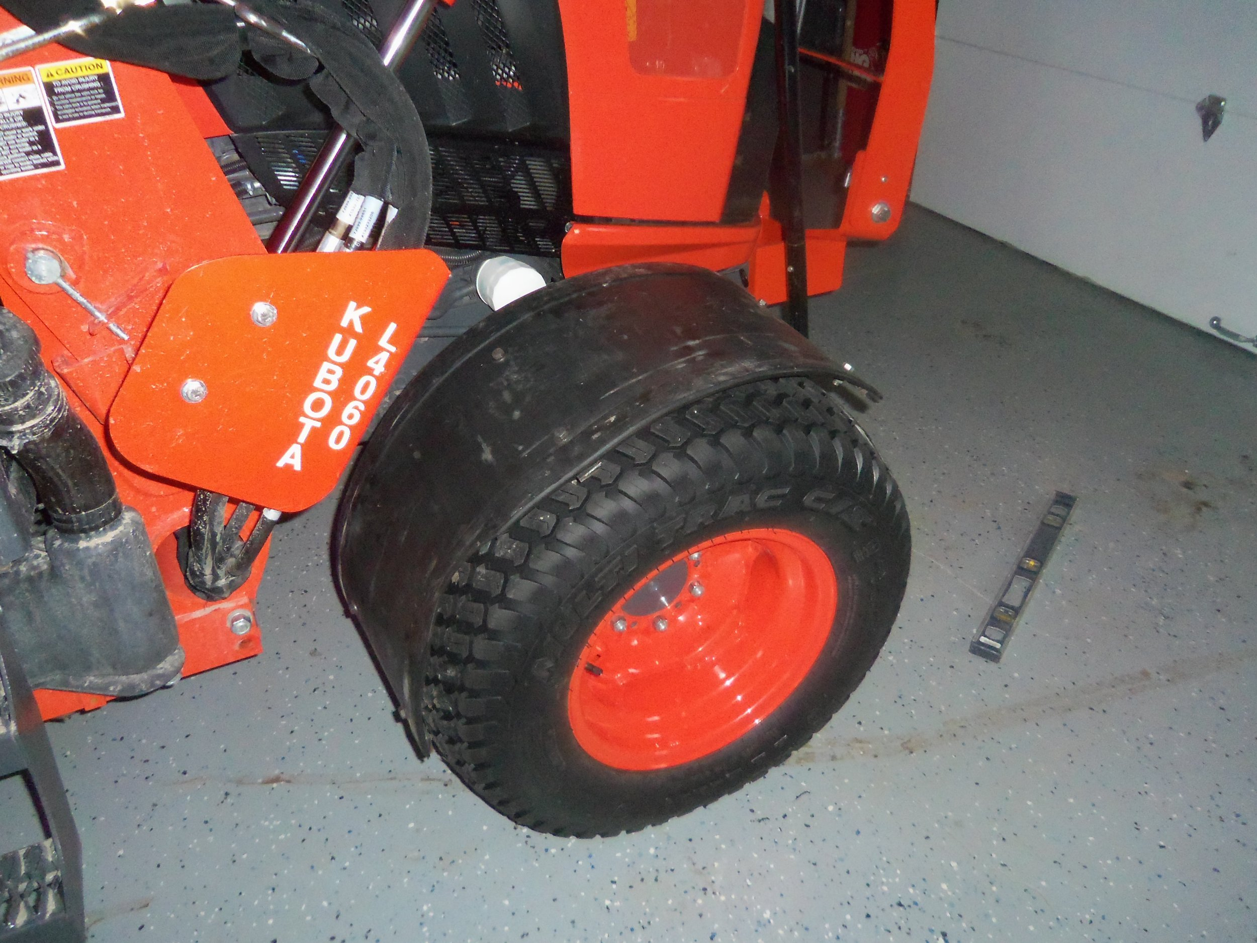

Thanks. They are well built and very strong. Not cheap though.

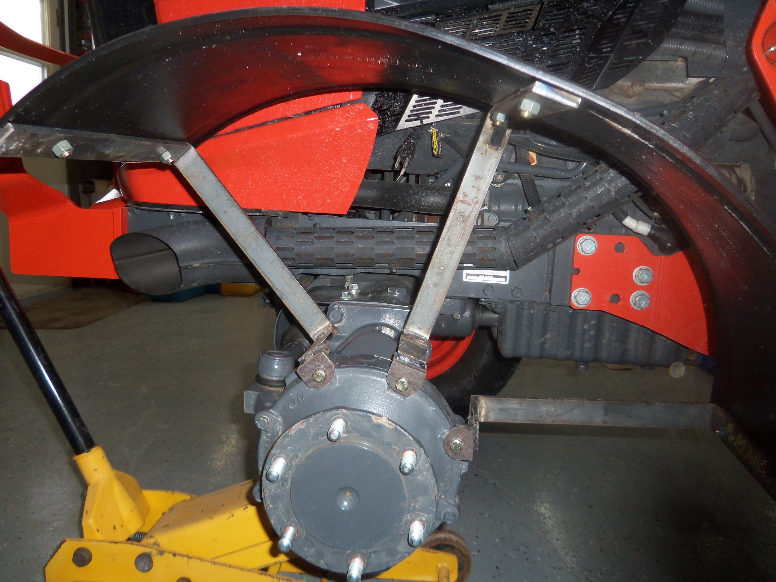

Welcome. Wish I could find one with the wheel off. If your in no rush the next tine I bring the tractor in the shop I can pull the wheel and snap a photo. Yes there's room for chains. Just trim the lower bolts under the plastic portion of the fender. Incidentally your USA 5740's Axel is the same as the Canadian model. The only difference with the Canadian version of the 5740 is higher output alternator, rear cab lights, rear wiper and rear defrost on three windows are standard equipment on the unit and are not considered an option.
It will probably be a while before I order, so please do post a photo if you have time. Not a big deal if you don't. The stack of brackets on yours is impressive, looks like the intention was to totally avoid anything that could get pushed into a tire, etc.
   / Kubota front fenders #32
Will do. I usually build my own stuff like this but was more than impressed with its quality and I'm happy I bought them.
   / Kubota front fenders #33
Yeah, I started to ask if you had built them, then reread your post. I thought they were too well thought out to be factory. :)

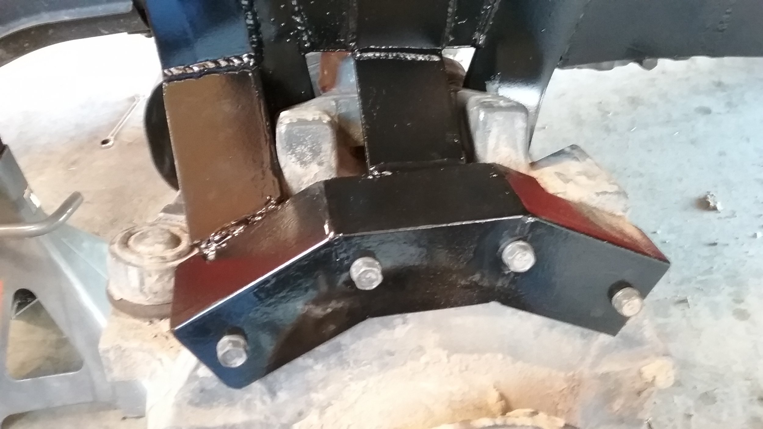

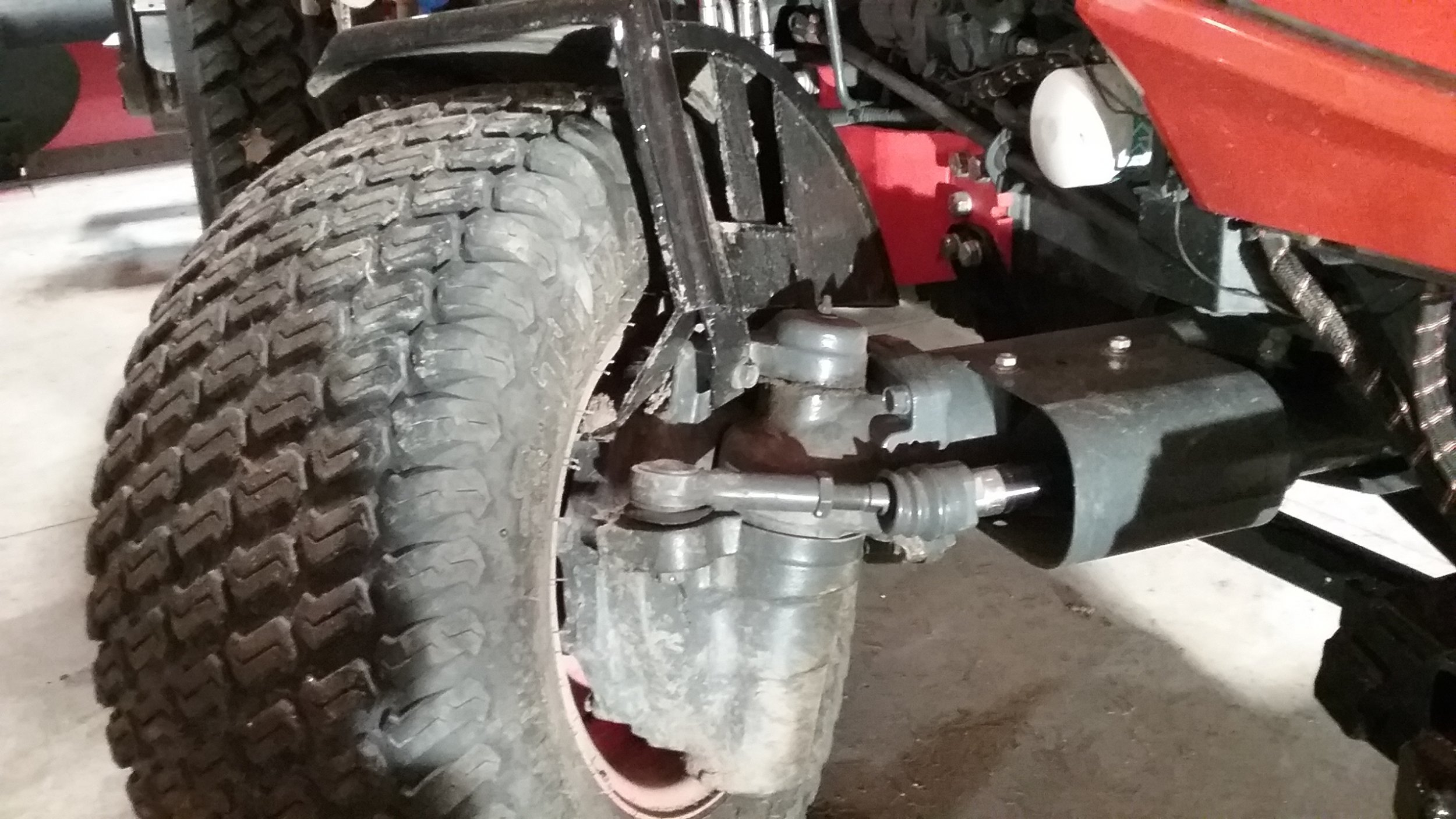

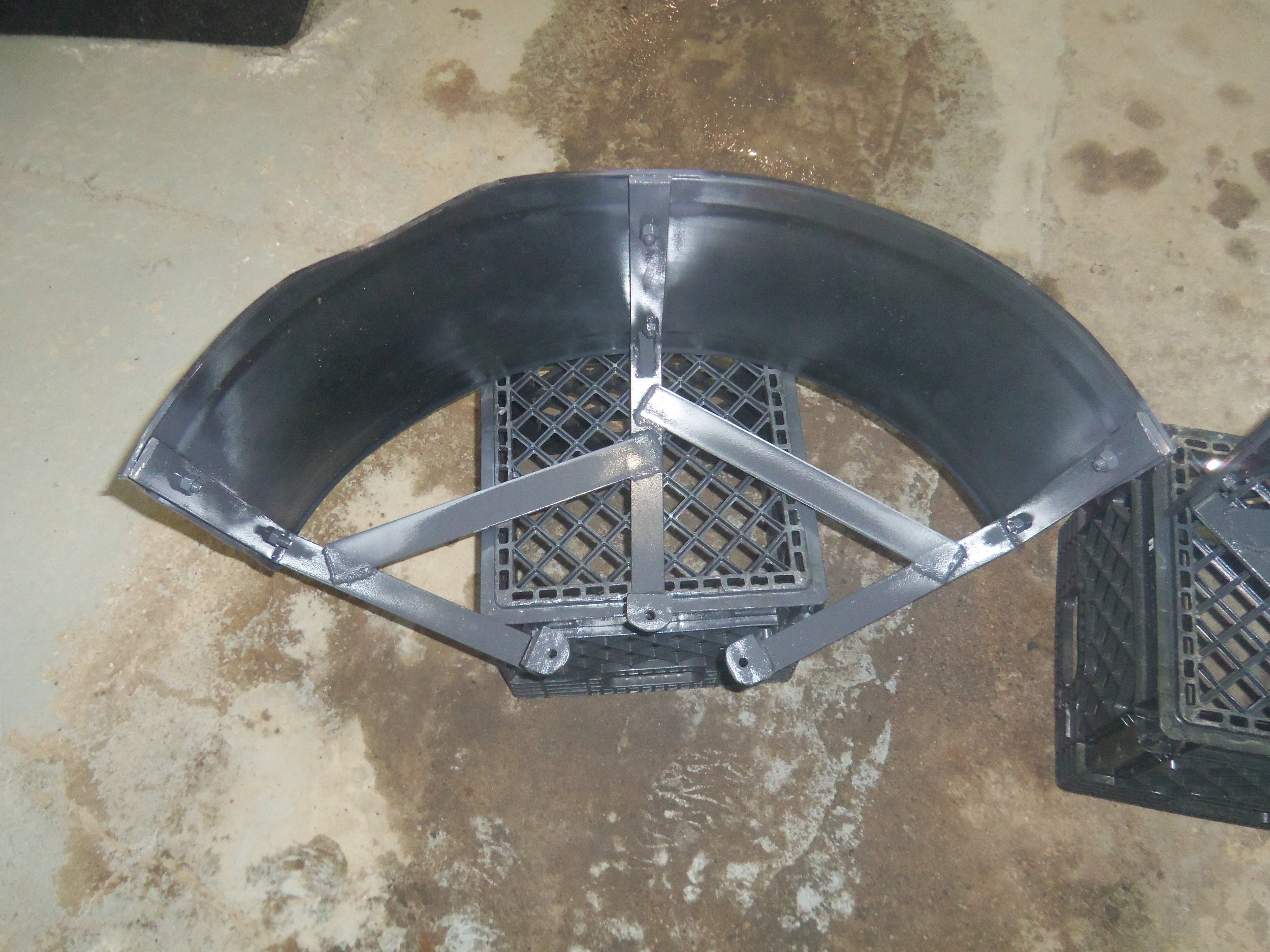

well that was a fun to do came out ok
   / Kubota front fenders #40
You may want to consider running some supports to the top bearing bolts. Any small amount of flex will allow them to fatigue and crack very quickly. even though I can stand on mine at 200lbs, i still had to repair a few small cracks after 4 years of commercial use.
